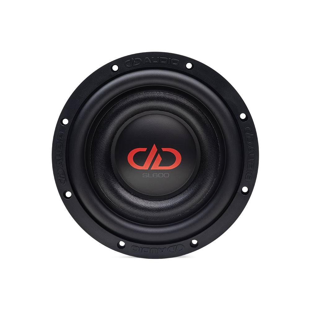

Regarding the sub, if 8 is it, it's doable, and there are some really stellar units that I am familiar with, but I cannot say firsthand anything about that Orion driver, as I've not used or heard the Orion sub.
Rap and Rock are not the ultimate keepers of low-end reproduction; that would fall to orchestral music. I'm not including rebassed music (it doesn't count).
Keep in mind that a standard bass guitar is lowest at around 41 Hz, while the contrabassoon hits down to 27 Hz, and the pipe organ reaches into the lowest register, the infrabass (infrasonic) frequencies, to around 16hz.

Here are a couple that come to mind:
This is till my favorite shallow sub, along with one other. The DD Audio is purpose-built for small, shallow installations, and it's truly one that approaches/matches the performance of its bigger, full-depth siblings.
Audiofrog
Helix Ci5
PRV
American BASS
As for amplification, gonna spring one on you that is pretty amazing in all aspects:
That amp will handle the entire front stage as well as a set of coaxials or full-range drivers for the rear.
Grab one of these little 6"x 6" x 2" marvels, run it at 4 ohms, give you a plethora of power to play with up or down, attenuate to taste or need.
Or, one of these for subwoofer duty.
Or one of these:
Or one of these:
On any of those AudioIntensity amp deals, load them into the cart, and the price on some is lower when loaded into the cart.
The sub amp will be contingent on the need and the power available at the spec'd wired load, preferably, a 4 ohms load on a higher-wattage 1-ohm-rated amp at 4 ohms works better than a lower wattage amp running at 1 ohm.
