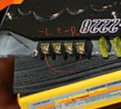

It's no secret that I'm a fn idiot to this stuff but that's OK bc that's why y'all are here. I'm taking your guys advice. I'm just trying to understand what can be done with an Amp. I am going to bridge the 12 in the meantime. Assuming this is how I do it? Photo attached!! What can be wire in to the middle terminals??

should be a line that says bridged between 2 of them just do that to the pioneer until u get better amp forget the 8..

Yes. Don't wire anything to the middle terminals.
