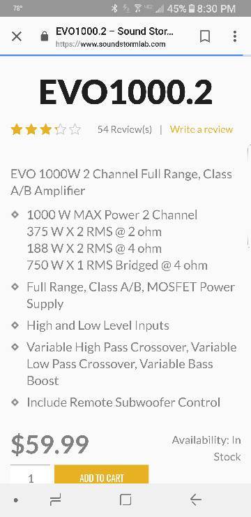

Evo 1000.2 amp. What could this amp do for me, compared to what I already have? Is it good?

i never heard of it and doubt it's be much of improvement over what u got.. get what u got set up some and look at amps above $100 unless u find good used 1 guy here has that jbl didn't he offer to u? that'll kill anything u find under $150. if u get that u can then run the 4 channel amp to all your other speakers..
