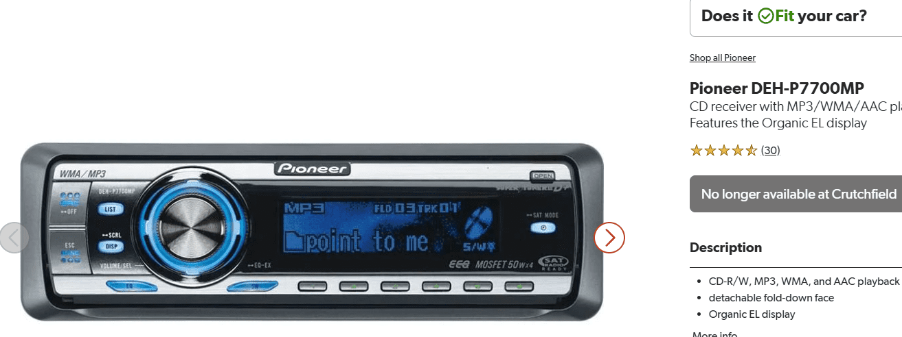

That model # shows a completely different unit on the US Crutchfield site.
Does yours have any low-level outputs? You might have a cooked amp, but a unit that could still work with an outboard amp.

thanks for the reply. yeah, thats also weird to me. i belive its the same unit that had different face plates. on mine it says deh-p7700mp on the body itself and the faceplate. ive tried a faceplate from deh-p6900ib i also have. the screen didnt come on but the volume worked, and you can skip to previous tracks when cd is played. some other buttons also made a beep sound but dont know what they did since the screen was dark. so thats some progress. the remote also didnt work on the 7700 plate. so im 90% sure its the front pannel
its this one:
the circuit boards inside are the correct ones. (of the main board and other components i looked at) if you still need a pic of the back let me know
