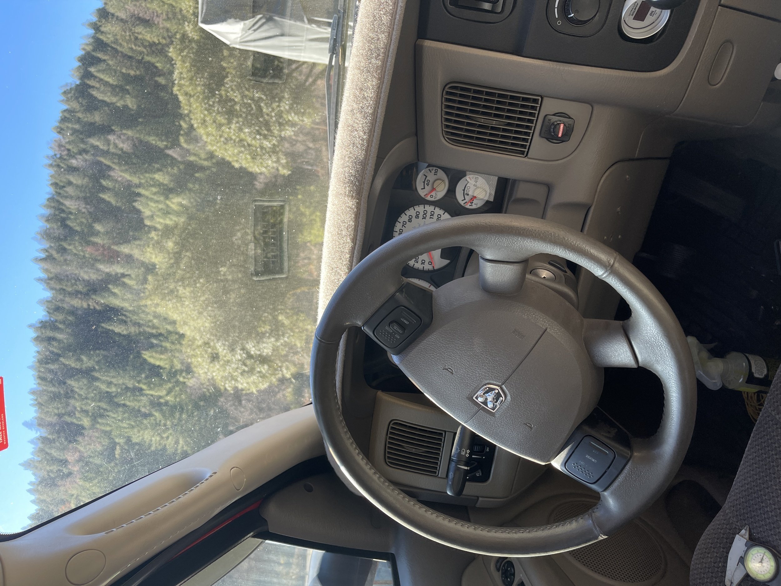

Also, there are three additional location for speakers, but not sure if they’re worth utilizing. They are two 3.5” and a 2.5”, all in the dash shooting to at the windshield.

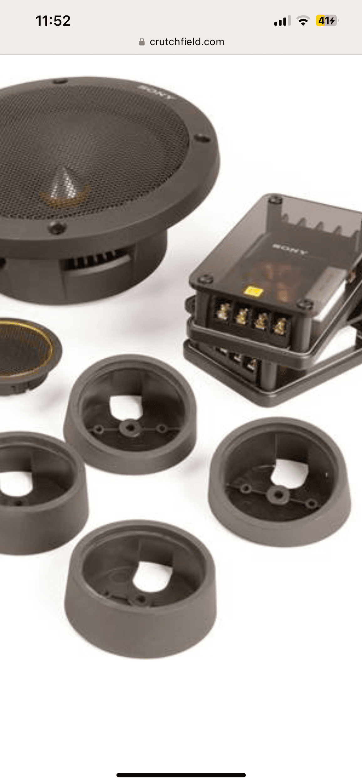

https://www.crutchfield.com/p_158XS162ES/Sony-XS-162ES.html
https://www.crutchfield.com/p_158XS160ES/Sony-XS-160ES.html

Generally speaking you can fit ~3" deep speakers in most cars if you use a spacer. I always take the door apart and take measurements before buying.
I don't like the look of those Sony dome tweeters - they appear to be semi-horn loaded, which restricts dispersion. If you plan on listening on-axis, then it's not an issue, but off-axis it will (probably) affect frequency response.

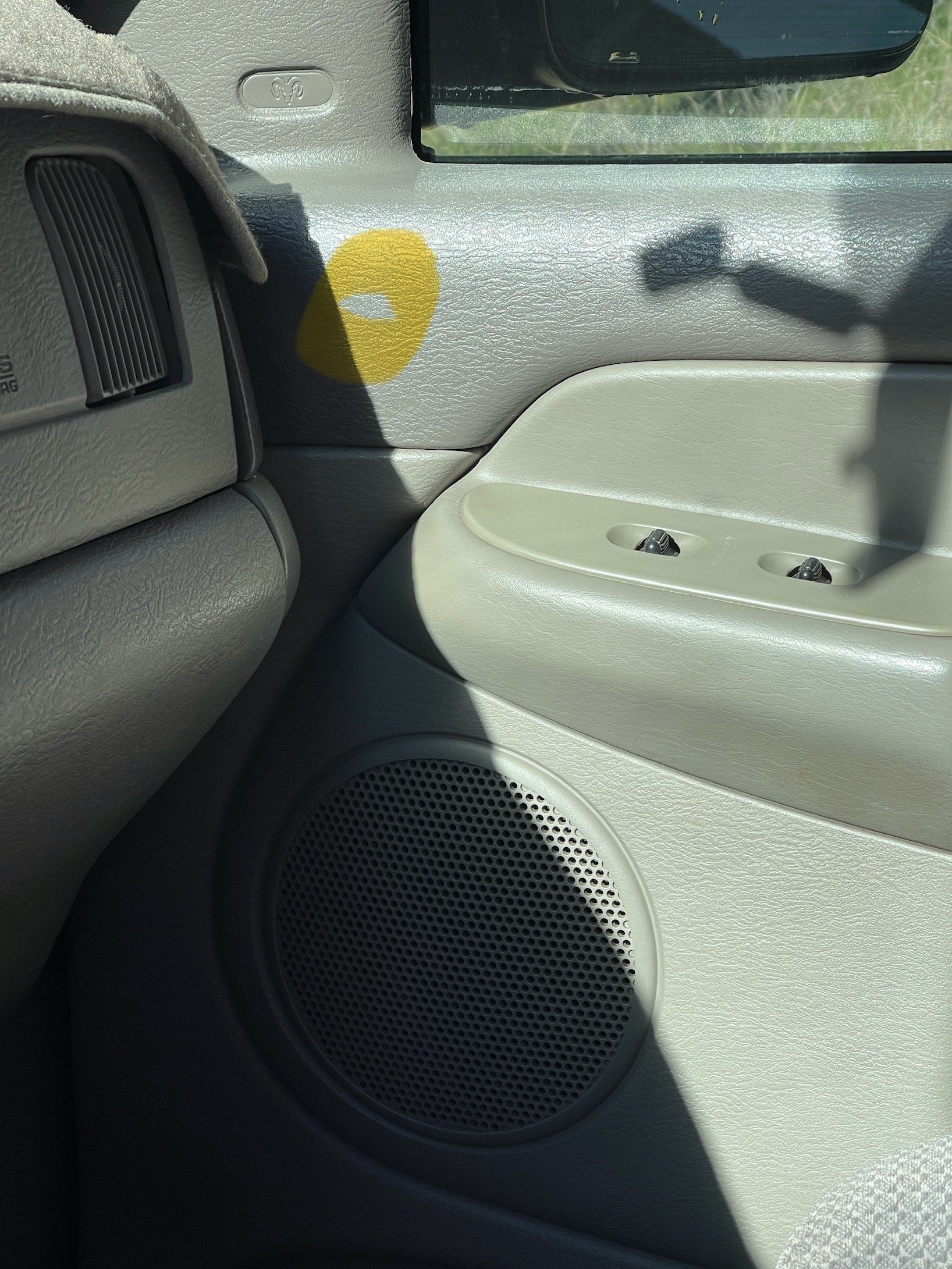

I took the door apart and I have a decent spot to aim the tweeter of the components at the driver and passenger just below the sail. I’d put them in the sail itself, but it’s obscured by the dash on the driver’s side…
I'd probably go sail panels or a-pillar - higher is better. You'll have to aim the tweeters toward the listeners, not the opposite door.

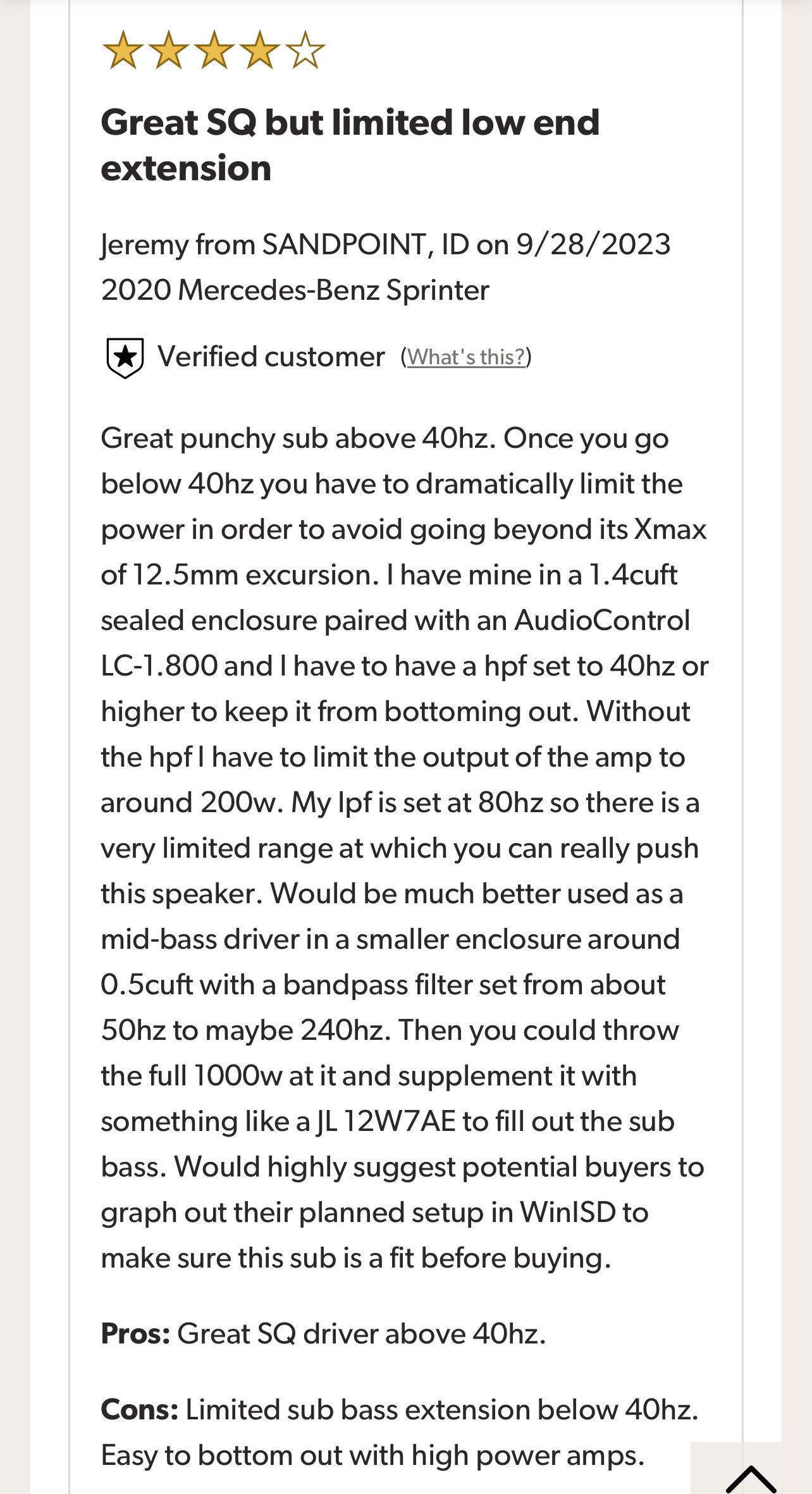

I was looking at the Sony ES 10 and 12” woofers. Why does the 10 need more airspace? The designs look identical and the 12 takes more power…
Second, is there a benefit to isolating the subs from each other, or should they share the airspace? If building a box for two, do you simply double airspace requirements of one, or does it need more or less?

Specs indicate that the 10 should have a much smaller enclosure. Sealed, I'd go ~.5cuft for the 10 and ~1-1.5cuft for the 12. The ES subs have very limited throw, so don't expect them to get loud. Personally, I'd look at the Dayton Reference of the ES subs - they sound great, aren't very deep and have more throw.
