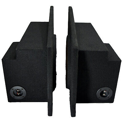

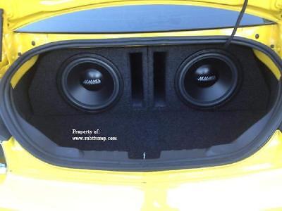

Fortunately, there are many prefab options for that year Camaro, like these.
That said, need the end goal and most importantly, the build budget and end goal.
