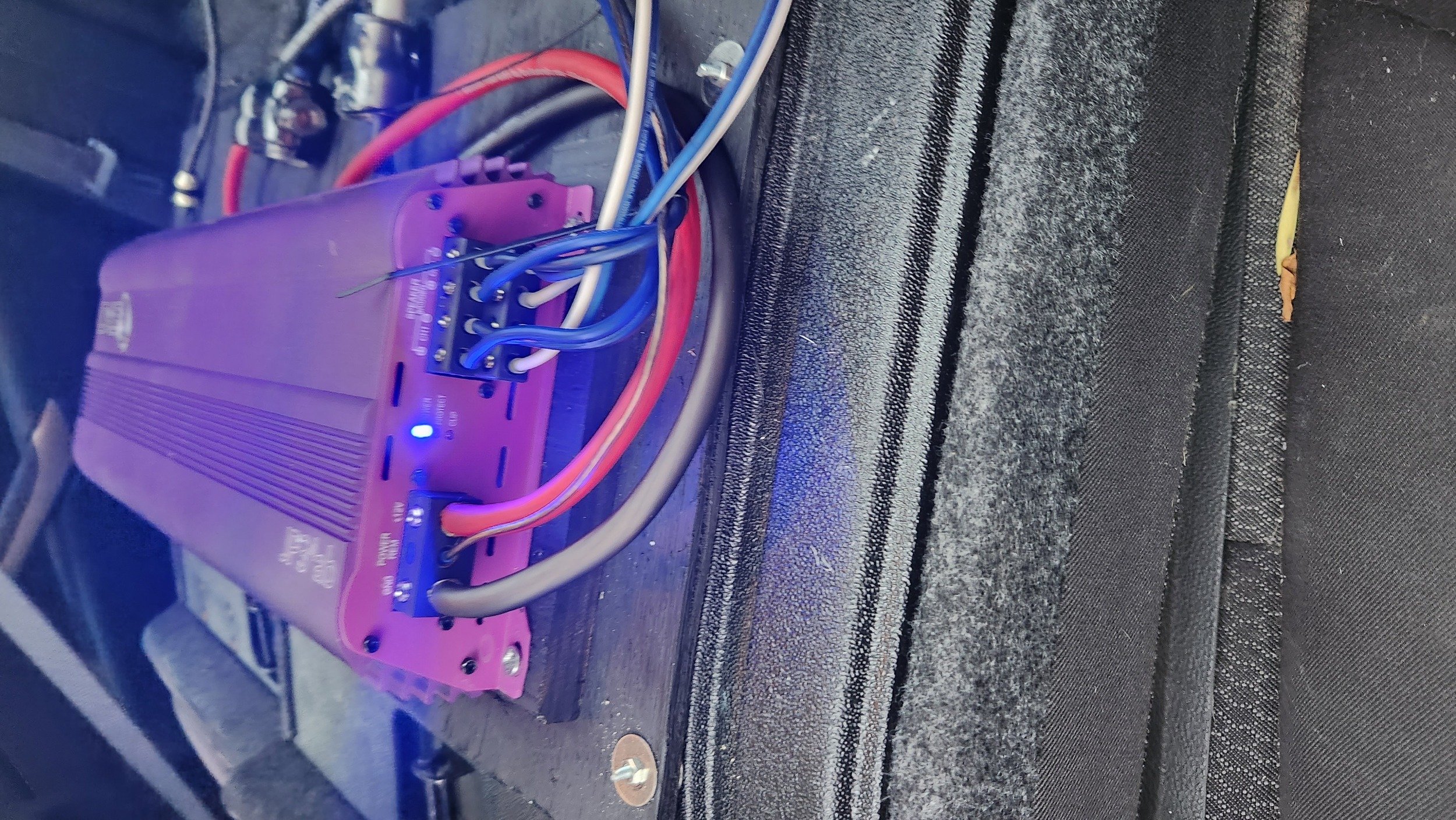

Ill try to recommend what Ive done myself that works and has worked to keep others from dealing with the issues Ive had and obstacles. Car Audio can get expensive, just as everything has these days from buying food to feed the family or even oneself,gas prices and general bills. That little bit of insurance of putting in a fan to help keep that amp running cooler will also help with it lasting a bit longer too. Those are easy to install on a flat surface as you have here. They dont blow or move 100+ CFM but enough to serve its purpose. These have actual bearing in them and Stainles steel blades
Amazon product ASIN B0059BCWGU
They used to be like $20 bucks and i picked up like 12 of them at one time, They have lasted a long time,never had any issues with them

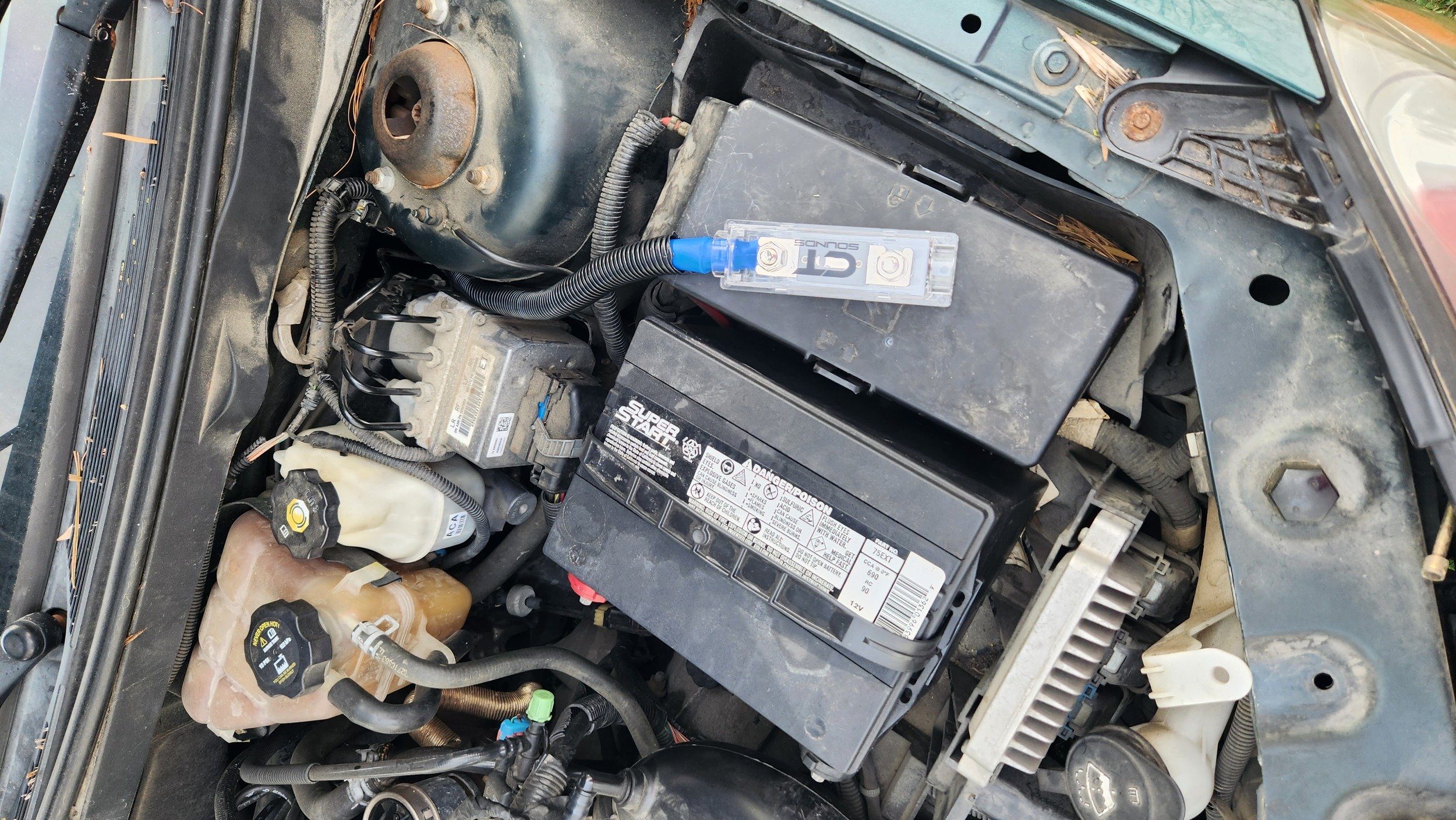

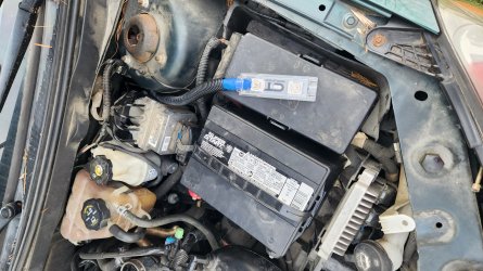

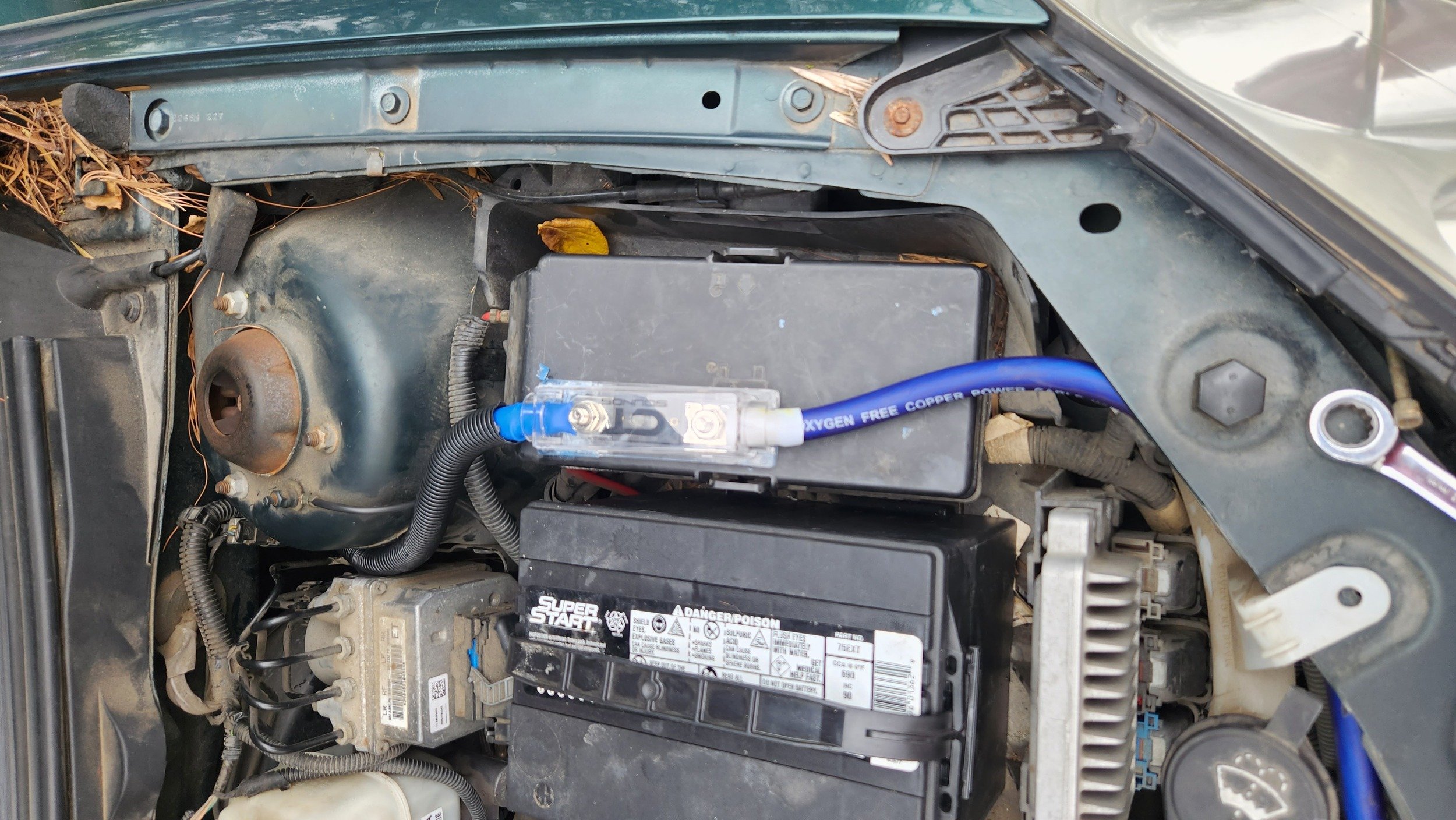

Any thoughts on where to mount this?
#1-You can actually ZipTie it on the top or side of the batteries carry handle, I would do both sides where the wire is just before the fuse is best with the fuse holder sitting along the handle near positive location.
#2/If you have enough wiring left to reach the battery. I would screw it on that plastic housing sideways by the fender and behind that fuse panel
