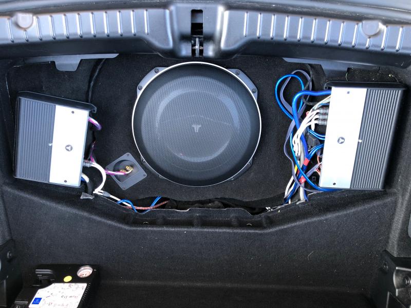

Meanwhile... this guy installed a sealed JL 13.5" in his trunk and said it sounds phenomenal. There's a factory cover that goes right over top of this and you'd never know it was there. That may end up working better than a false floor with plexi windows :)

You claim you want to spend 3-400 then post a picture of like 2 grand in gear alone. That sub is 599 alone.
Can it be done yea but your gon a struggle with such low budget. I would be looking at doing a custom box on the passenger side foot well with a shallow sub either the hertz or and alpine. But those are expensive.

I was posting to show the install, not the price of the gear. The space is there, so that's good. And yes that JL is much more powerful than the baseline XTR setup I'm considering.
I'm planning on measuring the space in the passenger footwell to see if I can consider a Fosgate P300-12, a Fosgate P300-10 (or their "truck" variants... these would have to be mounted upside down) or even a Kicker HS10 or Cerwin Vega VPAS12. It would just come down to how much space I would lose, but a sub in the cabin would definitely sound better and the all-in-ones are more compact and cost efficient overall.
