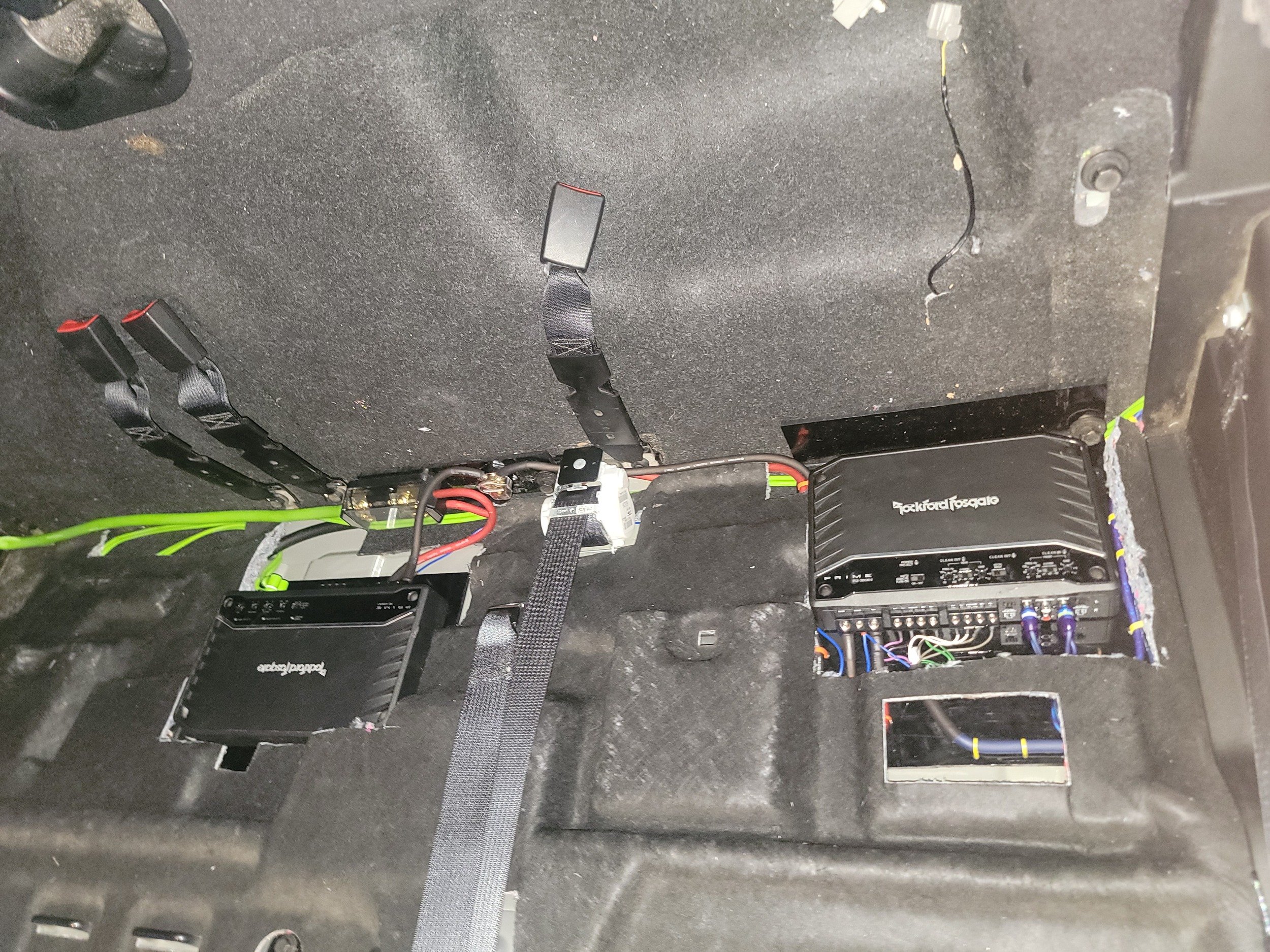

I have a '17 ram and I run 2 amps. For the fronts I have kenwood 6x9 woofers in the doors and their 3.5 coax in the dash. Rear fill is alpine 6x9's. Fronts are running at 2 ohm off the rf prime 300x4 and the rears are 4 ohm off the back channels of that amp. Subs are 2-10" Sundown SA Classics running at 1 ohm off a RF Prime 1200x1 in the 2x12 fox box. Amps are on the rear wall behind the seat. Even pushing them they don't get super hot.
I have a '17 ram and I run 2 amps. For the fronts I have kenwood 6x9 woofers in the doors and their 3.5 coax in the dash. Rear fill is alpine 6x9's. Fronts are running at 2 ohm off the rf prime 300x4 and the rears are 4 ohm off the back channels of that amp. Subs are 2-10" Sundown SA Classics running at 1 ohm off a RF Prime 1200x1 in the 2x12 fox box. Amps are on the rear wall behind the seat. Even pushing them they don't get super hot. View attachment 49460
Looks damn good and never thought about running my front stage @ 2ohm
So how did you wire them? I have 4Ω in the dash and the door and plan on picking up the wiring for them behind the HU. (run a 9wire back up front from the amp)
That's exactly what I did. Ran 6x9 and 3.5 parallel for each front side to the front 2 channels. Unless there's a resistor somewhere in the factory wiring that's a 2 ohm load per side. The door and dash are on the same set of wires in my truck.

Forgot to mention, I did not meter the final load on the front chan els at the amp. I just assume it's 2 ohm!!!
