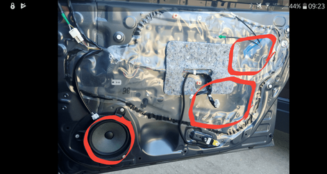

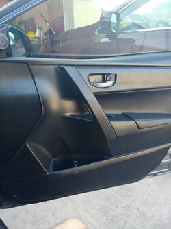

I took the time today to do some recon. Figured out how much space I have to work and did some measuring
Pic below
^^^ Passenger door panel
^^^ Door panel off
^^^ My available openings
^^^ Hole in the water barrier right over the woofer
^^^ Inside of the door panel. Unfortunately, there were not many obvious moving pieces where I thought the main rattle was.... It will be a hunt!

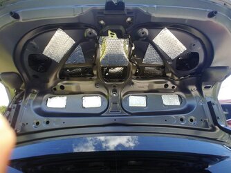

I am ordering some deadener today. I will be using Noico. Probably 72sqft to start. That will be more than enough for the doors and trunk then I can see how much I need to order for the floor and possibly roof in phase 2.

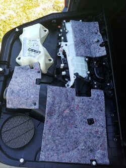

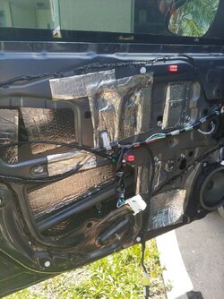

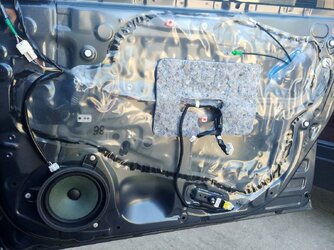

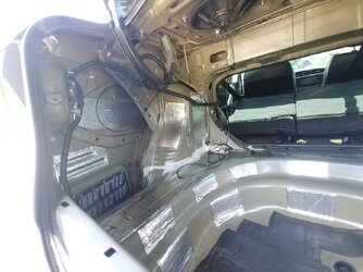

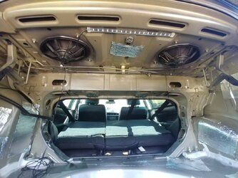

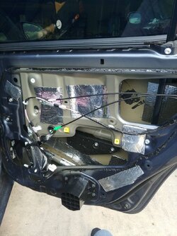

Starting the first phase today. Deadener and basic door treatment. Pics of the deadening at the end of the day.

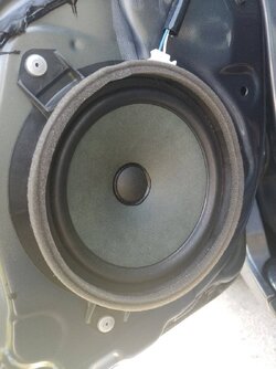

Question for now. My speakers are riveted in. I am confident I can take them out... But what do I replace the rivets with? I can't get my hand back there for a screw and nut... I bought some foam and would love to get it back there behing the speaker. Plus, a lot of bare metal is back there asking to be deadened.

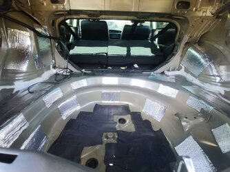

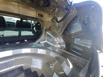

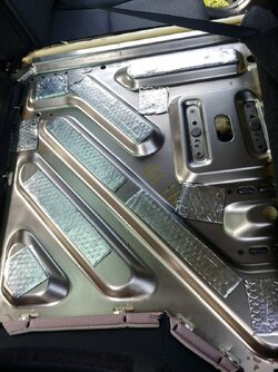

Back doors and back of seats done today.

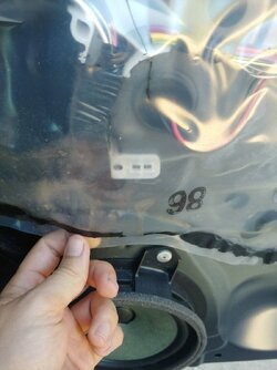

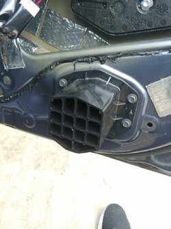

Anyone know what the black piece is for in the second pic? My guess is just stabilization of the plastic.
