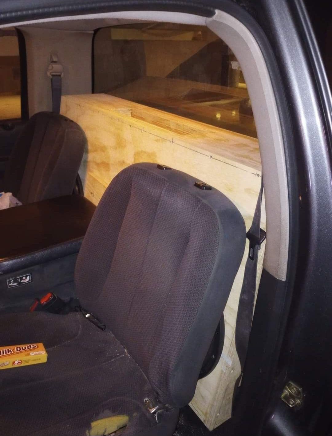

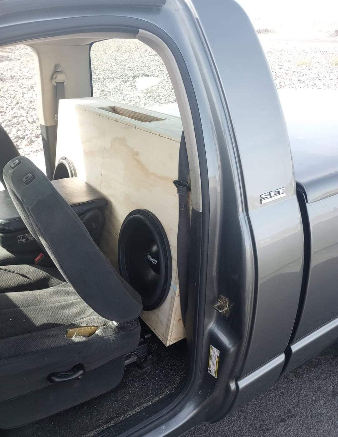

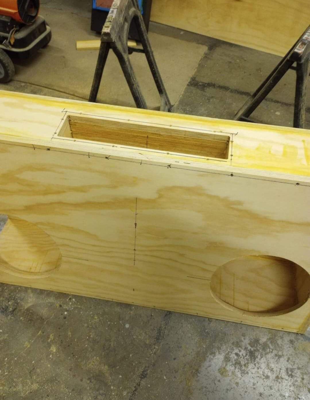

I tried to install two 15's behind the seat of my 2005 Dodge. I had more than enough mounting depth. However, we tried to build the box on the smaller side and it didn't work out too well. It peaked too high for my liking. We installed two U15 v2's on an SIA5000. It did do a 148 on the meter @ 37 hz. I probably could've got it to a 150. It just wasn't worth it. My box builder screwed up the driver's side cutout and the box kept breaking screws and spitting the sub out when I turned it up. I'm going to put a new baffle on it and switch to two twelves. I'll attach pics if anybody is interested.

The Sundown U series subs that I used have about a 9" mounting depth. I'm 5' 11" tall and still sit comfortably. I did move my driver's seat two clicks forward.

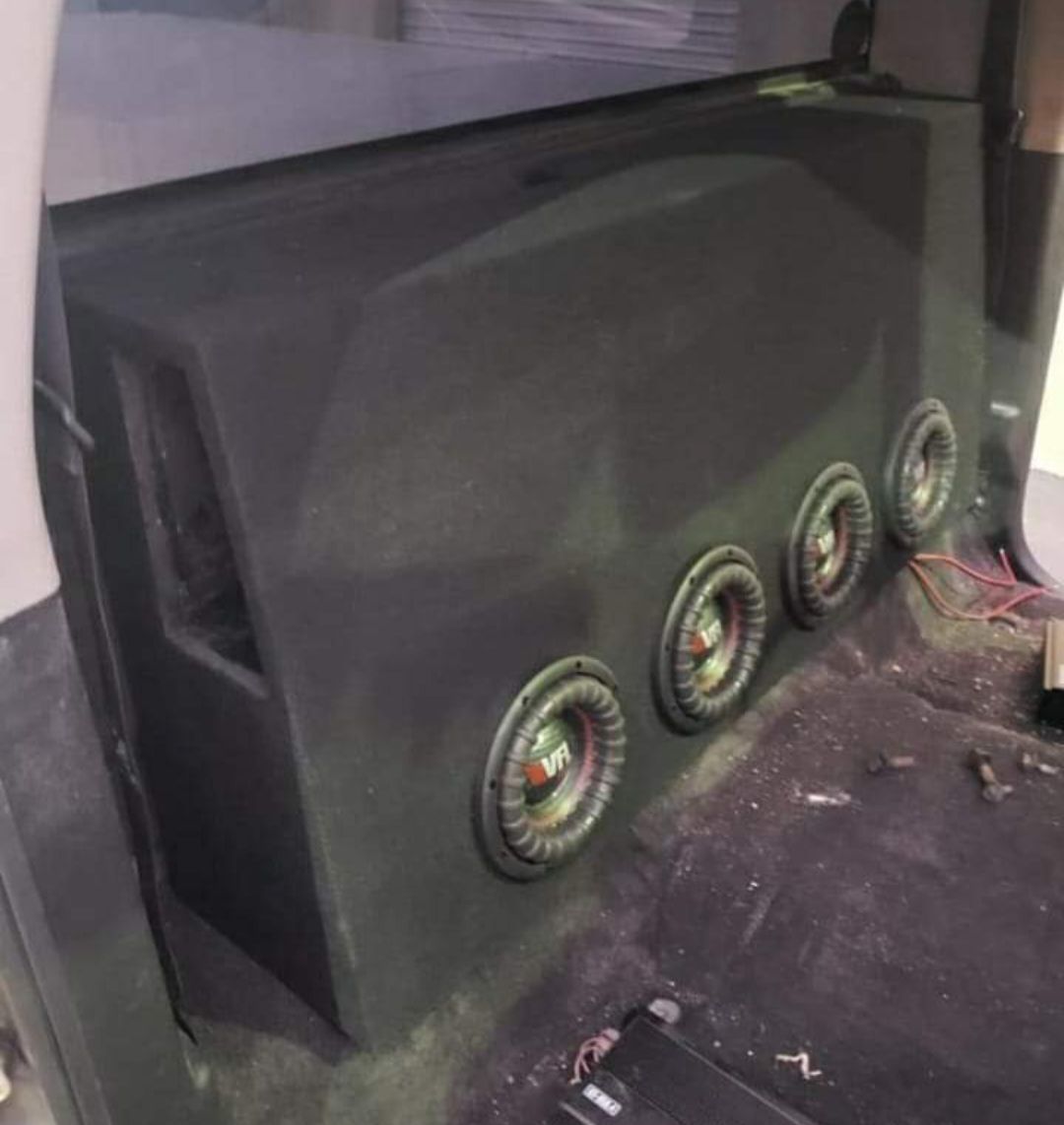

My 2 - 15" wedge box is around 5 cubes net with 80 square inches of port. My 4 - 8" wedge box is 3.69 cubes net with 43¾" square inches of port.
