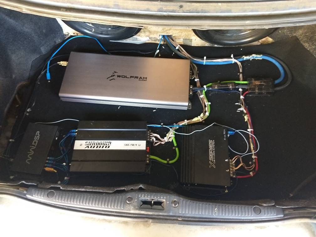

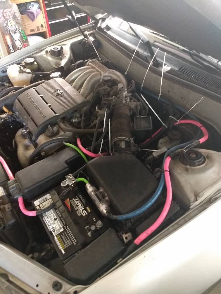

Added a 2nd run of 2/0. Needed a rewire for the wolfram 3k to fit and jumping to full anl fuses.
Curious. What size fuses should i be going with. Alt is 250 at full tilt plus a lil more amps for the battery. So 300?
Also i have a 3in 4awg run on the bat terminal between the 2/0 fuse and the bat terminal. I know wire thickness is dependent on length so i assume i should be fine. 2/0 welding wire just doesn't like that short piece 90 degree turn.
