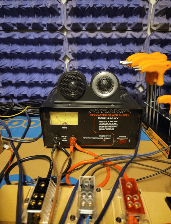

Double Tweeter Bracket
I've purchased from that guy, wasn't too long, around two weeks delivery not bad. I also had some 1L pods printed for my Karma Aspect 3's. Stuffed them with Reonix fiber matt and they now can play down to 250-300 hz at rated power which one can only really do if the correct sealed environment is observed.
They came with 4 different mounting options too.
Very Nice!! Options for mounting and adjustment is a must for location/location. LOL.. Sweet!!. Ill get my A-Pillars done up this next year the way Ive always wanted rather than dash mounted and A-Pillar tweets
Ive looked at all kinds of gauge pods myself. Limited on the sizing needed, but do-able for some
Yeah, stumbled upon them and they are almost a perfect match for half a dozen tweeters on the market. If nothing else, a good starter if you want to custom glass your own from.
The swivels really are nice, I see you have them also , and give you so many more tuning options.
I'm taking them off the midrange pods as they aren't needed. I have a set for the tweeters that are much more important but not installed in the pictures.

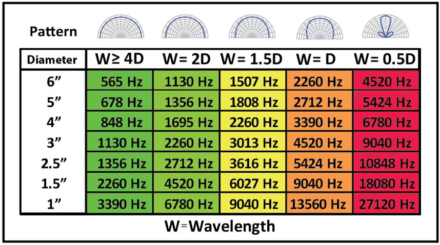

Sound becomes directional based frequency and cone diameter so if you can keep each speaker in it's given range not too much worry. But tweeters you can't really do that with.
I kept my 6.5s low passed at 450hz, 3.5s at 2500hz and the tweeters play 2500hz and up so they become directional at 9000hz and become more directional the higher the frequency. But this is un avoidable.
