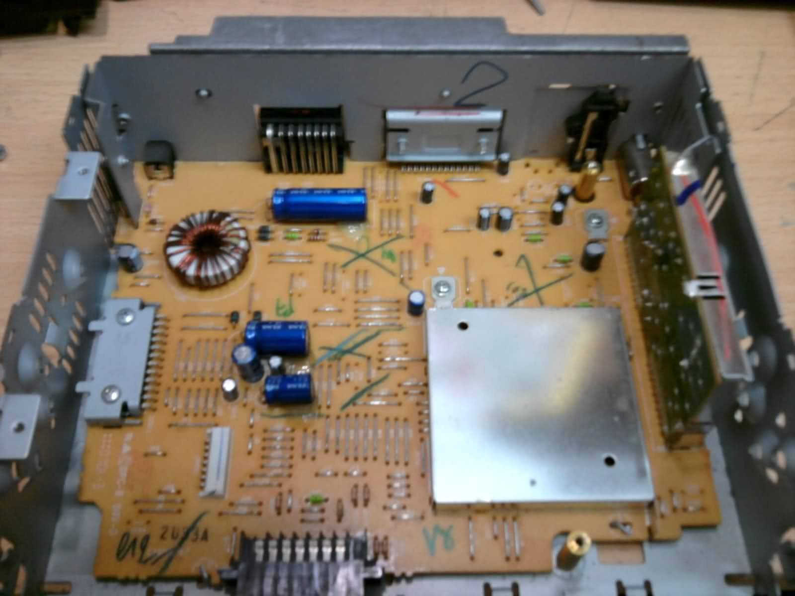

I've got the same thing going here guys/gals, I've got a Pioneer Premier DEH-P500UB H/U my sweet girl got it for me on my birthday, its a sweet deck.
Had it for almost 2 yrs now, warranty is almost up, and one day, it started whining after an install..Like most of you out there, I grounded and regrounded everything, removed paint, drilled new holes, even up graded Cables..Nothing seemed to work. hell I even isoliated the whole H/U...Now i more or less stumbled a crossed this thread, and I have to hand it to you guys, I freaking worked. I had every kind of buzz, whine, thump, pop, you could think of. Now Its as quiet as a sleeping baby.
Took some remote wire I had around, and grounded my RCAs, and I grounded the deck straight to the batt. Perfecto!!!!!

ok so I tried this fix on my deck but ran into a problem. My RCA's arnt hard mounted into the deck, they have a length of cord coming out of the back of the deck. Is there away to ground these or am I S.O.L.?

  • Grounding the RCA's on the head unit
    Many have had problems with Pioneer head units because of a poor internal RCA ground. To remedy this, simply wrap wire around the RCA's and screw the wire down to the head unit's chassis like so:
    Thanks to Ultimate157 for the image.
    To view his thread on this subject, click here.
