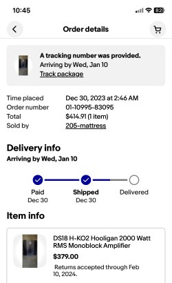

Ok, so I’ve got the 10w7 and the red eye box and I just ordered this amp below. I would like to use the factory head unit only because I like the way it looks and operates with the screen that goes up and down with my display for for everything and navigation. I’d like to swap out the factory speakers in the car as well and order everything I would need for a quality installation. I’m a complete newbie to this stuff. I’m 38 y/o and had a nice system in my 2nd car and once had a jl stealth box under my seats of a truck and just miss a great sounding system. I’d like to do the rest (door speakers, rears, fronts, wiring and cables) on a budget where I either buy something of great quality pre-owned or refurbished. I don’t want junk but don’t want junk.

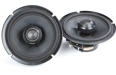

Get 4 ohm drivers that will not play very loud with the Bose amplifier. it appears that both 5.25" and 6.5" should fit. These are a great buy right now and you could put the midbass in your doors, teh tweets in the dash. At $99, they are about $150 off regular. Heck, get 2 pair and install the comps in the rear too. I ordered a pair for my garage!
This is the tweeter set, pretty versatile installation options. Could go surface in the rear, dash mount in the front. Since you're going to replace the amplifier, get what you like. It just won;t play very loud until you replace the amplifier.

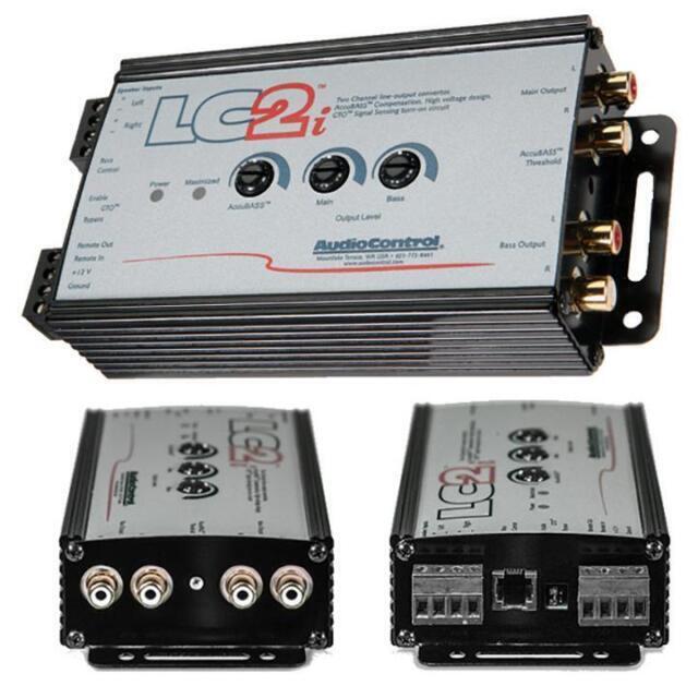

You'll need wiring for installation and things like distro blocks, a line out converter (which you'll need either way.

How does that converter compare to this one?

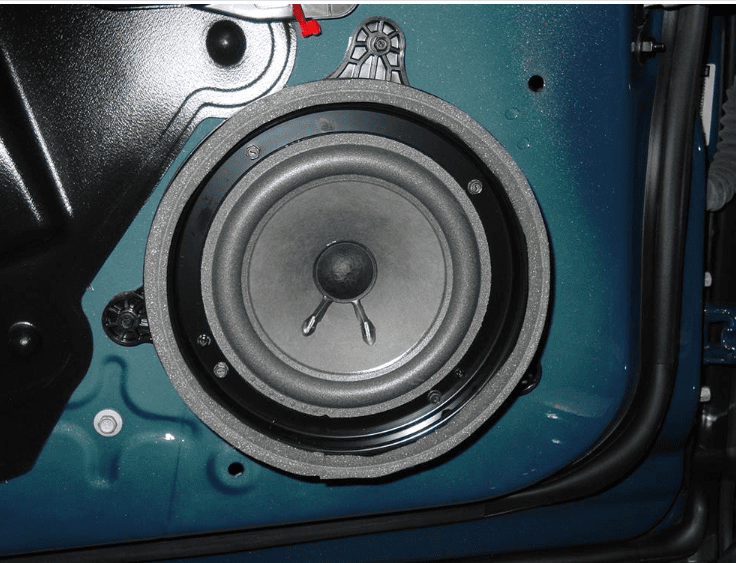

I just ordered 2 sets of those speakers you sent me the link to. What a great deal. Crutchfield did say they won’t fit though…are they wrong?
This is what they show.
A .5" to .75" riser will surely work.
The difficulty in putting in new speakers will not be getting them in, it will be getting the Bose drivers out. They are riveted in from the rear of the door panel. Once you get them removed, you can install a riser that should allow you to put any 6.5" - 6.75" driver in there. the Pio's come with nice grills should you elect to mount them on the outside of the door panel too.
