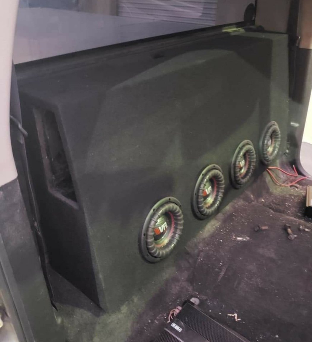

You numbers look good. These are mine. I metered with the door open and the meter in the passenger kick.
I got the Term Lab out tonight and finally did some testing at different frequencies just for fun and to find my peak. I came close but just couldn't break 149. I'm pretty happy with the scores. 4-8's on a SIA3500. Here are the results. So, I guess my peak is 31 hz. 2005 Didge Standard cab.

Those numbers are crazy for 4 8's with less than 4k watts. I wonder what the difference would be for me to move the meter to the kick plate.

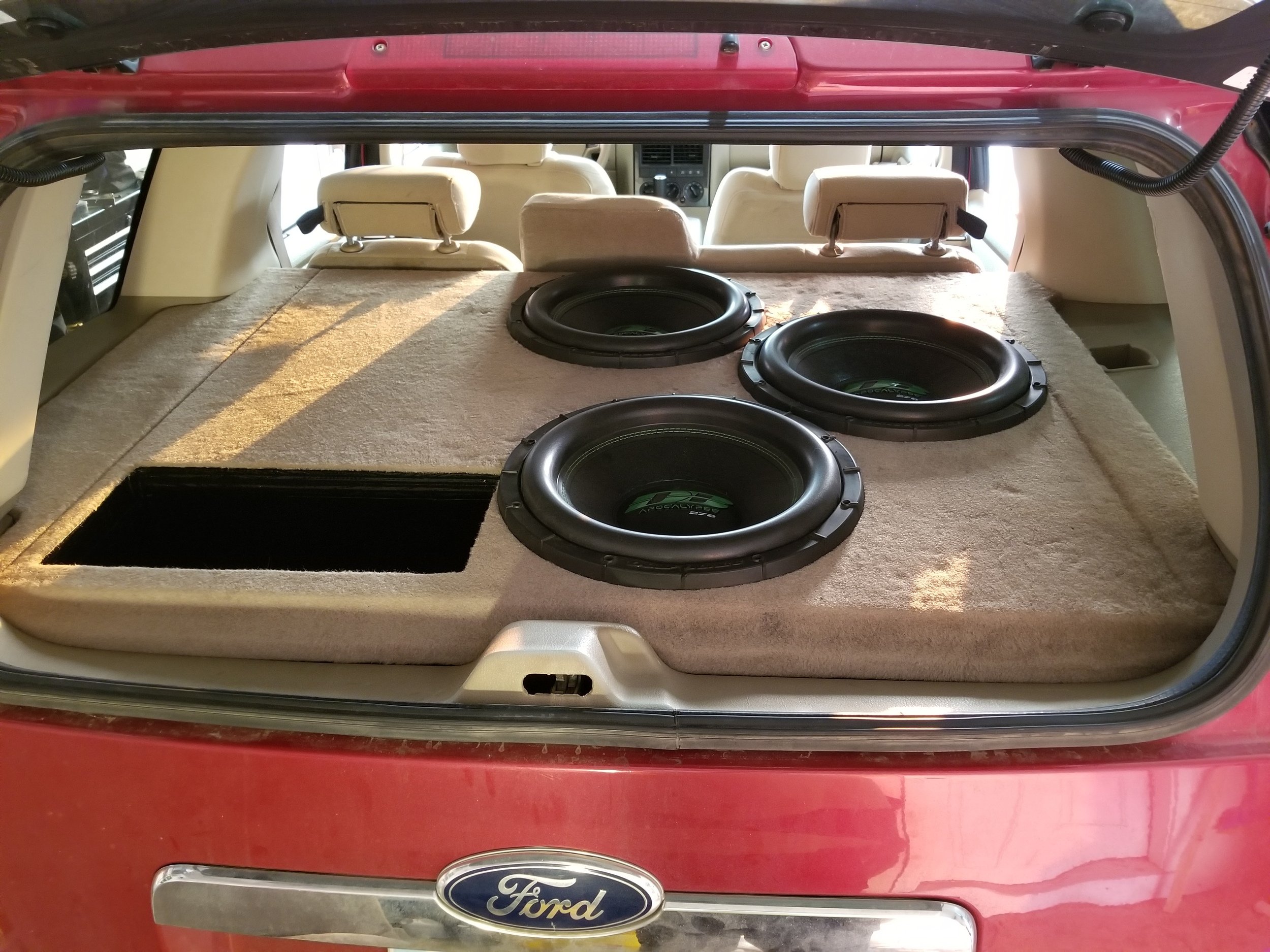

Okay so I just measured the box.
Outside dimensions
45" wide 22.25" tall (including triple baffle) 50 inches deep
Port is 43.5 x 6.75
I built this box in February of 2019 and don't remember the port length but it has 3 corners. Perhaps around 25 to 27 inches?
My subs are currently inverted so no sub displacement but I miss being able to see out my rear glass. So a wall is not really ideal.
Ps @Buck I'm a big fan of your work.

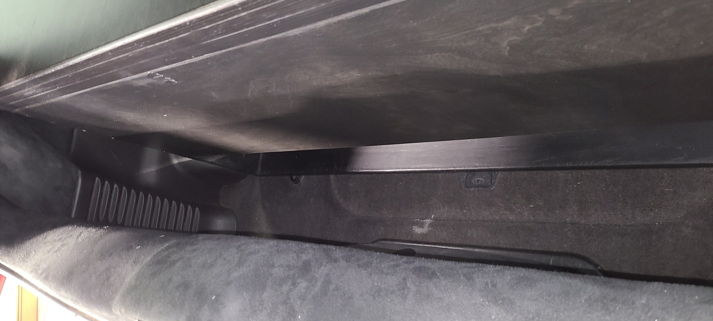

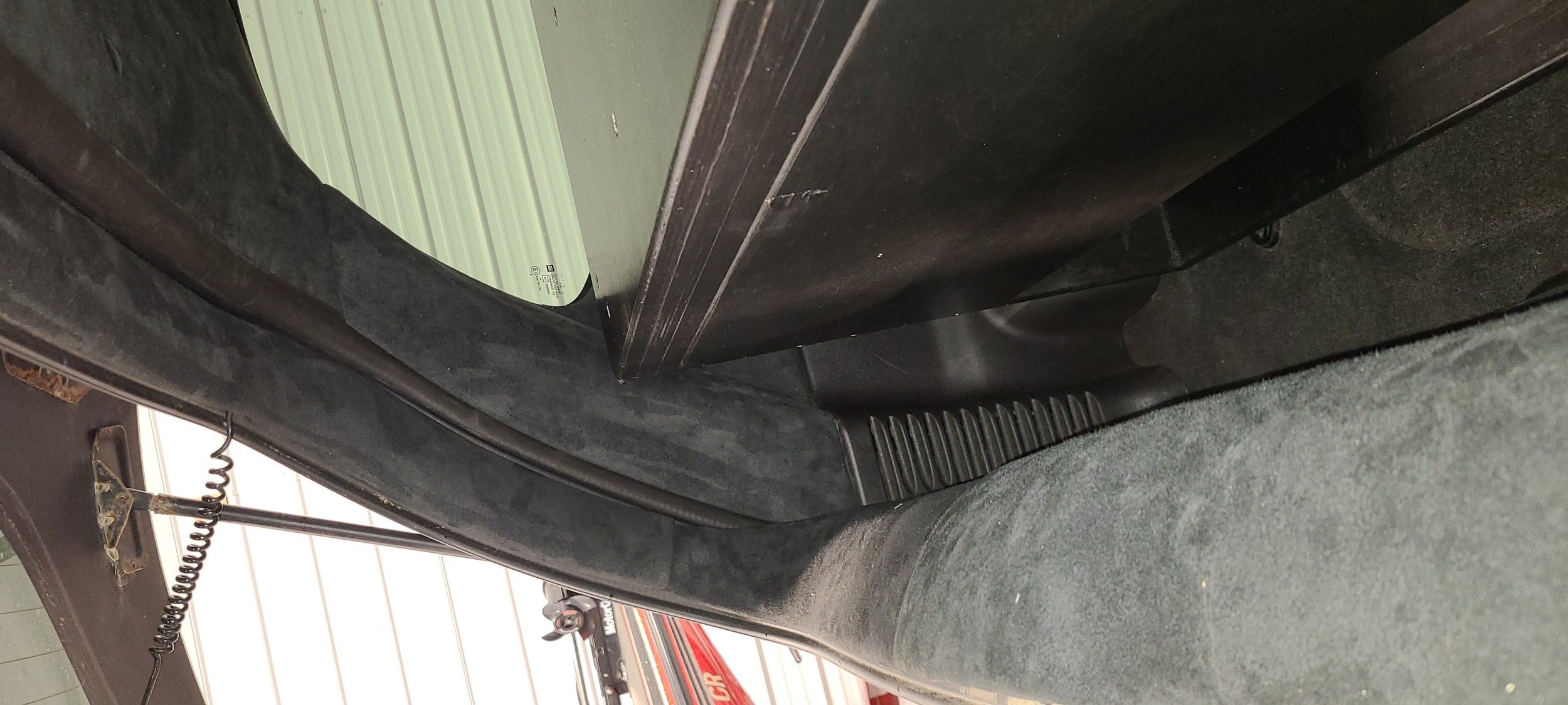

Also this is a look when the rear hatch is closed. It's about the same distance as the height of my port. But I worry it's messing with my airflow.
