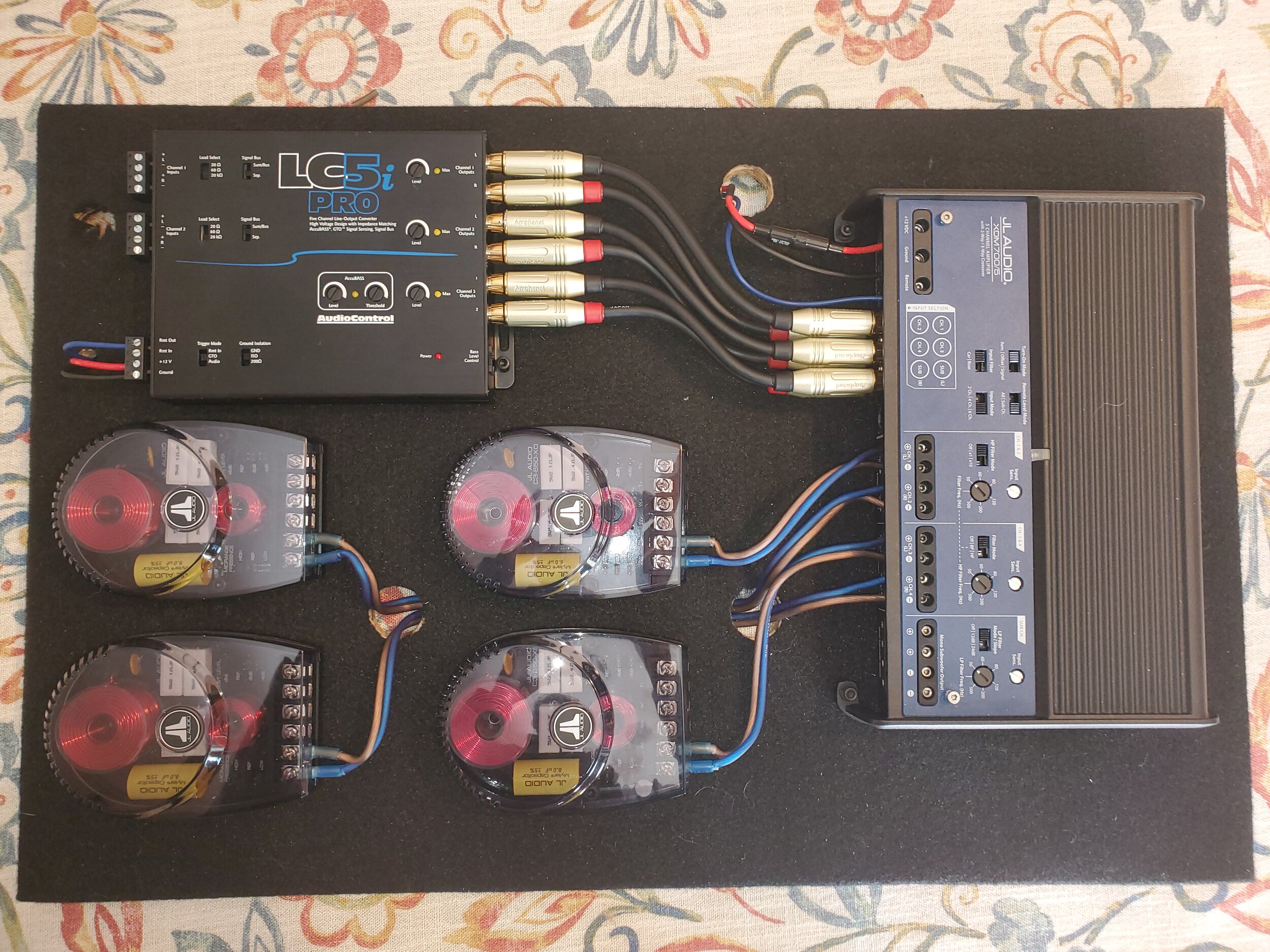

I am doing an all JL audio instal on my new F250 SD . I'm using a Audio Control LC 5i Pro with a JL Audio XDM 700/5 and C3-650's in all 4 doors and a 10" TW1-2 Sub . The fronts will have the tweeter in the pillar and the rears run as coaxial . Here is a pic of the amp board . The doors will all be sound treated with Boom Mat and Blackhole tiles with custom door access panel block off plates from Sounds Good Stereo

I would add an ANL Fuse @the amplifier supply with its recommended 100 ANL fuse, and Keep the 120-150 @the Battery...
