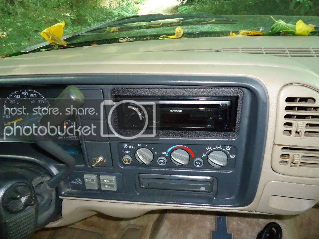

This coming weekend. I will be doing a full install on a 1996 Chevy Suburban.

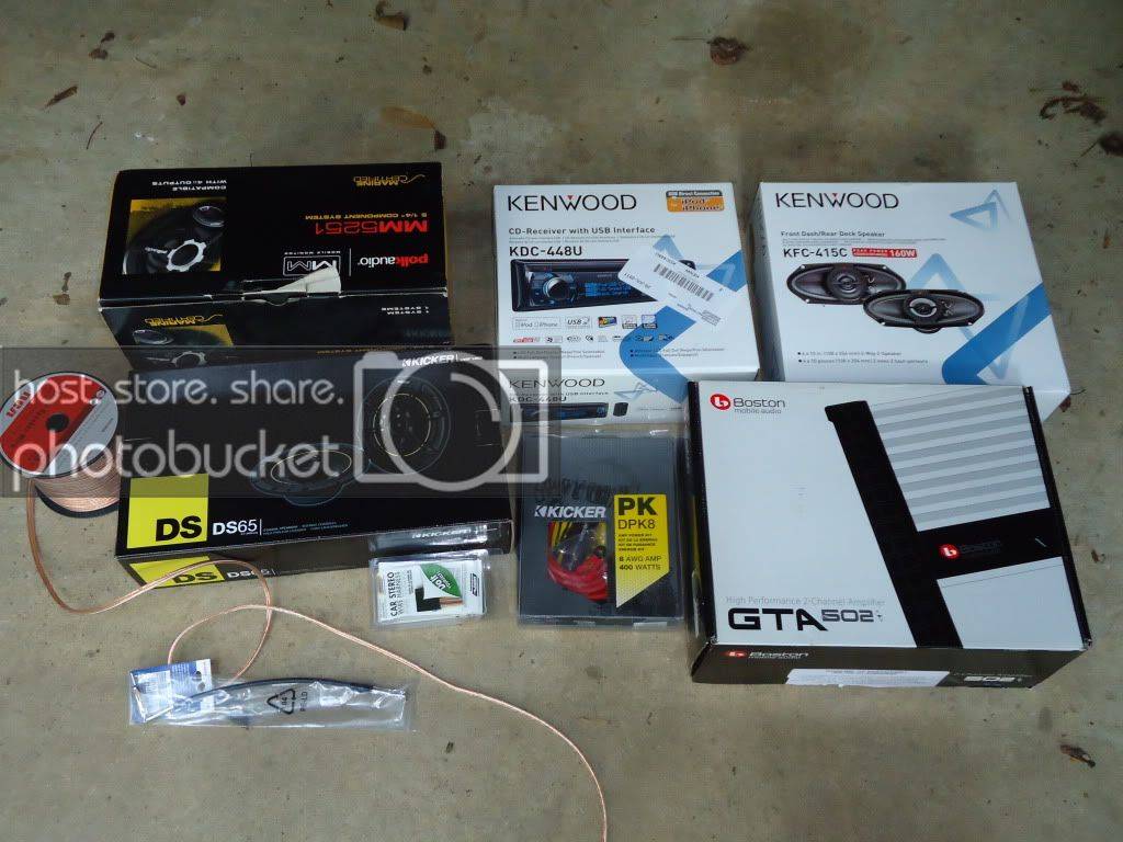

Install will consist of:
Running all new speaker wires
Boston Acoustic GTA-502 amp for fronts
Polk 5.25 MM series components

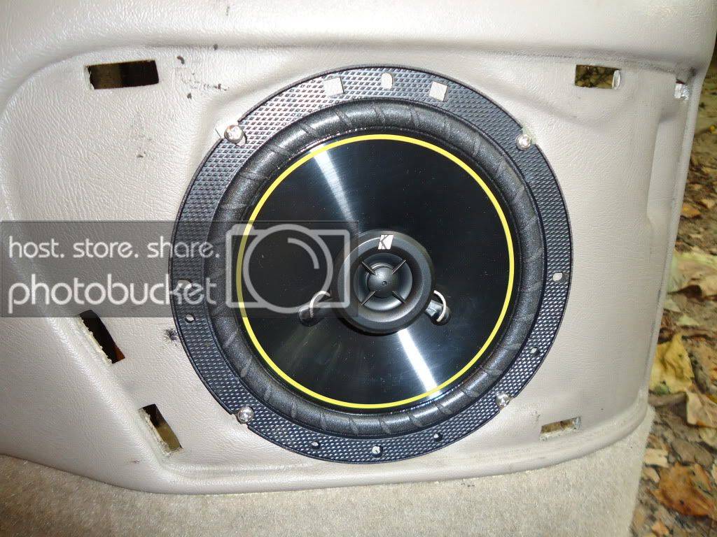

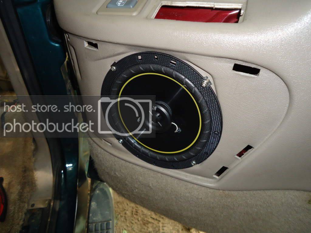

Kicker DS65 6.5" Coax Speakers for rear doors

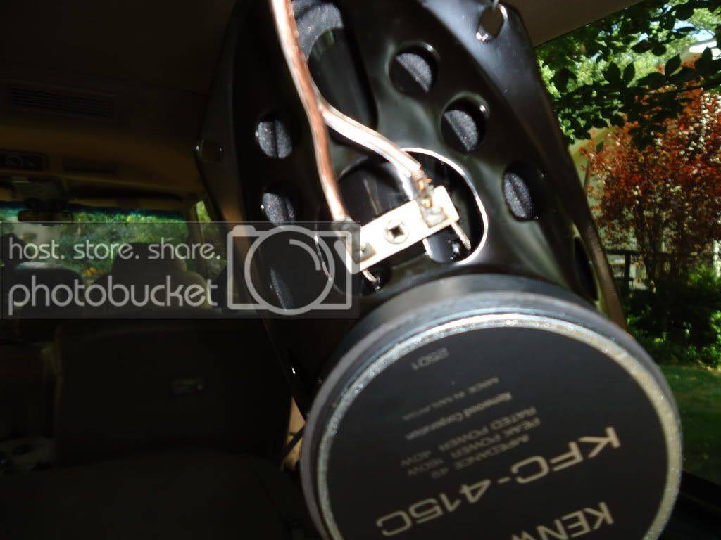

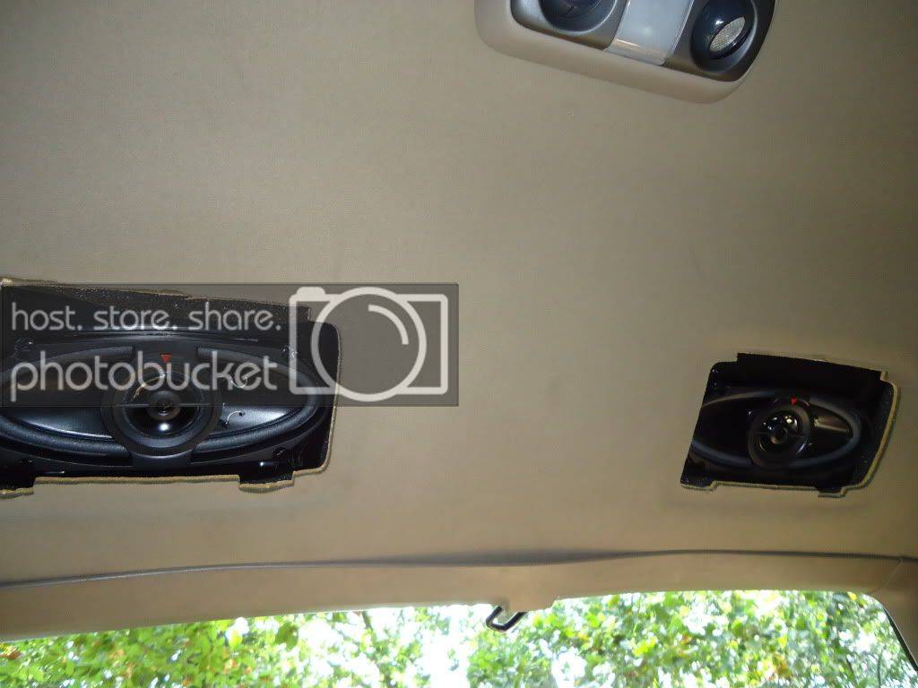

Kenwood KFC-415C 4X10 Rears

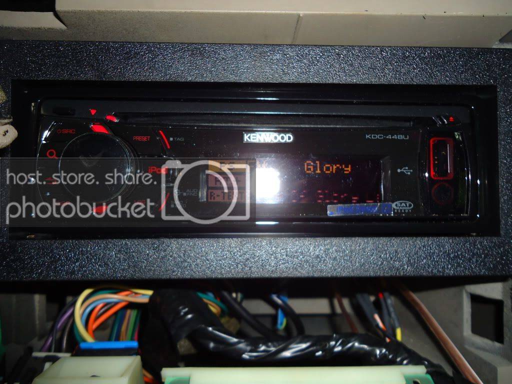

Kenwood KDC-448U Head unit
Many pics to fallow

The goodies

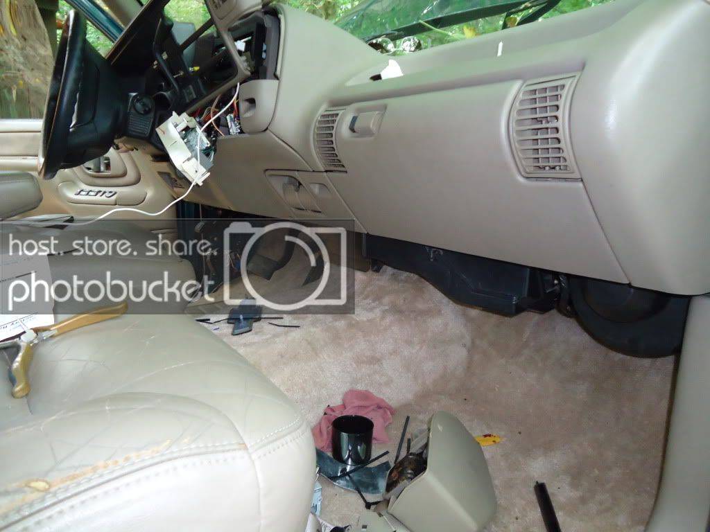

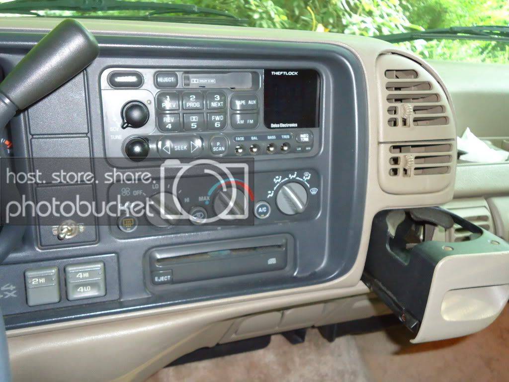

Stock head unit

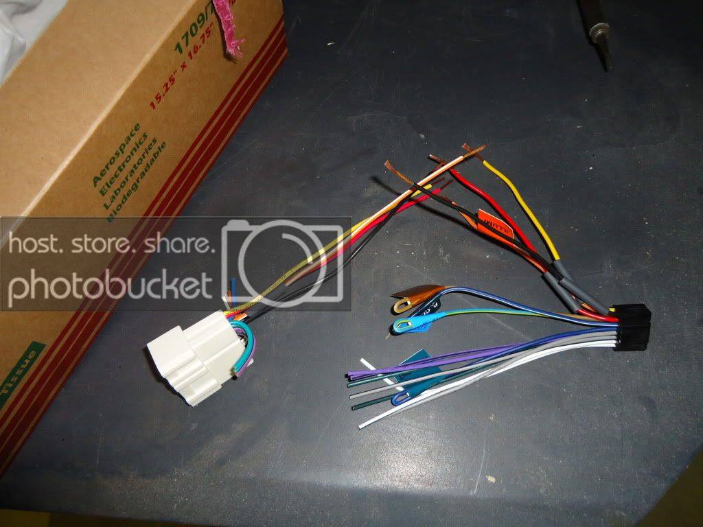

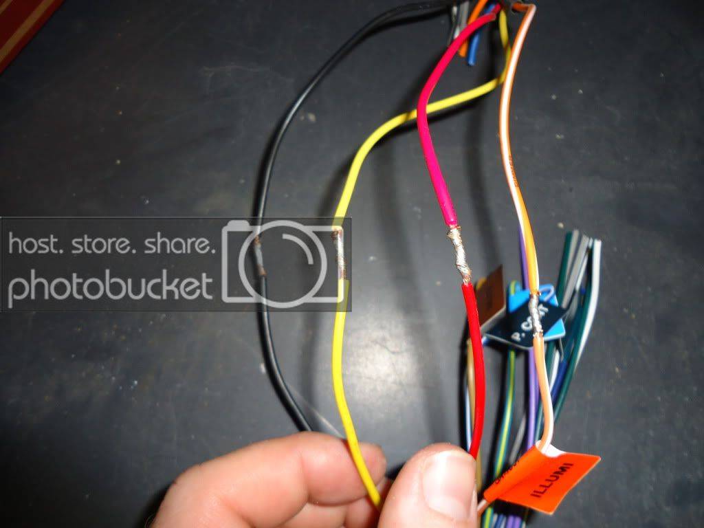

Wiring harness soldered and heat shrunk

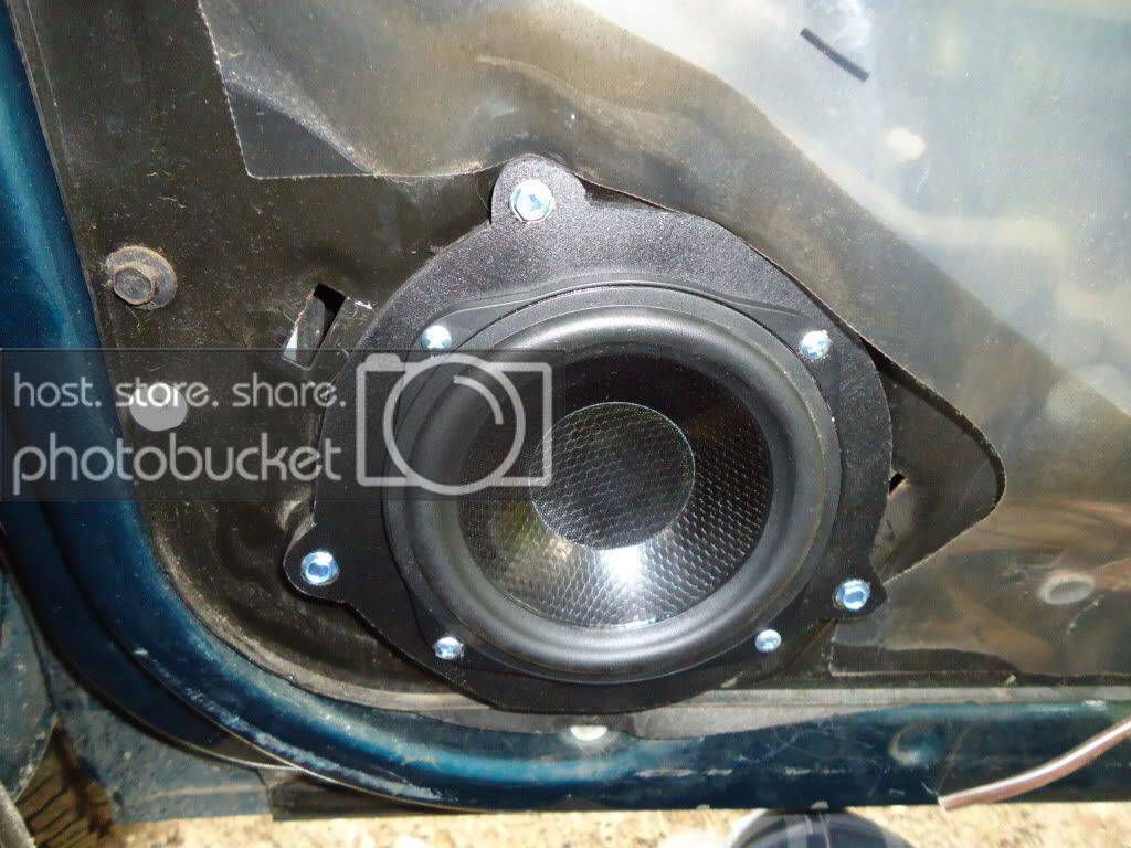

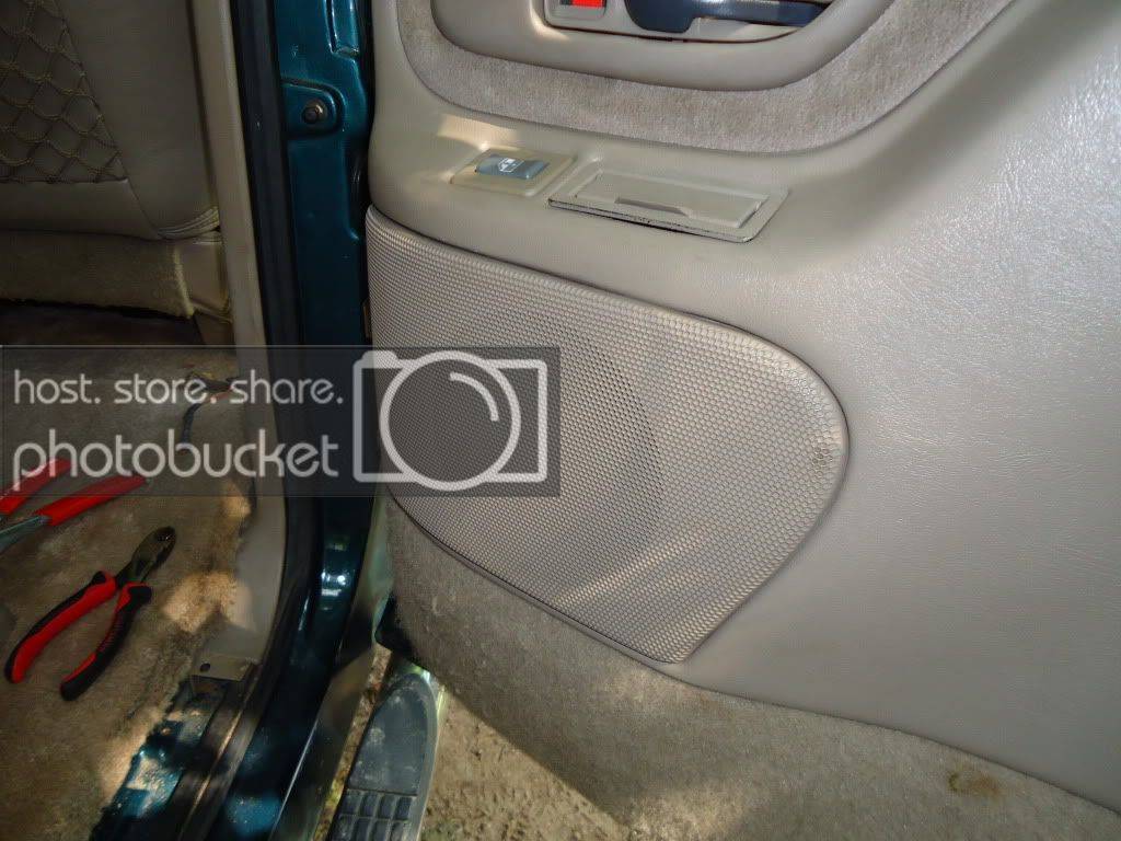

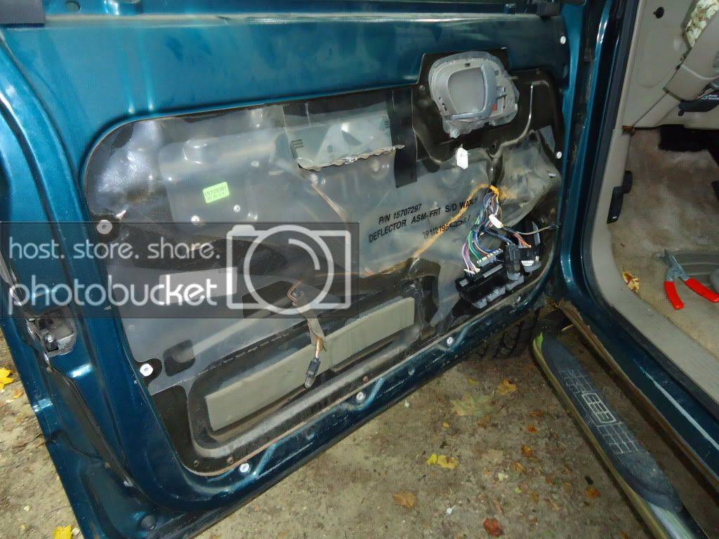

Door panels removed.

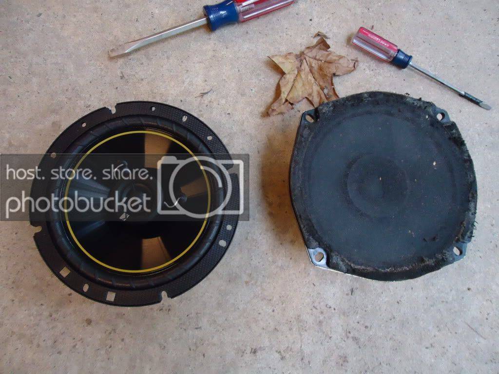

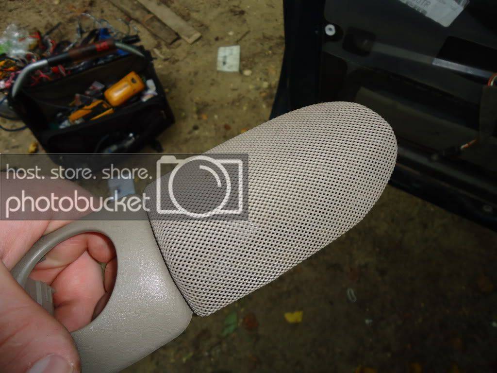

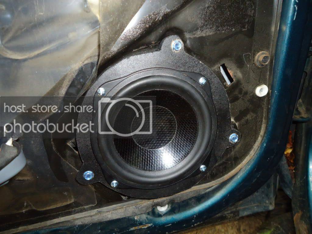

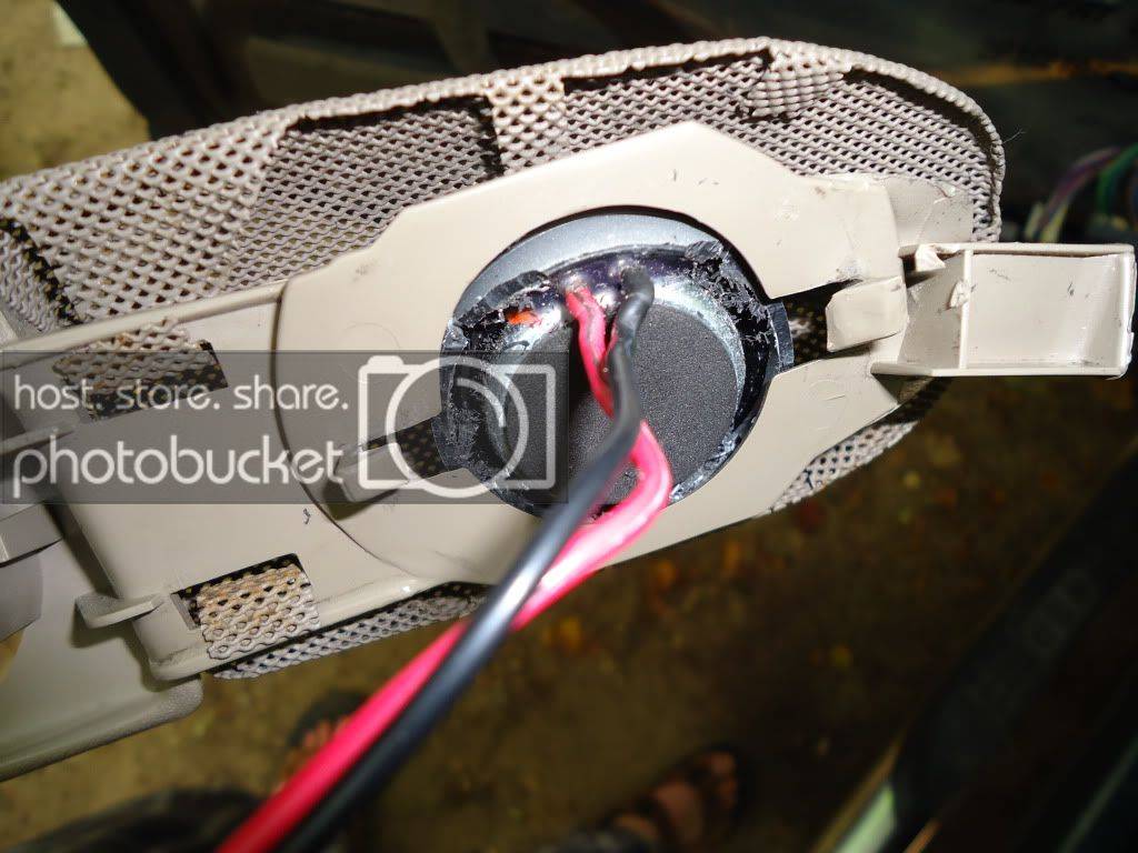

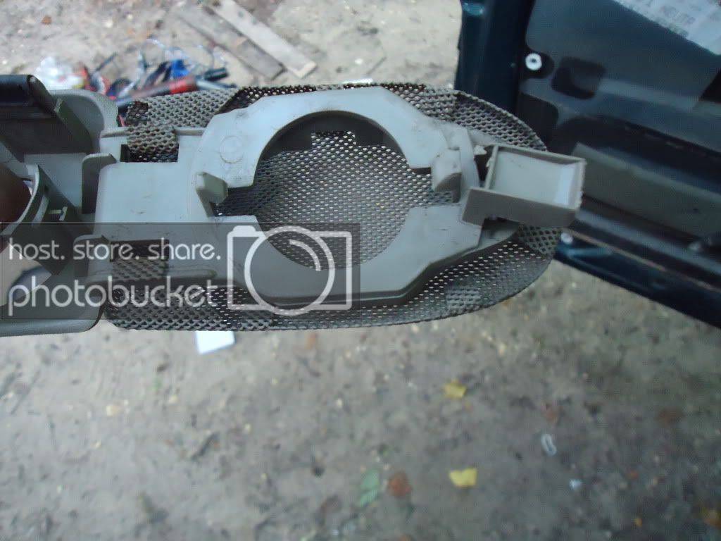

Old and new tweeter location

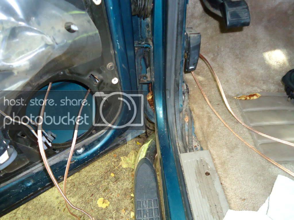

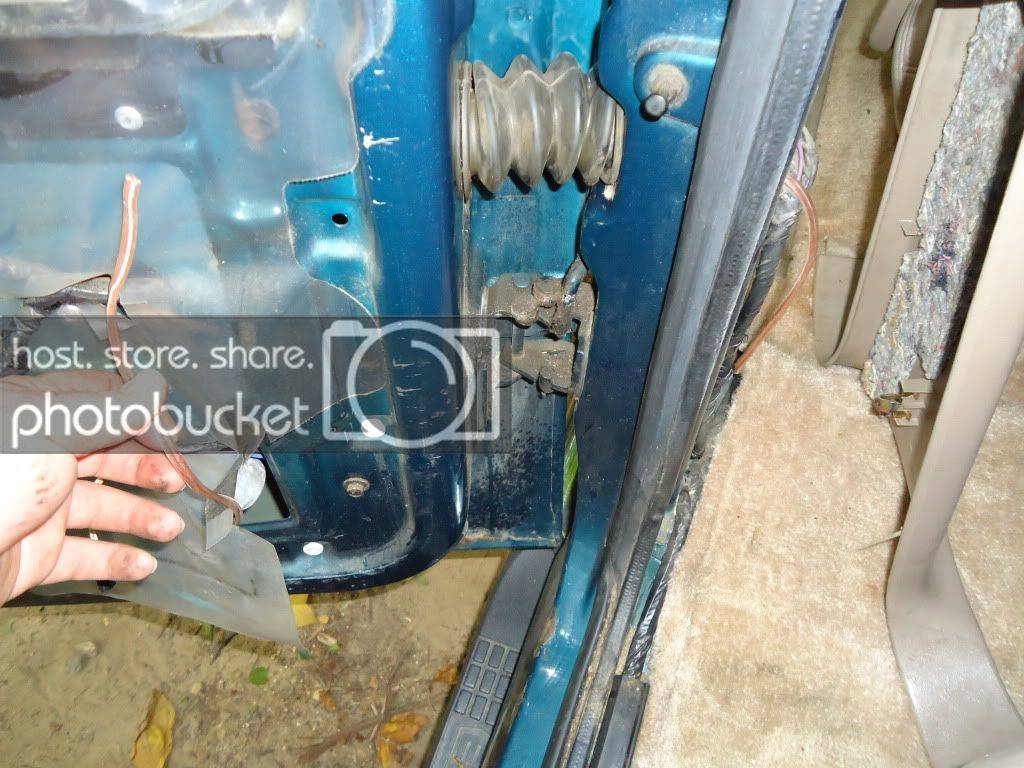

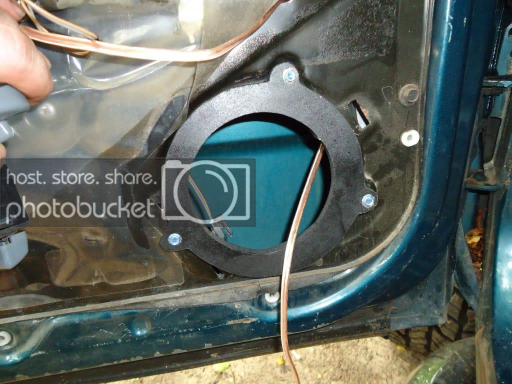

New speaker wires ran

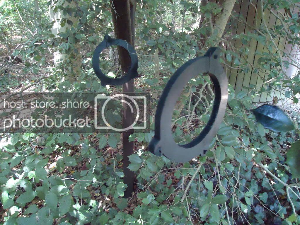

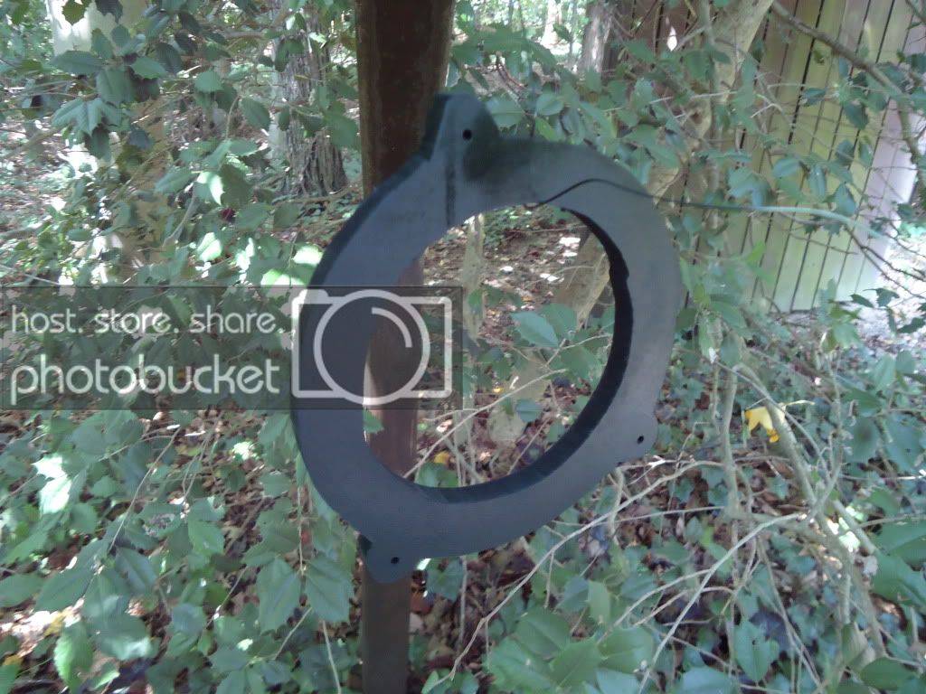

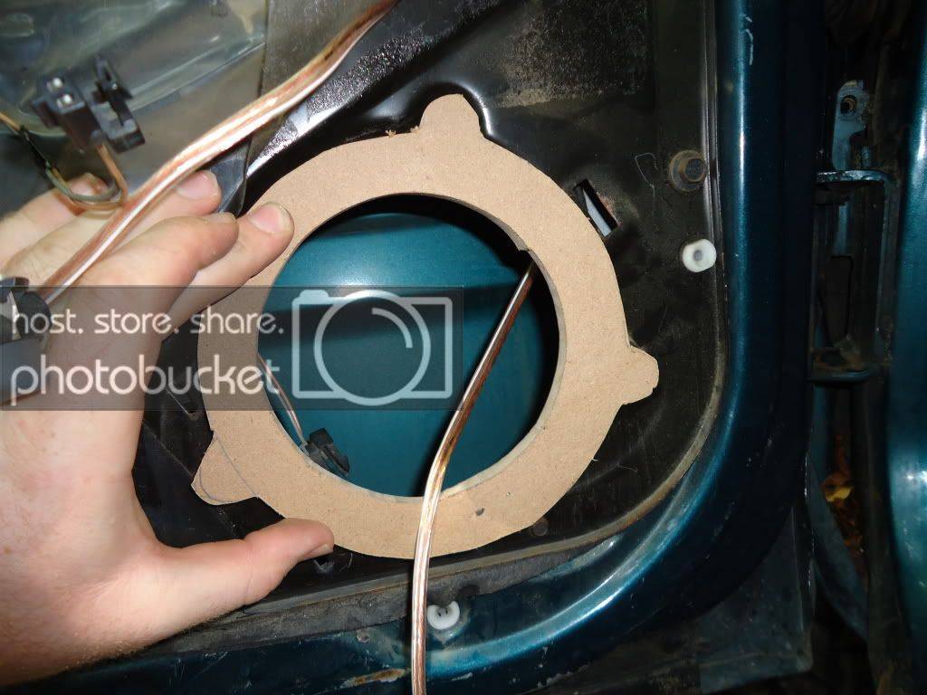

Spacers made
And painted

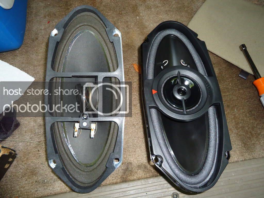

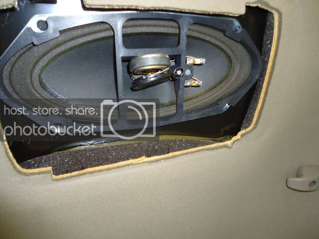

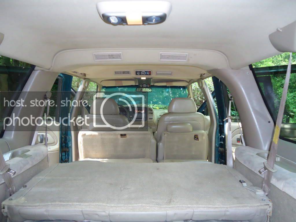

Old rear speakers
Rear apart

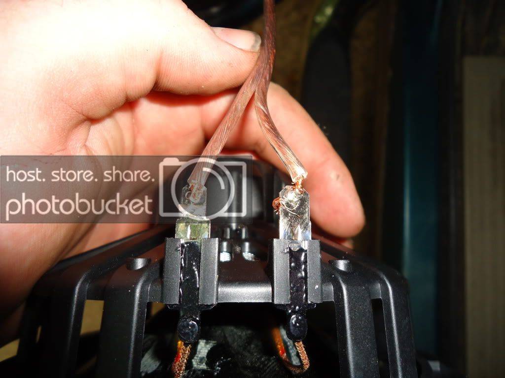

Soldered directly to speakers

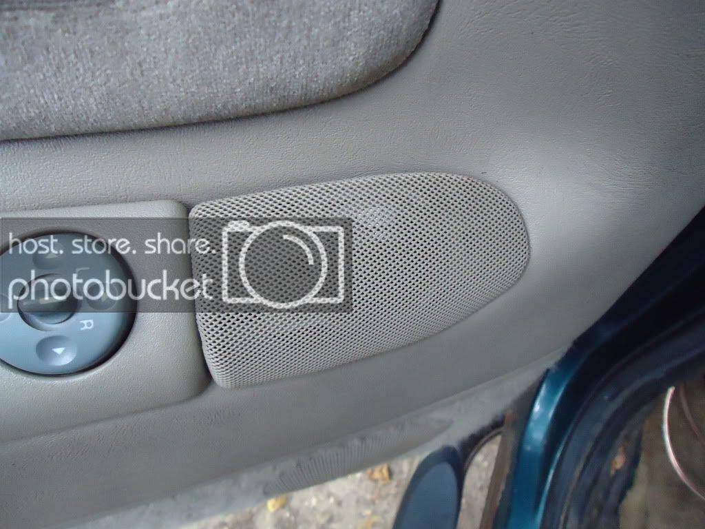

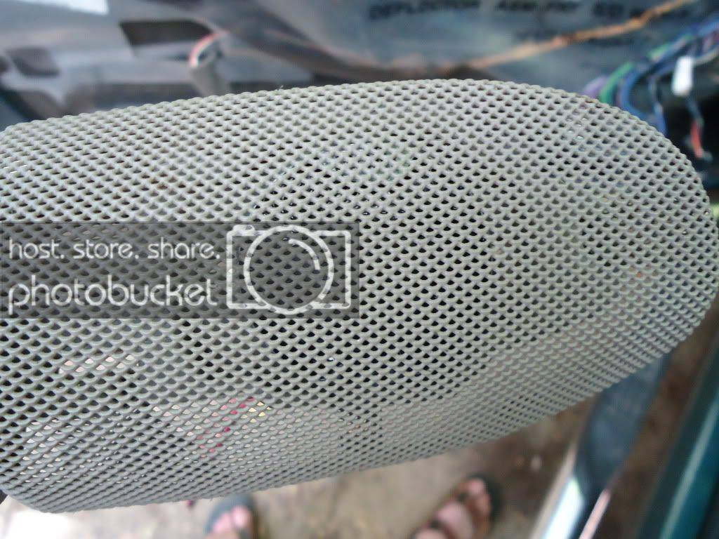

Much better stock grills will go back on.

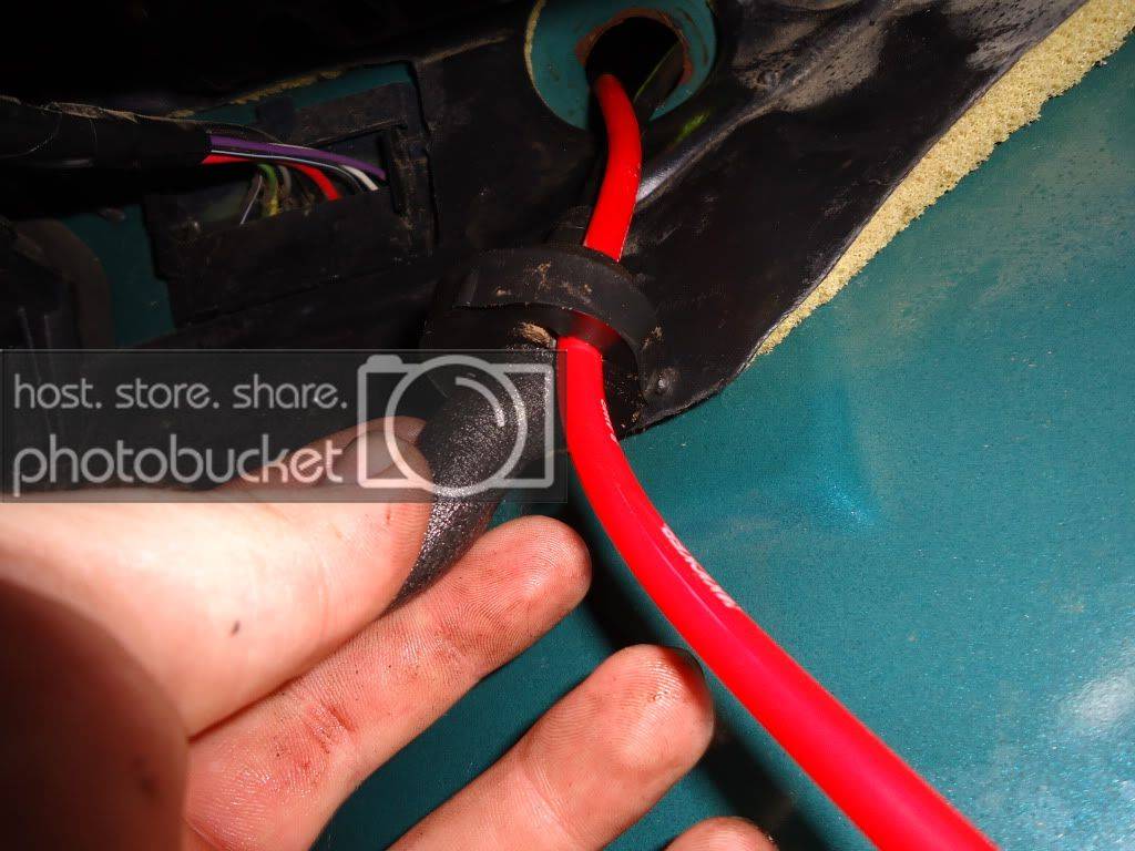

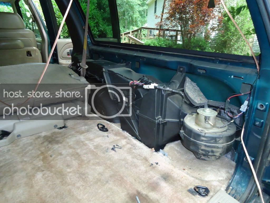

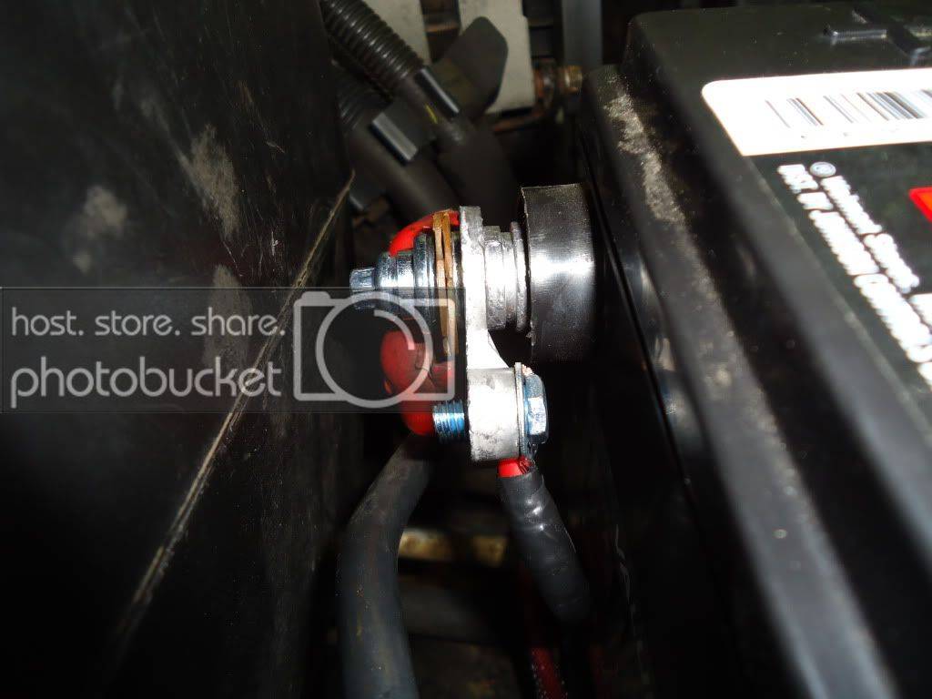

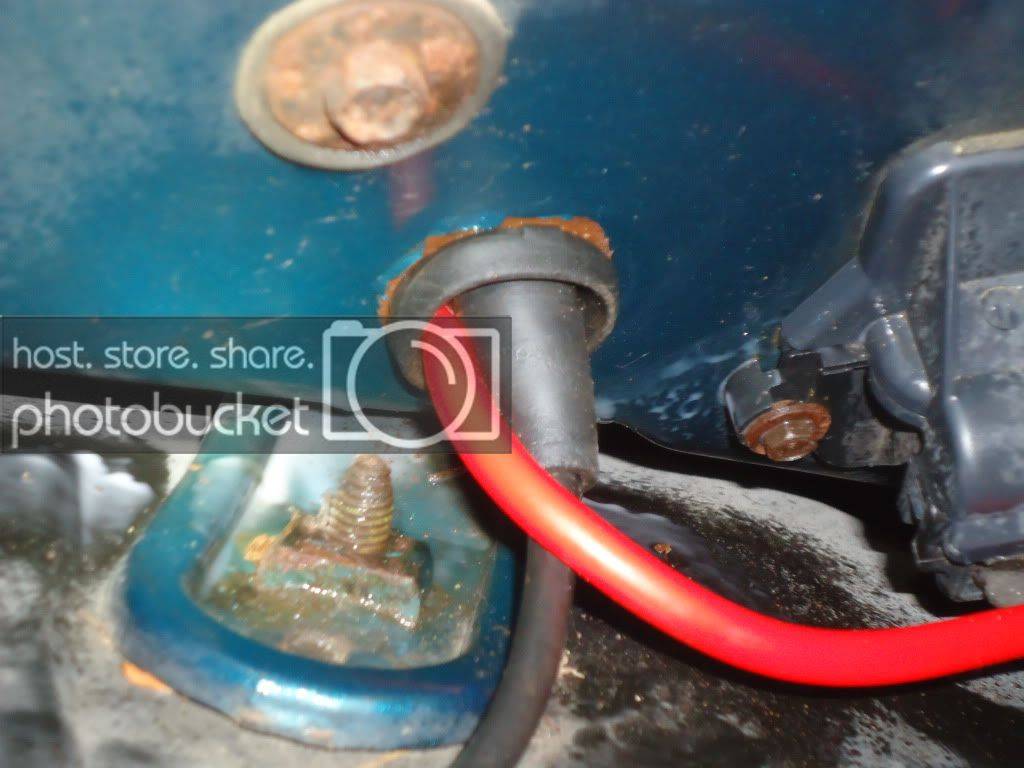

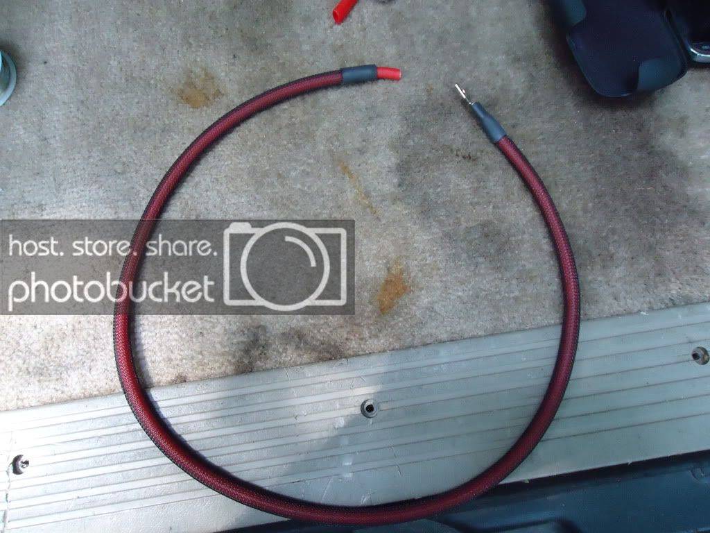

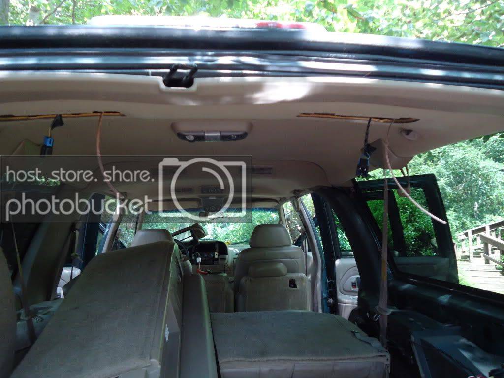

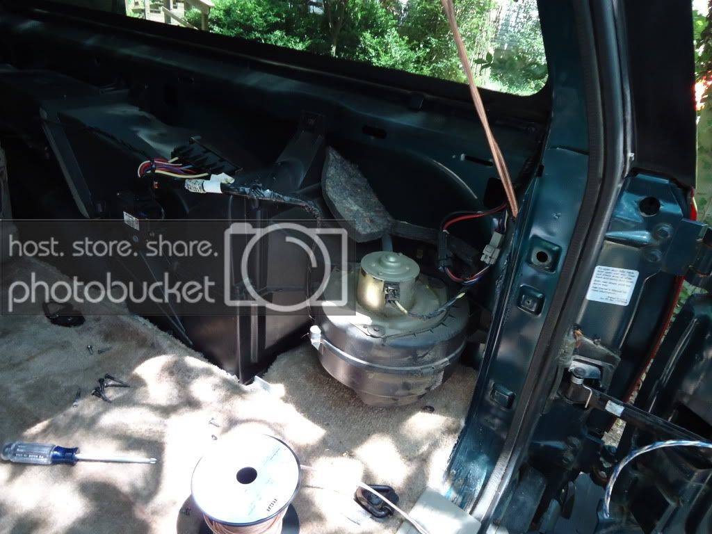

Power wire ran
Owner wanted power wire to be as stealth as possible.
Brackets installed

New Wires

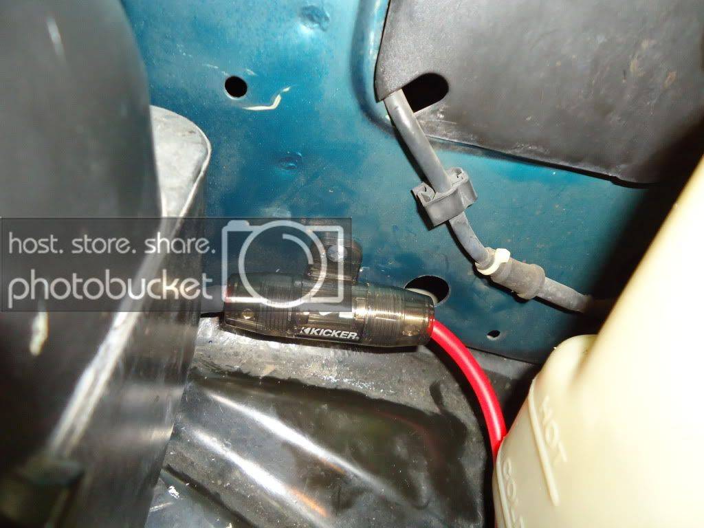

Fuse installed
All wires neatly hidden

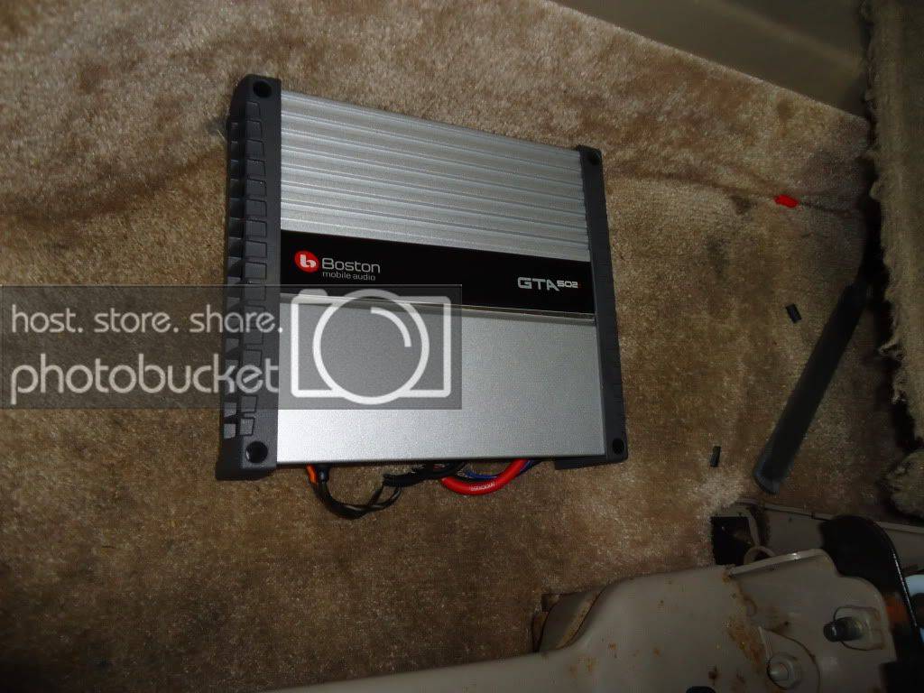

Amp for front speakers
Test and tuning
All and all a great system for being on a budget. The owner who works for a used car dealership has seen some of the worst audio installs ever. He was worried about this happening to his vehicle. However he was not only blown away by the quality of the install but the sound of it as well. I was very impressed myself with the polk mm 5.25 speakers. VERY CLEAR FOR THEIR SIZE!!!
