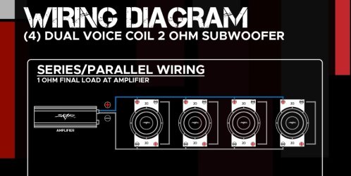

200a fuse big enough? I'll be changing all the wiring to a 0 gauge.. If there is a bigger wire I can buy ill buy that instead.. Bc i want to add 4 skar zvxv2 d2 subs plus my speakers amp that's 4500watts.. Will I need a 12k watt amp for the 4 subs? With all 4 connected series/parallel should be 1ohm final load at amp. Any recommendations for the amp needed?
