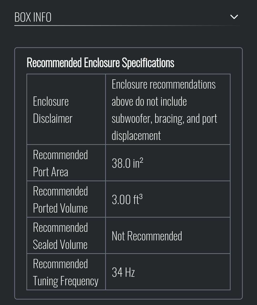

I'll be changing the box for a ported one.. any specs of the box recommended?
This is skar's recommendation
Personally I'd prefer around 30hz
