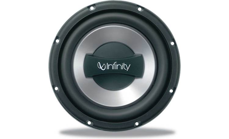

Rookie question. Been buisy with work. So things slip my brain train. If i have a 1000rms example jl jx1000.1d would it.be over kill for some infinity reference 1250 12s (2) ??
If you are talking about these subs.. You will be fine wired down to 2 ohm load on a pair of subs. Tune appropriately and you will be just fine. that amp will not run so hard with plenty of head room and should run a bit cooler as well , with proper ventilation, and the correct supply for the demand for that amp.

Okay so for wiring these 2 are 4ohms but my choices would be either 1 ohm or 4 ohm. How do i get 2ohm. Again sorry i cant believe my installing knowledge went out the window like that. Customers at a restaurant are killing me
Then you'd need to run at 4ohm...that amp isn't rated at 1 ohm
If you want to run a pair of SVC4 subs, these are your options for best results for that amplifier that is rated @2ohm mono stable.

I dont know of any JL mono amplifier on the market at the moment that is 1 ohm mono stable. They could have came out with one by now or soon will
