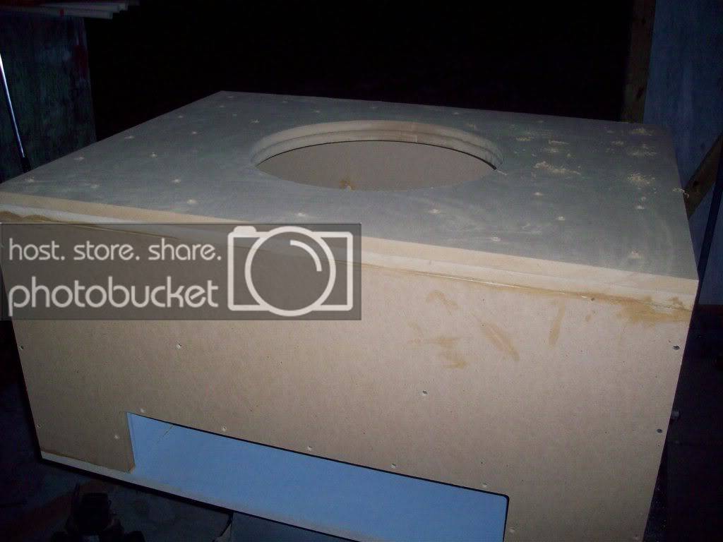

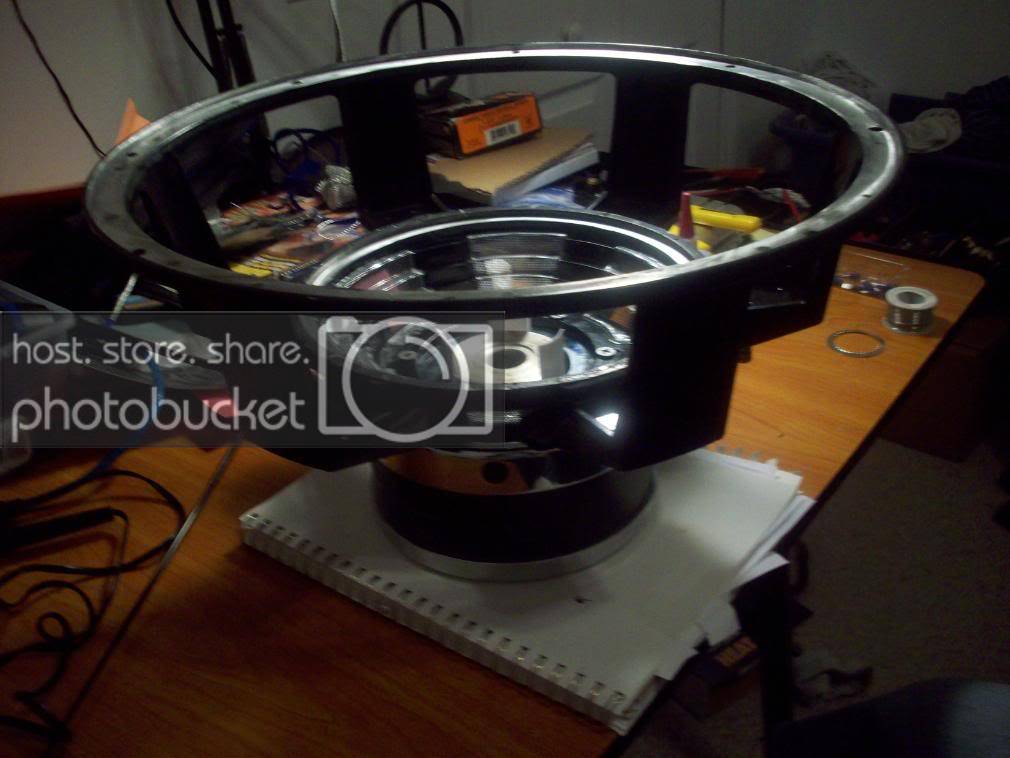

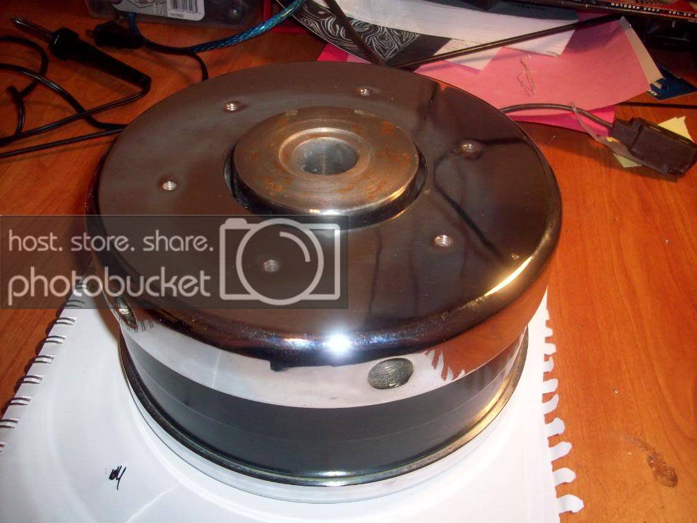

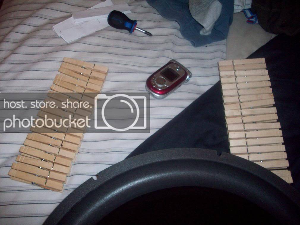

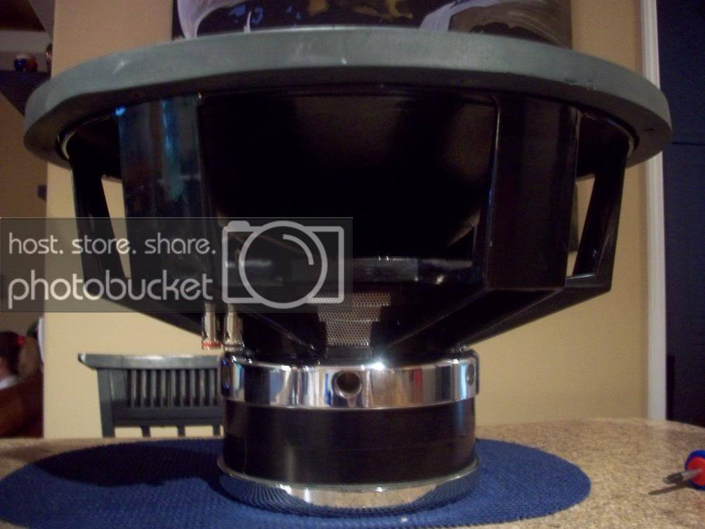

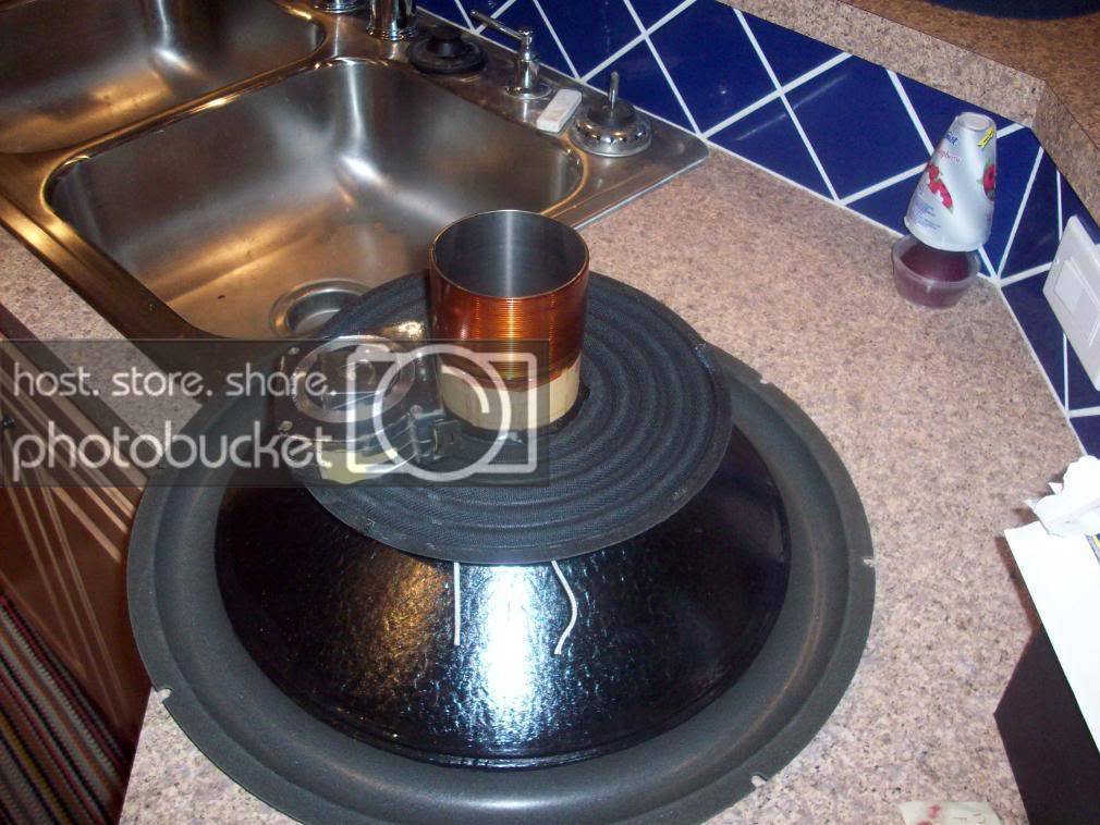

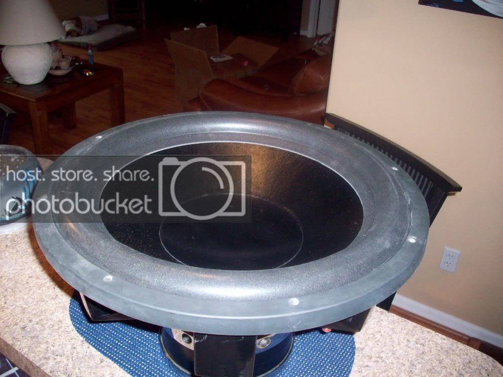

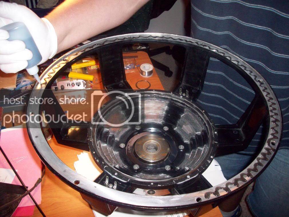

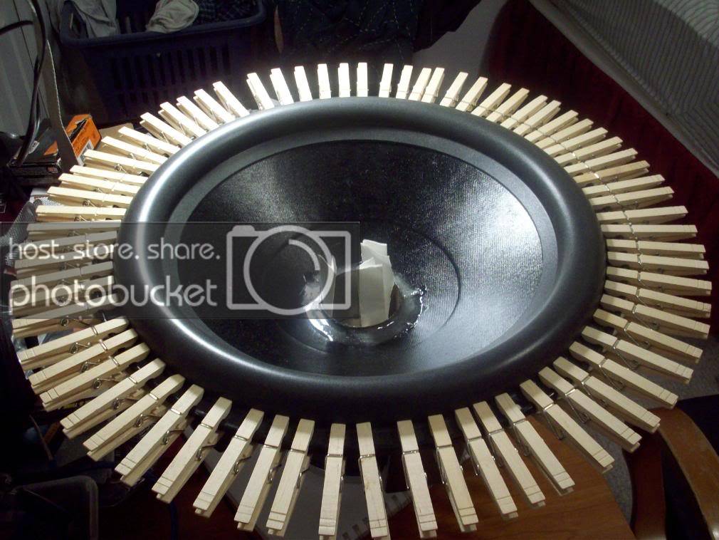

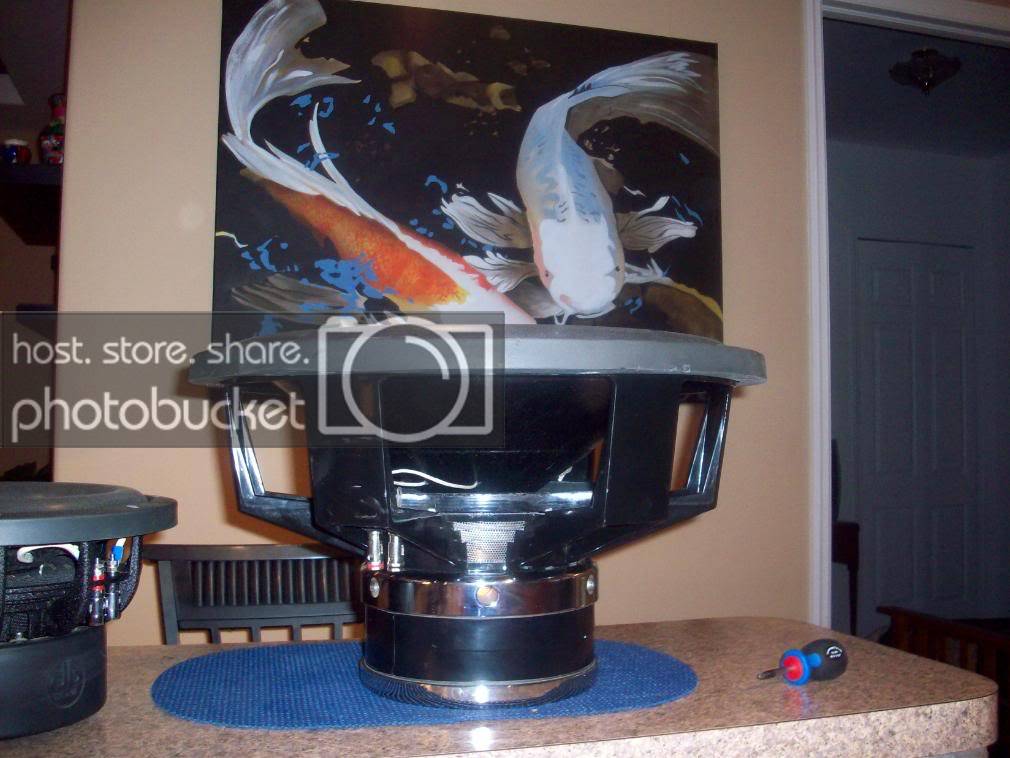

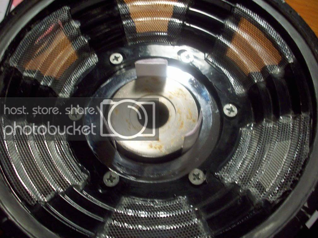

The motor is off of a Mmats Jugg. It was a 12", now it is an 18".
The recone and basket were supplied by Sound Extremes.

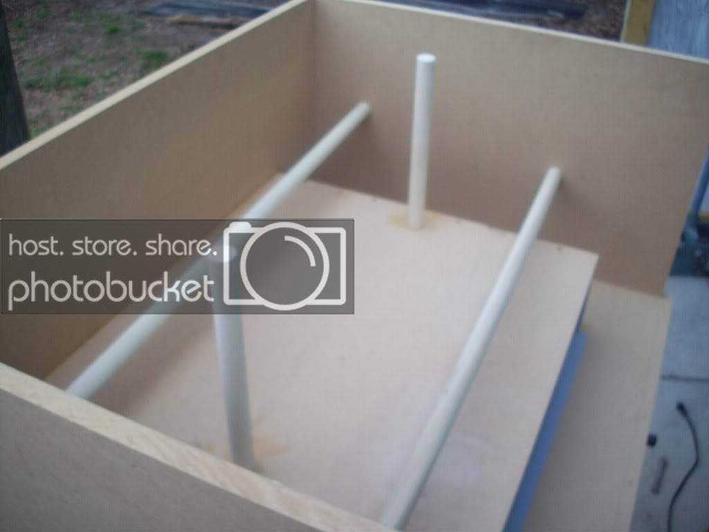

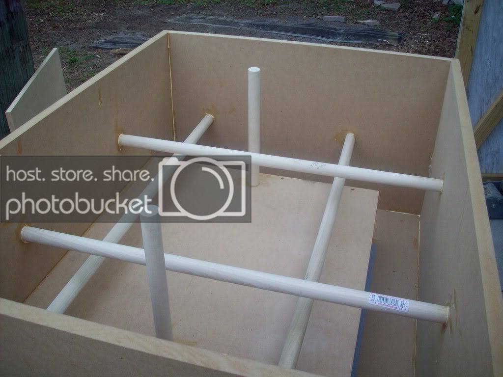

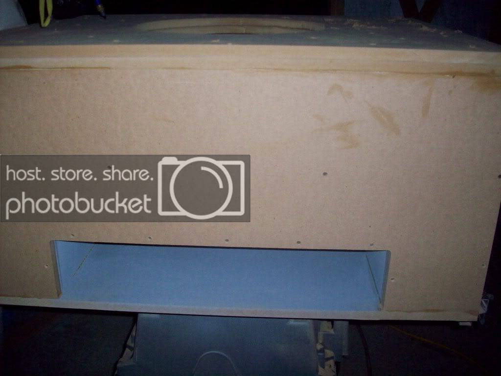

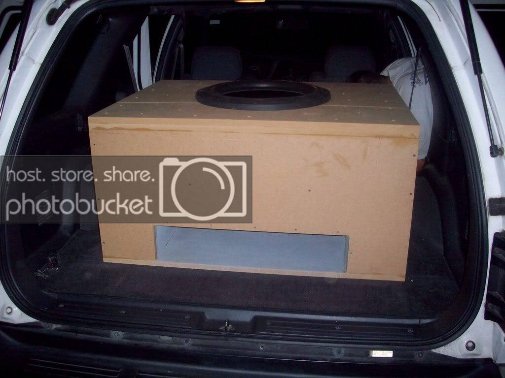

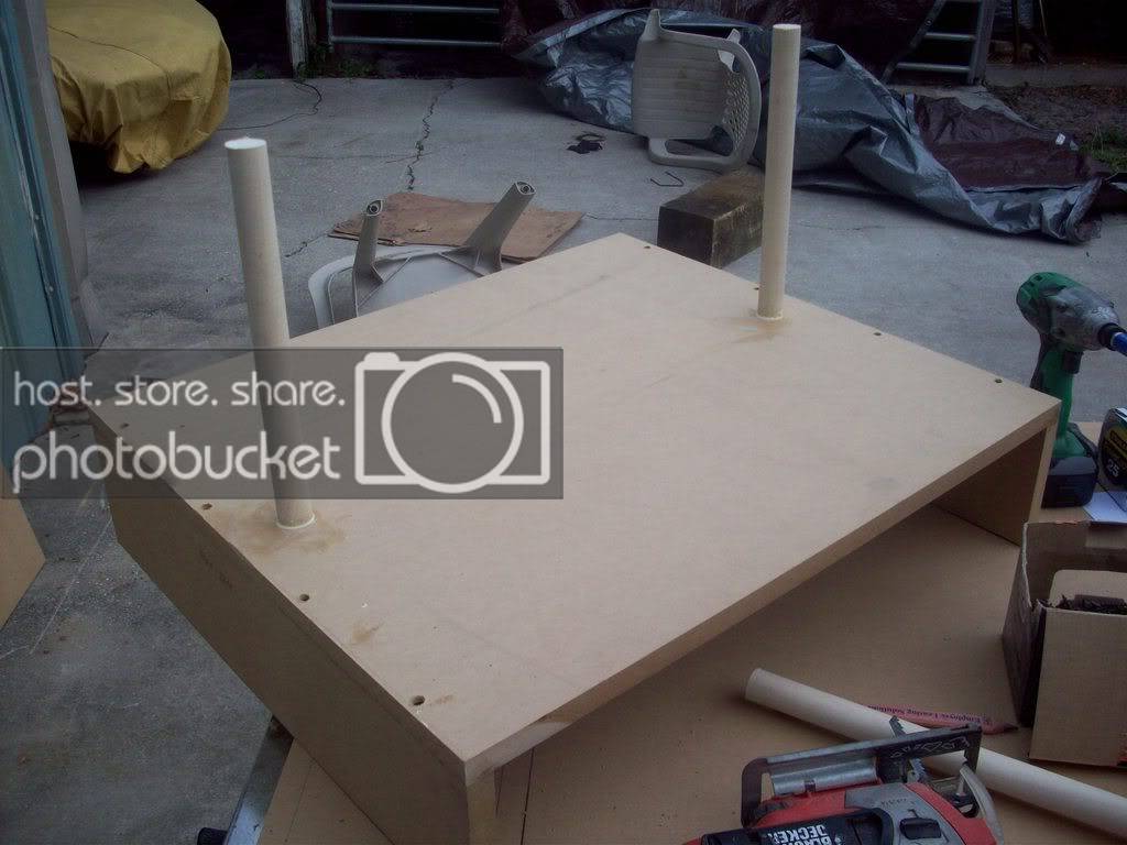

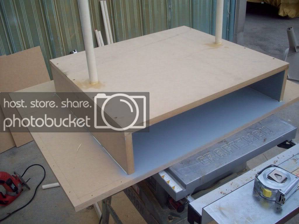

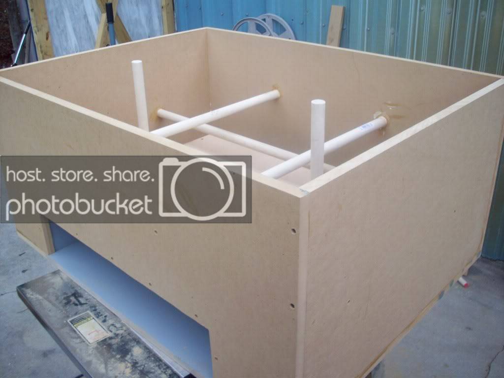

The box is 7.85 cubes after sub, vent and bracing. Tuned to 35hz.
Pics ..........................

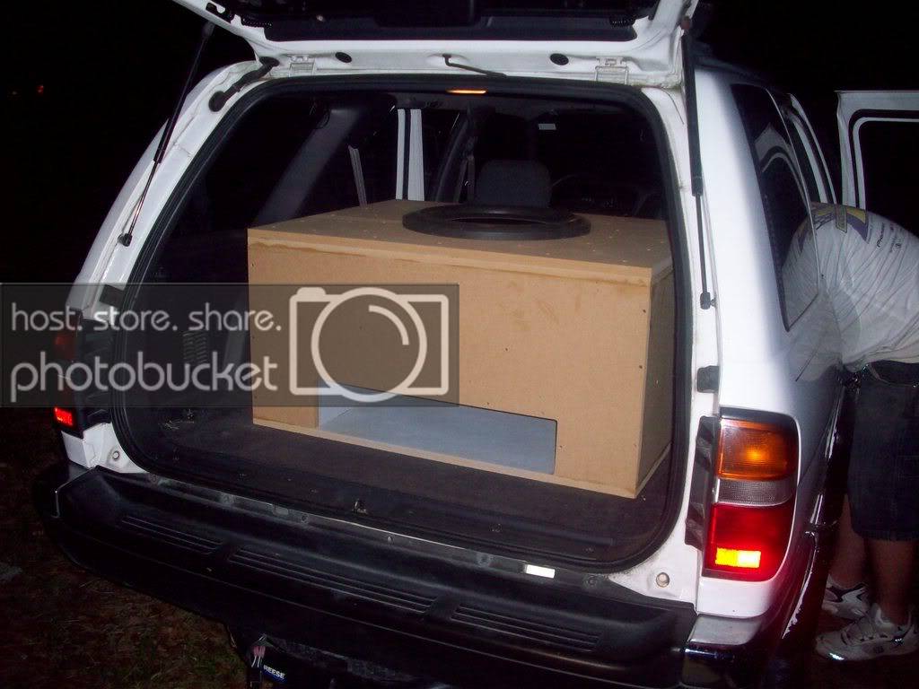

Here is the only vid I shot tonight. It shows how the cabin light comes on when the lows hit. It is forcing the rear hatch to open.
And yes it is dark. but it was 10:30 when shot.
