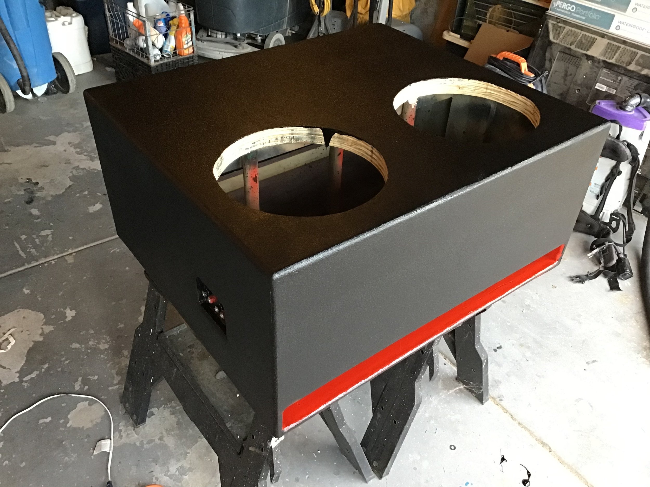

Is that a sealed enclosure? Or Ported? What are the specs on the enclosure? As stated.. you need some power for those subs to serve any justice and a well tuned enclosure
Ported enclosure

So when I turn it up past certain volume or I get to certain low baselines it goes into protect mode I get the clipping I was thinking that maybe I was smothering the subwoofer with too small of an enclosure if it's clipping am I draining that 1200.1 completely or do I have another issue
That sounds like a voltage drop issue. Enclosure is another possible issue but the enclosure won’t cause clipping.
