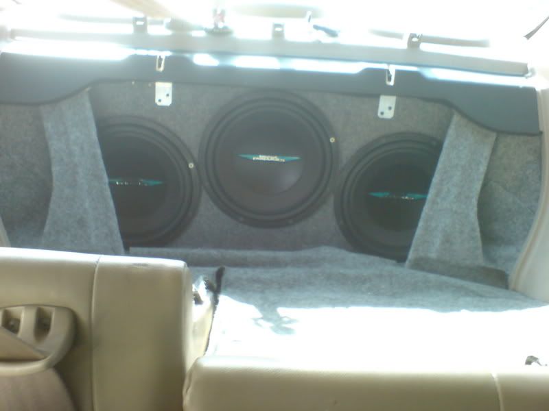

go IB //content.invisioncic.com/y282845/emoticons/wink.gif.608e3ea05f1a9f98611af0861652f8fb.gif
I had two Idmaxs IB'd, and it was crazy.

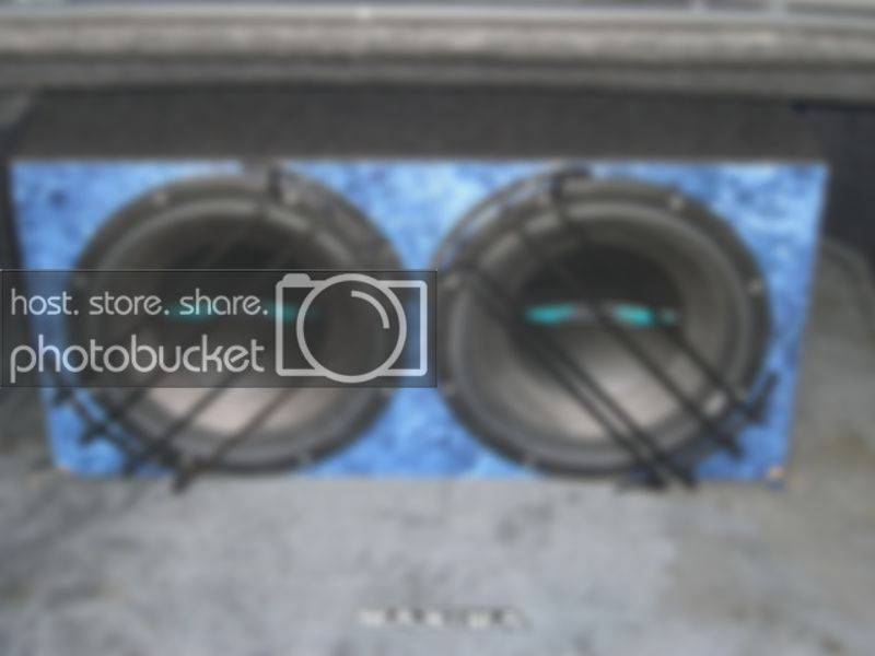

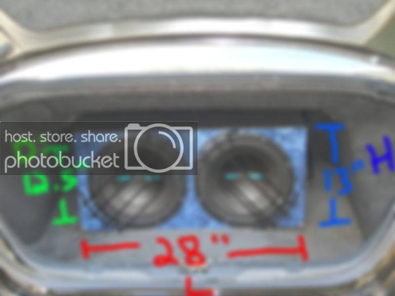

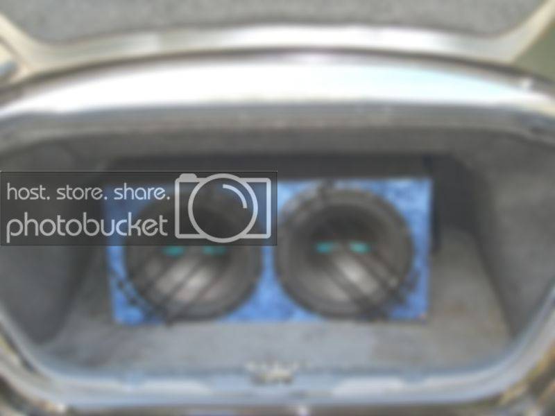

well i finally took some pics of the box and im enclosed them here, do you think the box is too small?

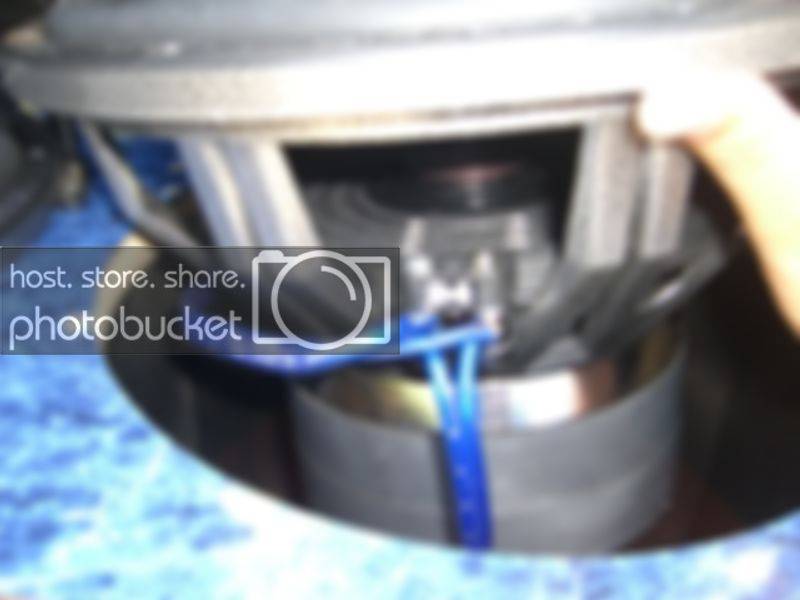

i figured out that i have idmax 12d4's, but im not sure as to what version does anyone know if its written somewhere....
pic of d4
and some pics of the subs:
The box is 28" x 13" x 12.5"

Your box internal is around 25 x 11 x 10 giving you 2 750 sqaure inches of volume
12 x 12 x 12 = 1 728 this is one cubic foot
so 2750 / 1728 and your box is around 1.6 cubic feet
which woudl be a little big for just one, but way too small for two.

So your gonna want another enclosure that is around 1.3 -1.5 per woofer to get optimal sound...
