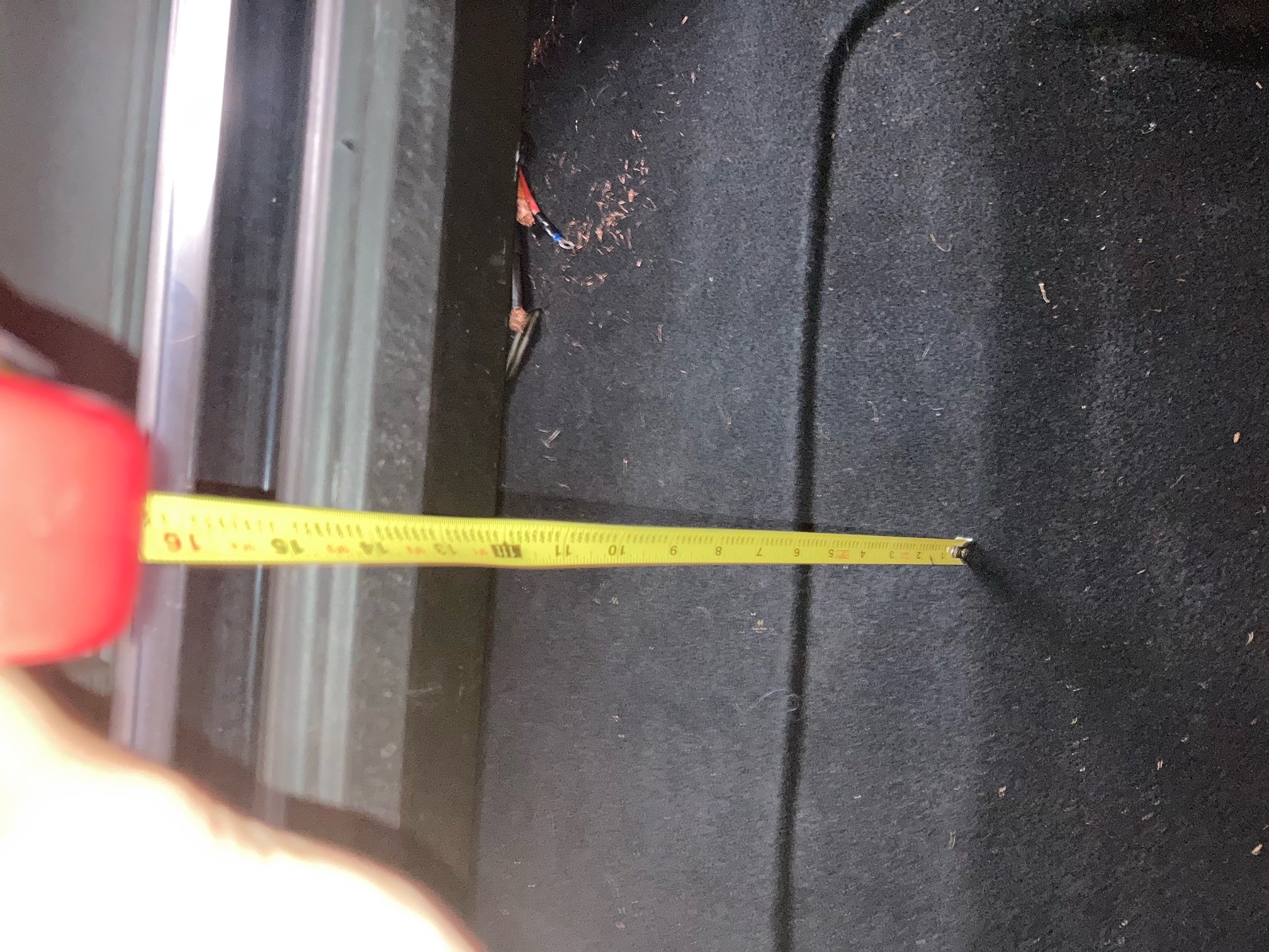

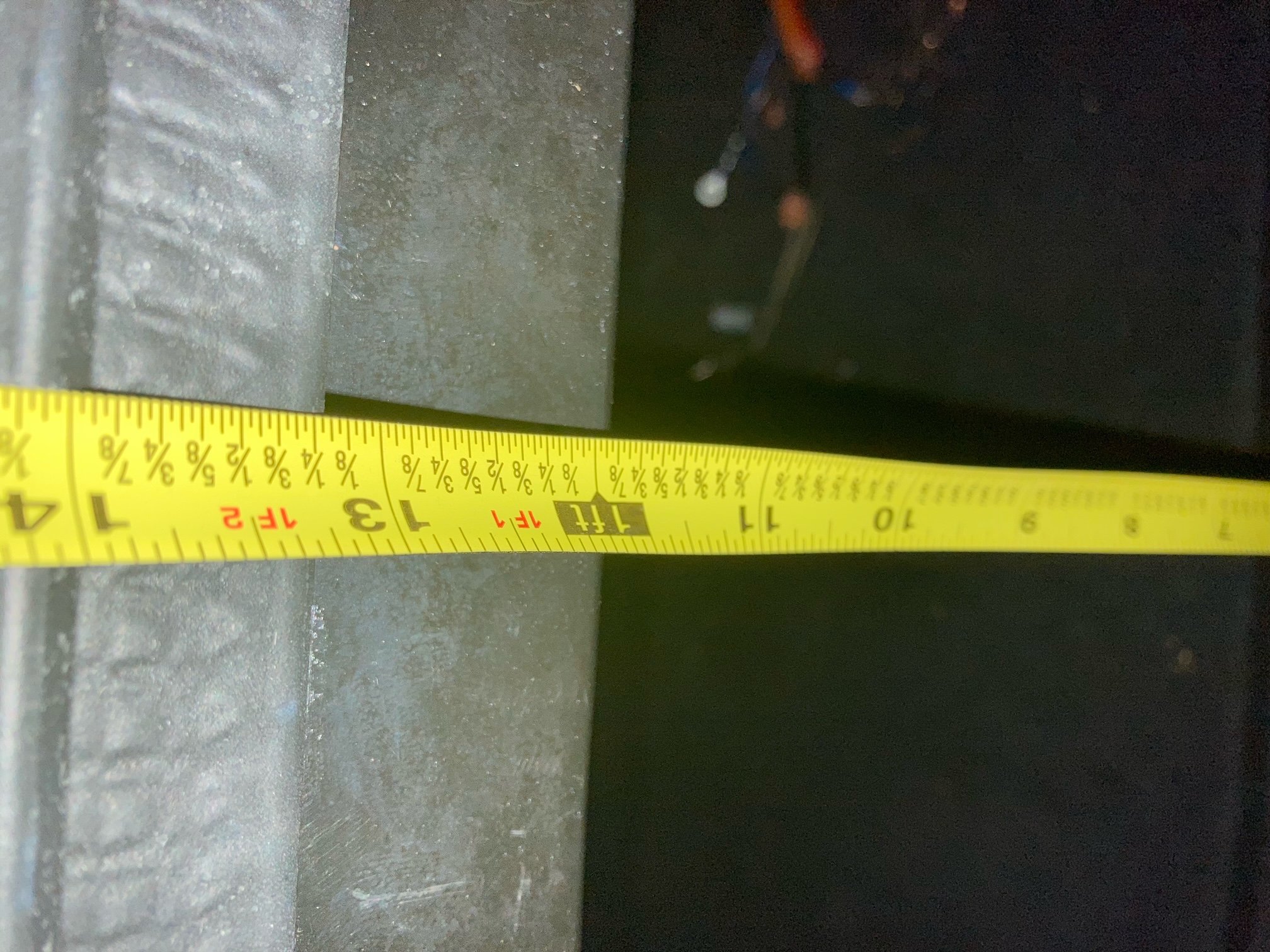

This is the max height the box can be. It can only be 12" tall so I am limited by these two boxes shown below. I haven't found many other choices besides these that will fit.

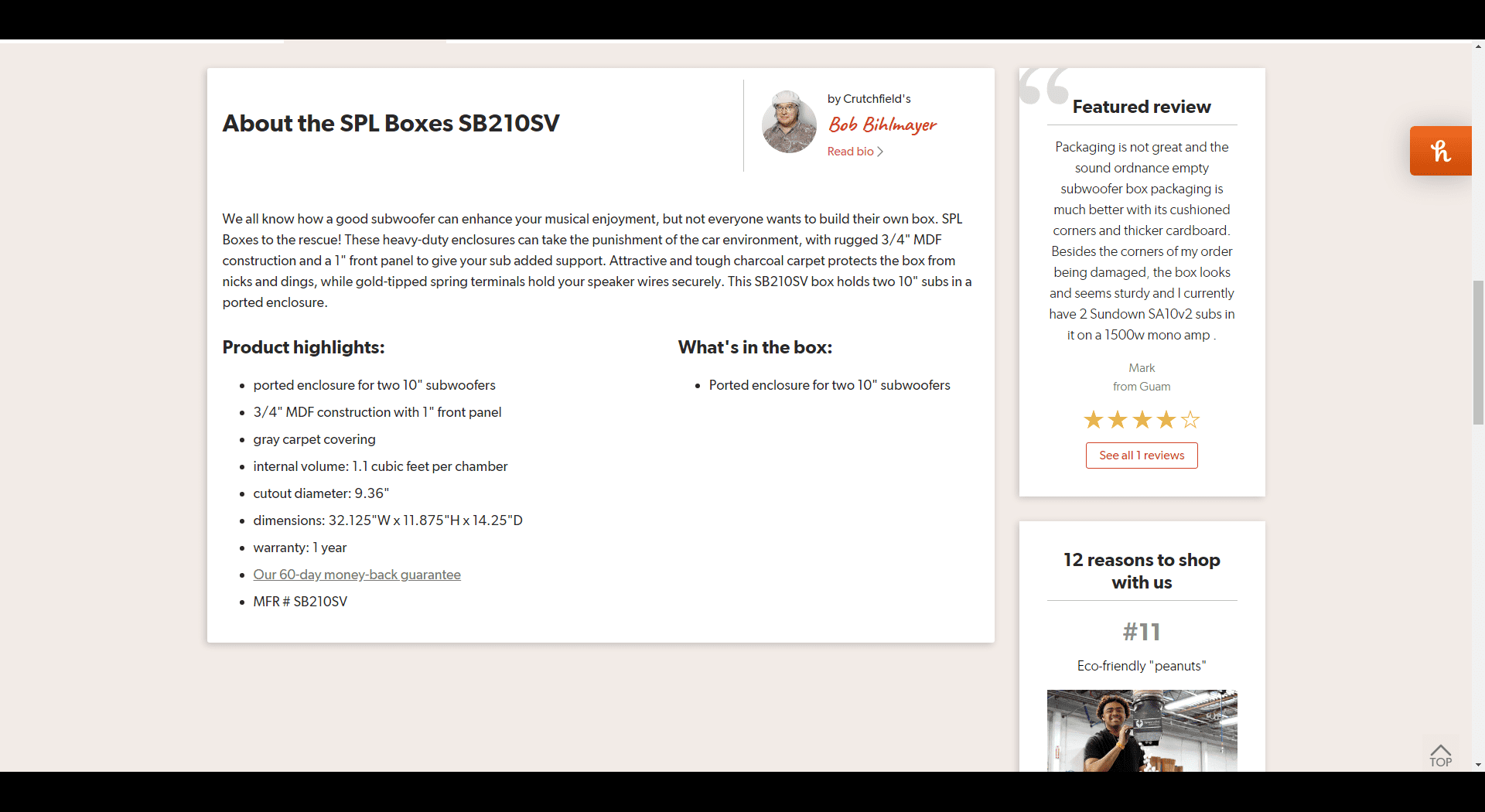

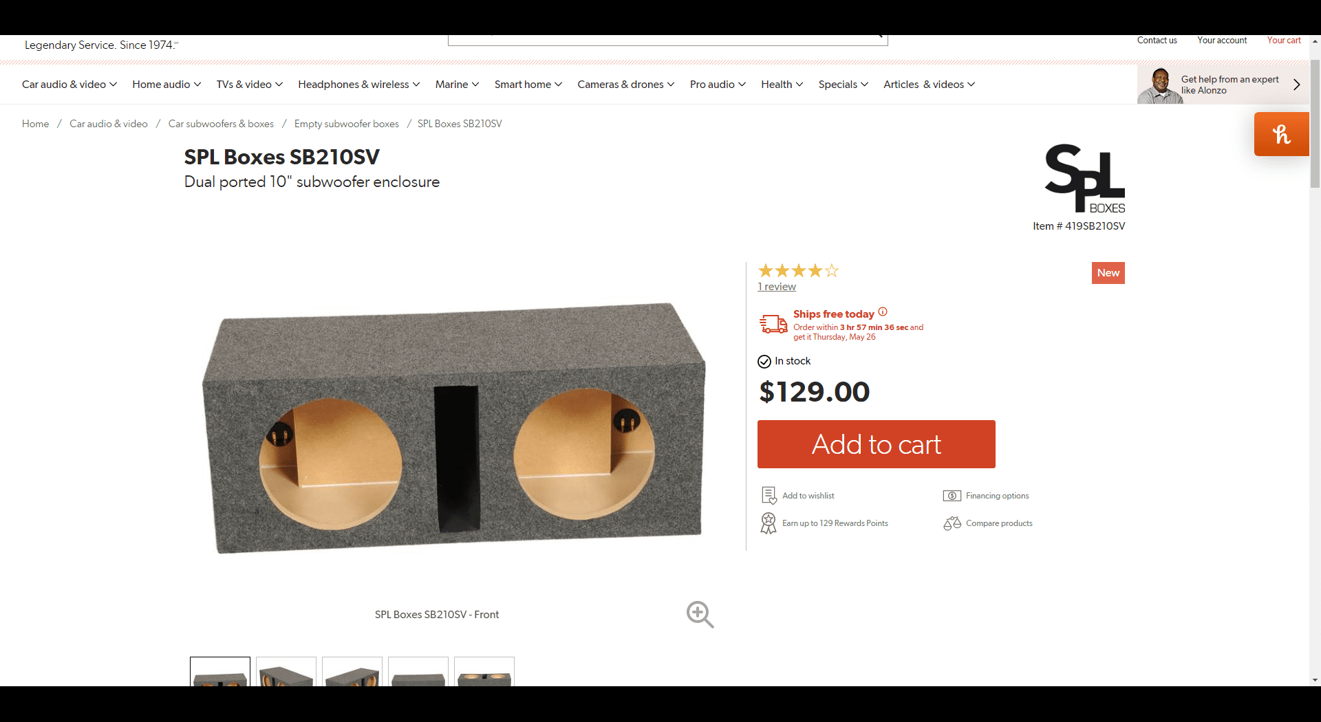

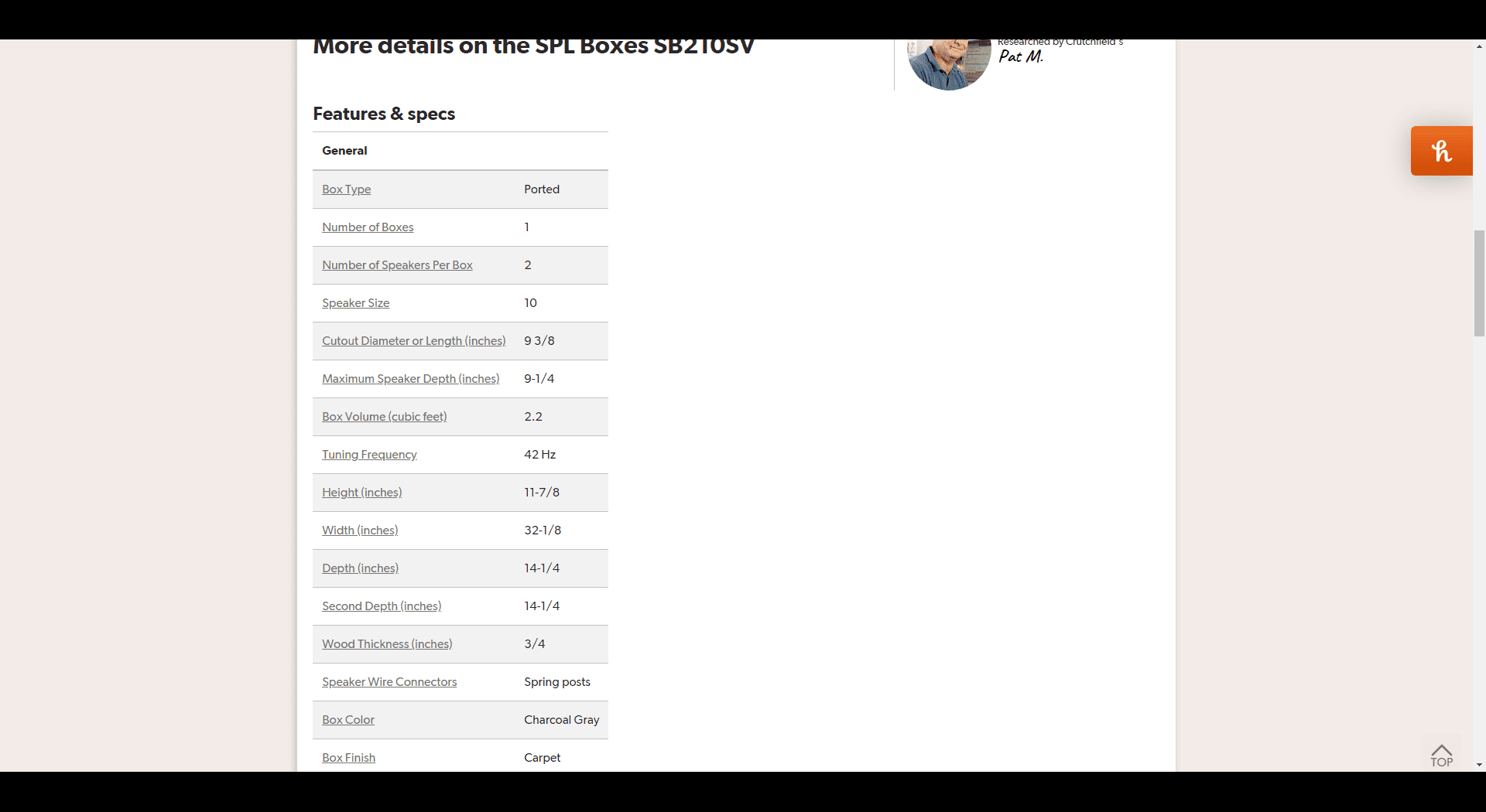

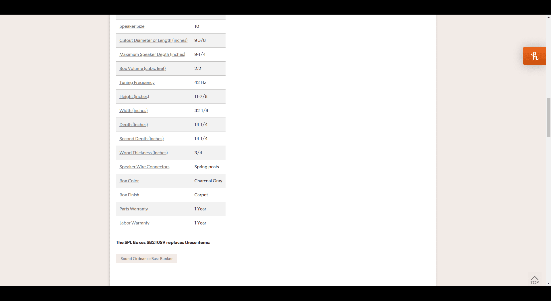

This is box #1 - Its a dual vented 1.1 cubic ft per chamber box. What sub would really hit in this box with only 1.1 cuft
The total box height is just under 12" which is perfect since I can't fit anything taller than 12" under the trunk lip.

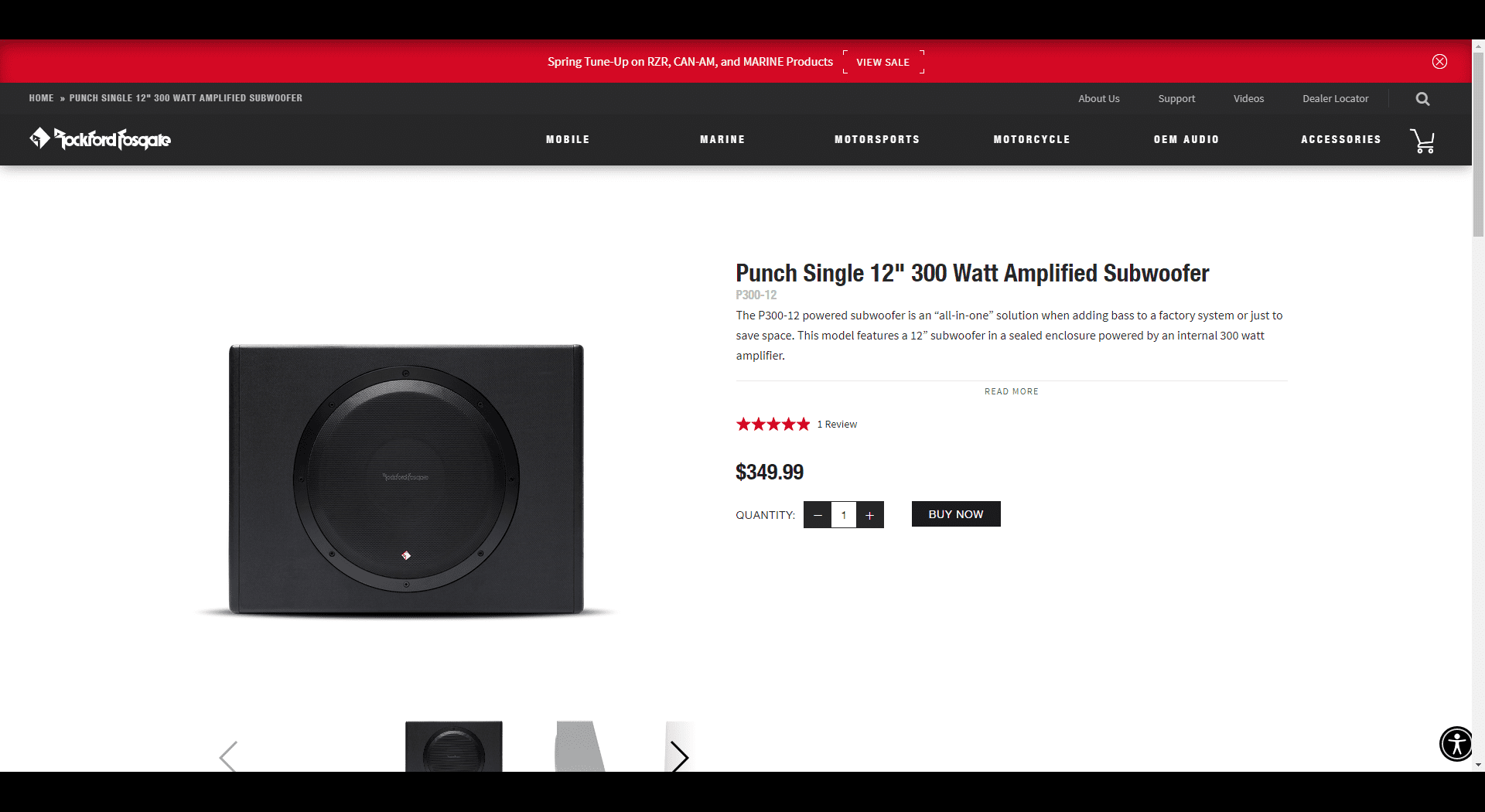

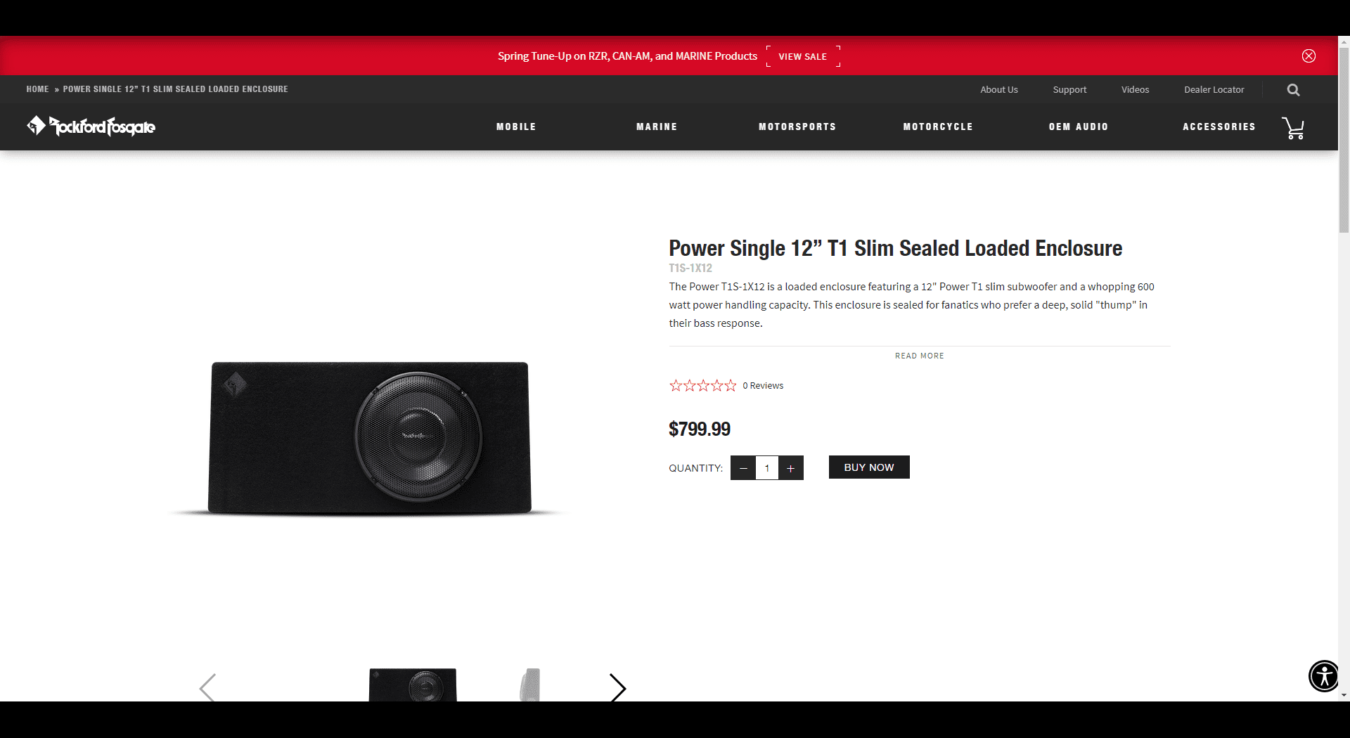

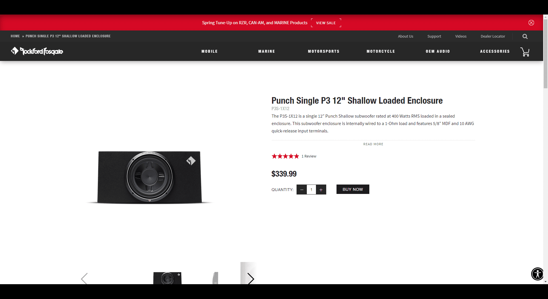

Here is my other options which local shops have suggested. With so many choices I am unsure which is my best overall choice for music of all genre's, but still primarily hip hop and rap.

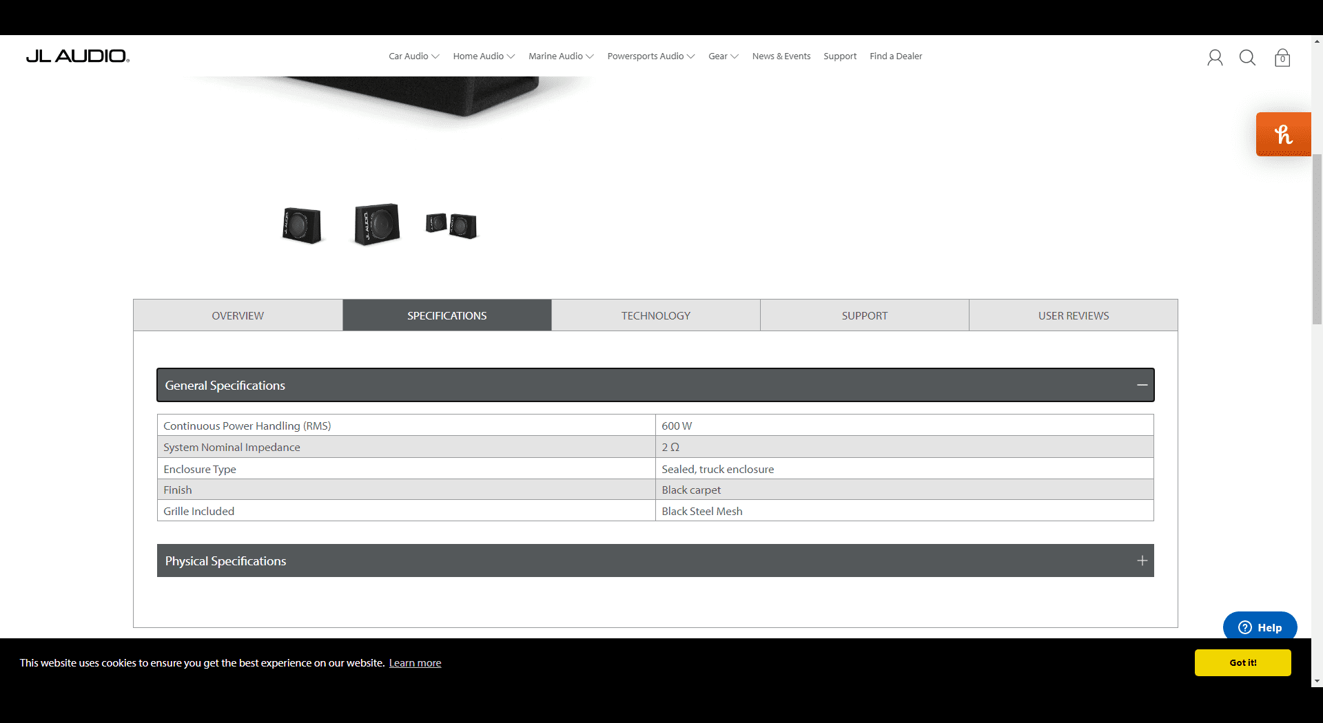

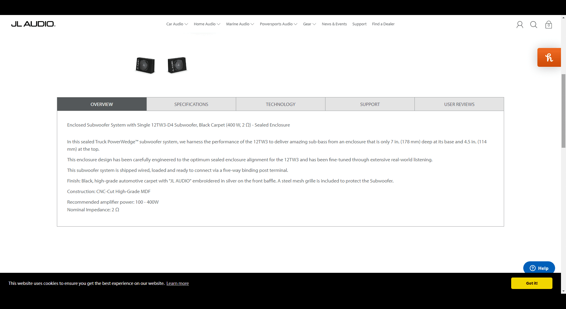

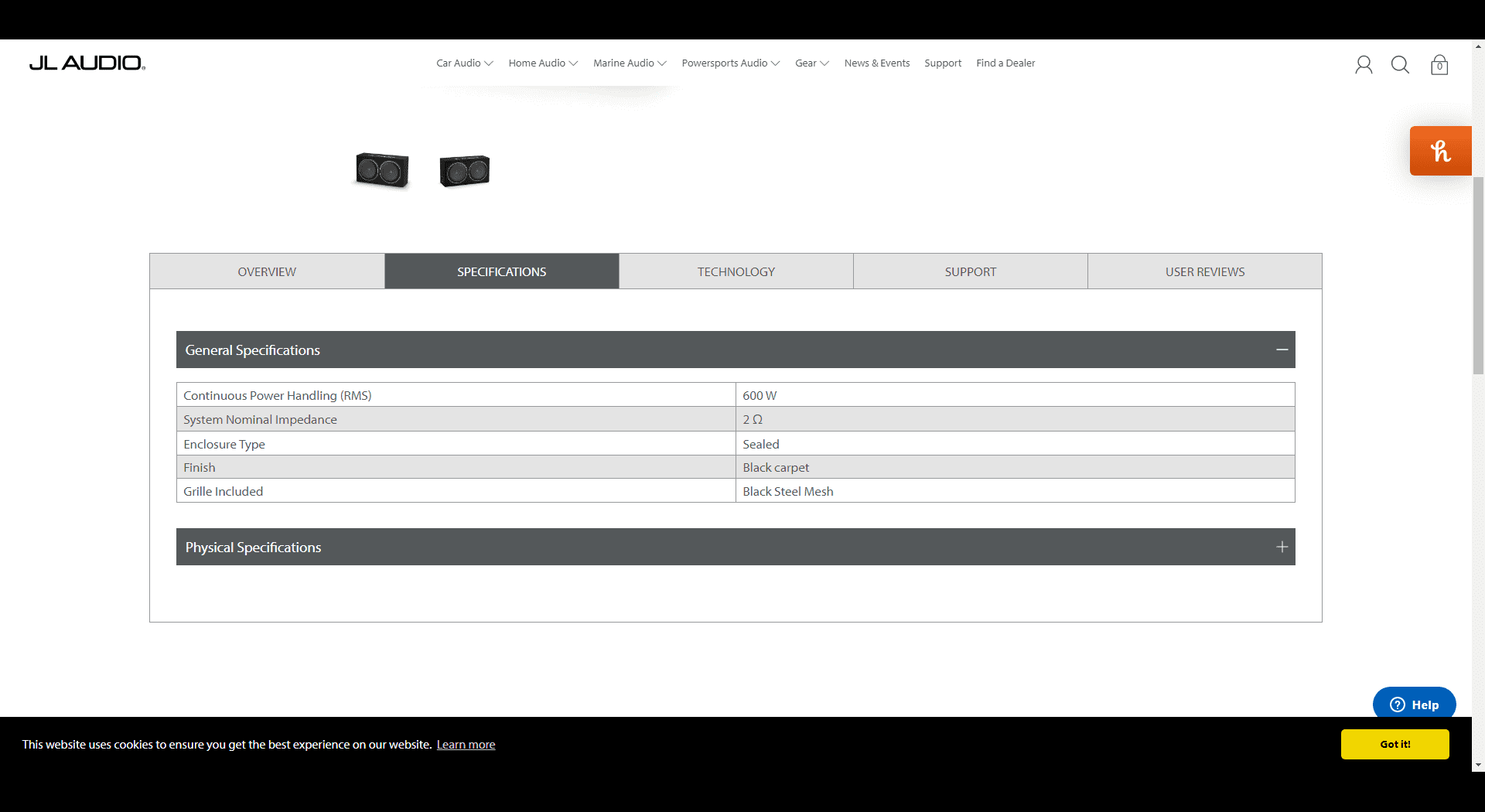

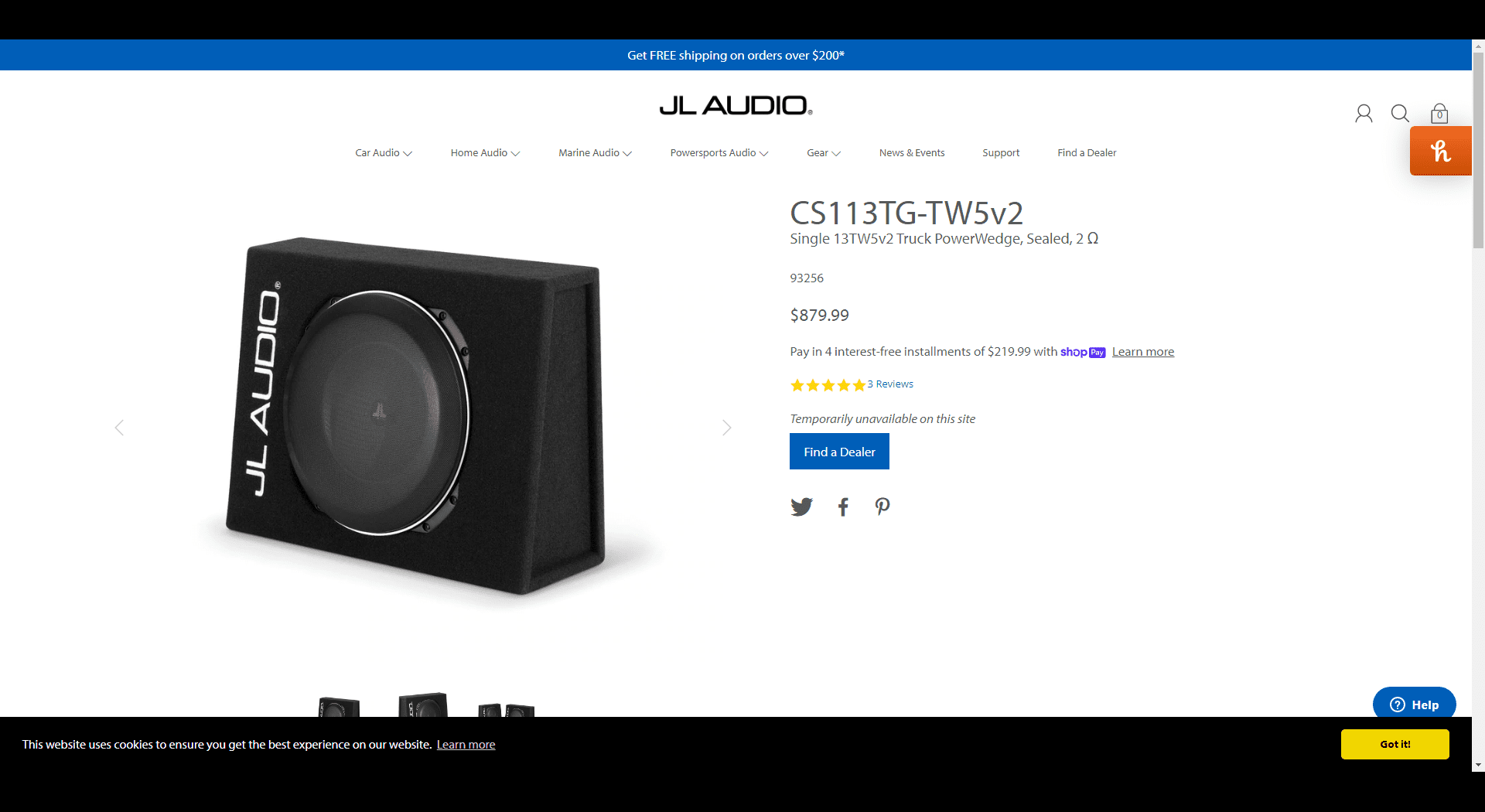

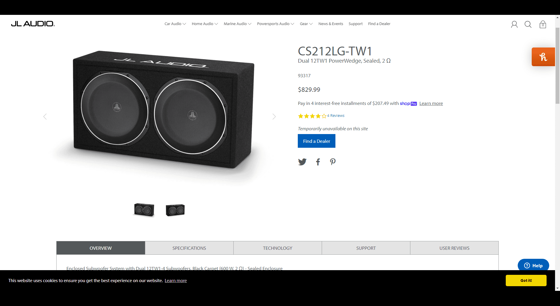

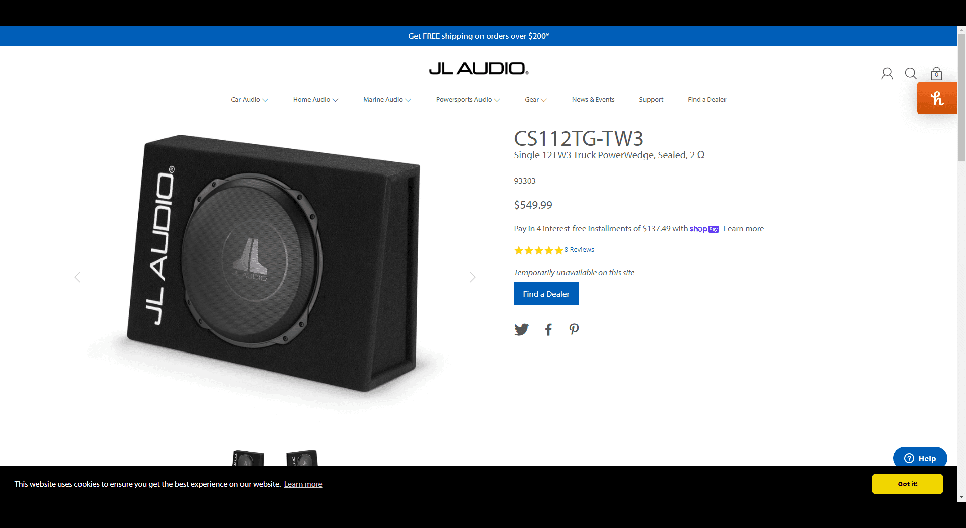

They also recommended a JL audio TW5 in a factory specd box as a best #1 overall option at my local shop. Would you agree here given all of the different box types shown above and the very limited space constraints of my vehicle.

Please know that I am not brand specific. I am open to all different type of options. I am just showing you all of the suggestions they recommended to me. With so many different choices I am truly lost on which is best for my specific setup while still giving some great bass for rap, rock, and hip hop.

They also recommended a JL audio TW5 in a factory specd box as a best overall option at my local shop. Would you agree here given all of the different box types shown above and the very limited space constraints of my vehicle. I can't fit a single box over 12" tall in my car.

This is the one I recommend. It only needs 0.8 cu ft sealed box. It sounds detailed and digs low for a flat sub. I had them hooked to a 750 watts amp in a Silverado's rear seat firing up. Lots of bass for 375 watts per sub. They also sound great at low volume. For comparison, I also have a pair of 12" sealed subs made by Robot Underground that sounded anemic on that amp. I had to disconnect one to get awesome bass out of that set. These are also in a 1.5 cu ft per sub, as opposed to the 0.8 of the TW5s. That to me is a testament of how good the JLs are.
I feel the Fosgate T1 might be comparable but I have never heard one in person.
I would run box #1 with a solid set of 10's. The SSA demons fit the bill as well as soundqubed H2's. If I wasn't rebuilding my old sub right now I would have purchased one of those 2.

That first box doesn't look all that bad assuming you own a couple 10" woofers that are meant to function in a ported alignment. Typically space makes bass so cramming too much cone area in too small box is usually going to lead to disappointment. That JL W5 in the prefab JL box would be rough on the budget but probably sound good.... for the amount of space it takes up. If you can spare more airspace you'd do better with a larger box.

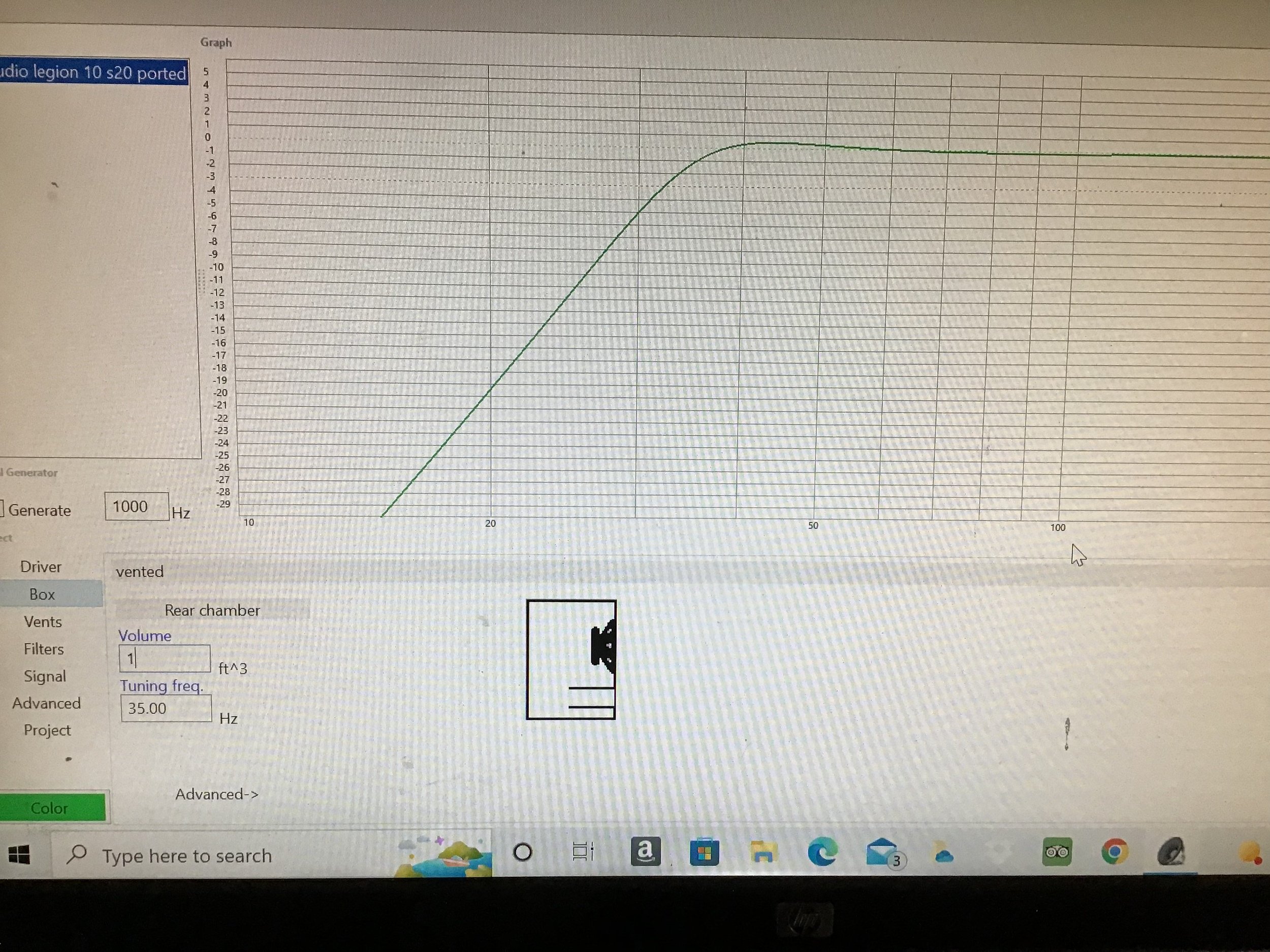

There are still some audio legion S20 10 inch subs for 52$ on liquidation at their website. 1.1 is a good air space for them, with a port tuned somewhere around 34-38 HZ. It’s a good sounding subwoofer for 52$.
I had it in 1 cube tuned to 35 HZ. I saved it in winisd. Sounded really nice in that box. A little low end hump with cabin gain gave it plenty down low. Cabin gain is not figured into this plot line.

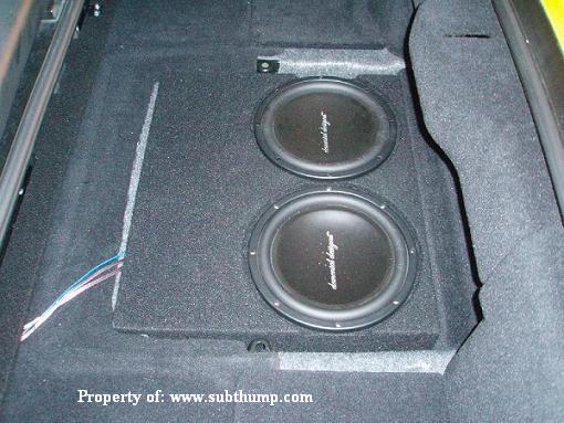

Forward firing partition box $219 subthump
Volume: .71 cu.ft. ea. dual or up to 1.4 cu.ft single
or .46 ea. for triple
max Mounting Depth: 6.75"
The configuration can be either a single 12, a single 10, 3 8's, or 2 10's.

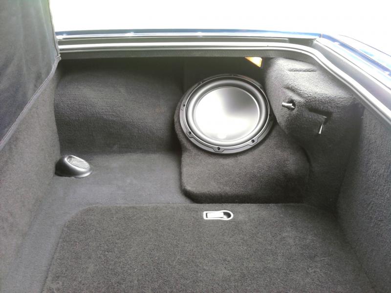

This is commonly called a flush mounted stealth box it has .85 cuft with a max depth of 7-3/8"
The configuration can be either a single 12, single 10, or 2 10's.

What's the mounting depth on that flush mount one? The ones in the corners are a bit too small and exposed for my tastes and the long one blocks off the entire area where the sound wave will want open to get any sound up to your listening position. Those boxes that block off the entire seat-back area firing into a trunk are all show and no go, would avoid at all costs. You might get away with a couple 8" woofers in those corner boxes but it can't possibly be worth the asking price. Flush mount seems a good option and you can keep it stealth and likely buy/build some sort of grill to keep the woofer protected.
Is there some useable space in the cabin? You're going to lose about 5-6dB trying to get bass out of a trunk and you could likely get the same effect at your listening position with much less subwoofer up in the cabin. Also you'll probably want to throw at least a little sound deadening around in your trunk if you mount something back there if you don't want to be driving down the road with your trunk buzzing like some common hoodrat.
Couldn't pay me to use another subthump box. I had one as a fill in in my Explorer till I was able to build the next one I used before I upgraded again. Biggest waste of money I ever spent on a box. They charge a premium for their boxes while using the cheapest materials.
For the kind of price they want contact a local shop and have them build one instead. Will be worth it in the long run and built to w/e subwoofer you decide to go with as well.
