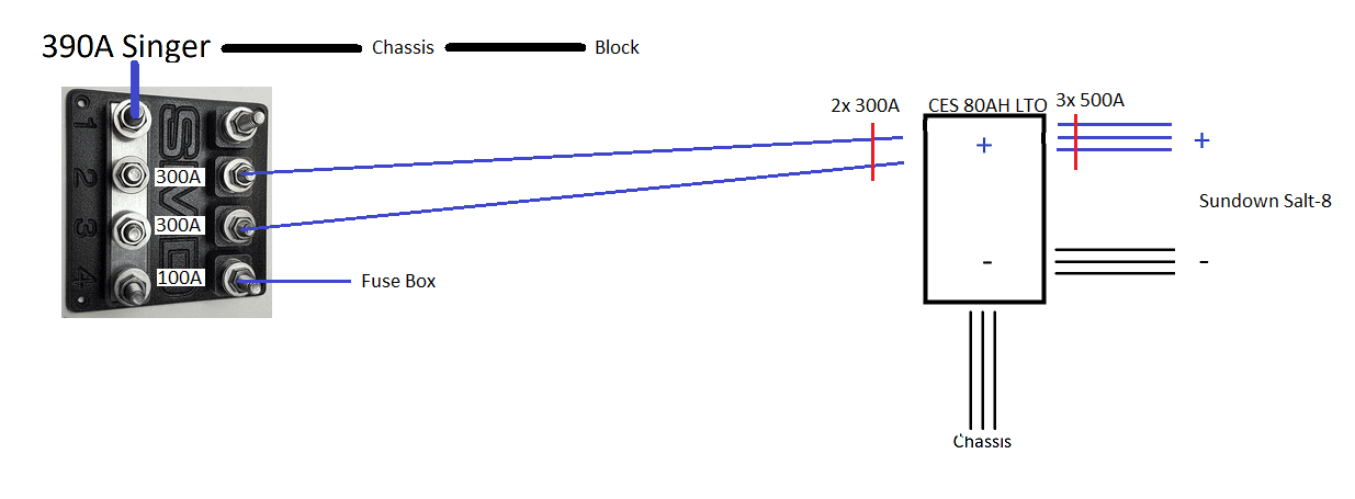

This is how mine is wired up (right side is the trunk). I just used a fuse block up front in place of a distribution block (why pay for both am I right). Your fuses will probably differ from mine. You can just take the factory ring terminal and connect it to the input of the fuse block (or output if you want redundant fuses like where my diagram says "fuse box", or chop off the factory fuse and add your own ANL fuse with the same rating).
I’m not that good with diagrams so it’s a little hard to understand that. So I could get a fused distribution block, take all four wires from my positive terminal and put it into the fused block.
What if some of them don’t need to be fused, should I still put a fuse in place or what do I do.
Also for the negative terminal there’s a ground wire and another wire leading to that terminal, should I just get a basic distribution block, a second one, not anything fancy and connect those wires

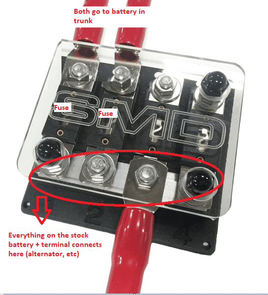

You do not need any distribution block. You will replace your front battery with this fuse block (or anything functionally identical) which will act as the positive terminal in the engine bay. The side of the fuse block with the numbers is the "input" which is where you connect the alternator hot wire. Everything connected to the factory negative terminal must be connected to the chassis/block, which becomes your ground up front.

(there will be one more wire connected to the input (or output with another fuse), the prefused one that you mentioned earlier)
I can elaborate further if needed. We could do a voice call too if that's easier.
If you haven't done something like this before it can be hard to wrap your head around it at first.

Just realized you probably will only need one wire going to the trunk battery because your alternator is less than 300A (max for 1/0 OFC).
