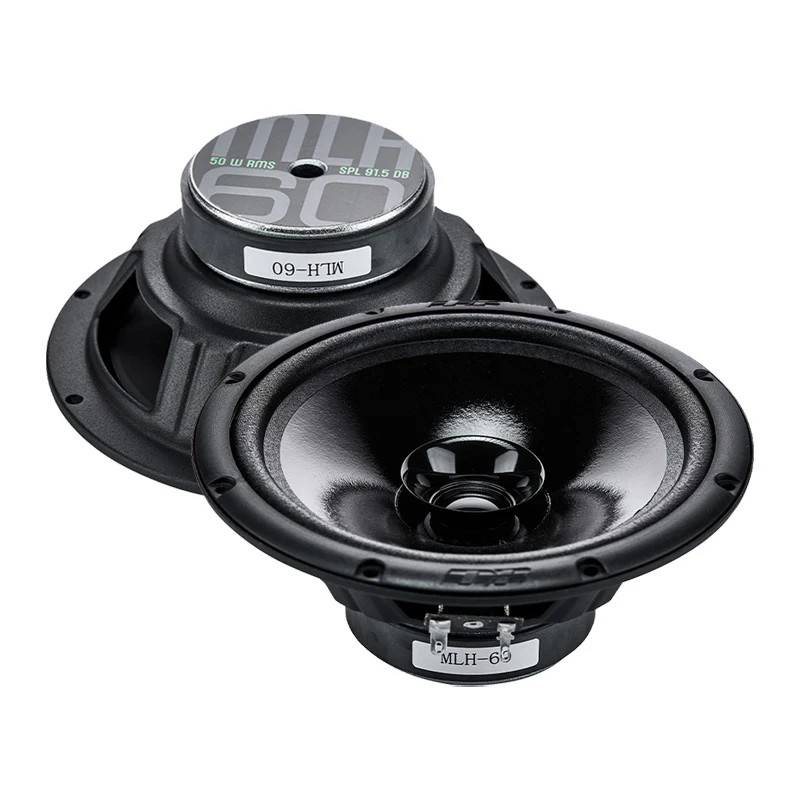

x2 Machete MLH-60 for the rear

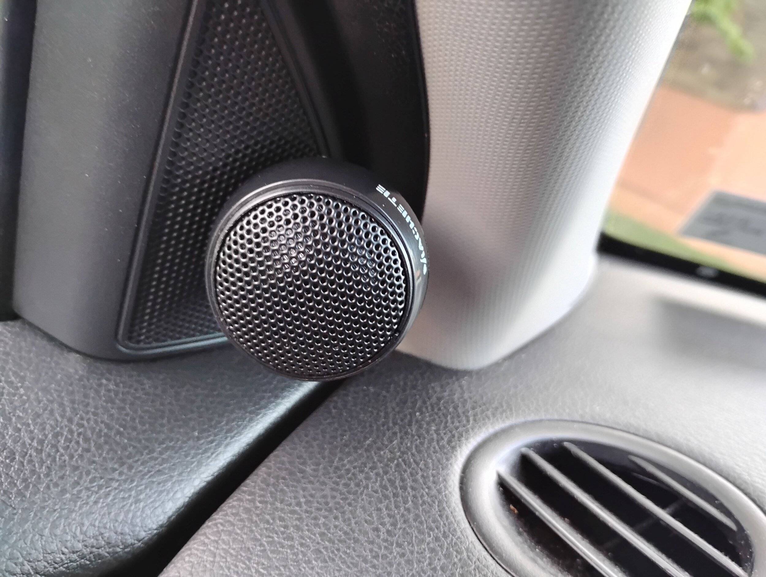

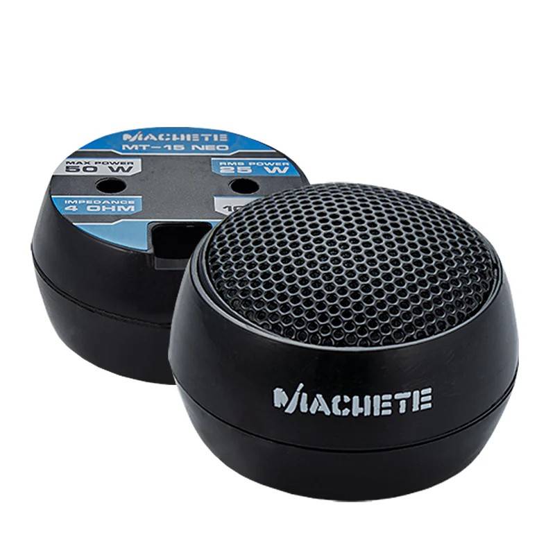

x2 Machete MT-15 Tweeters

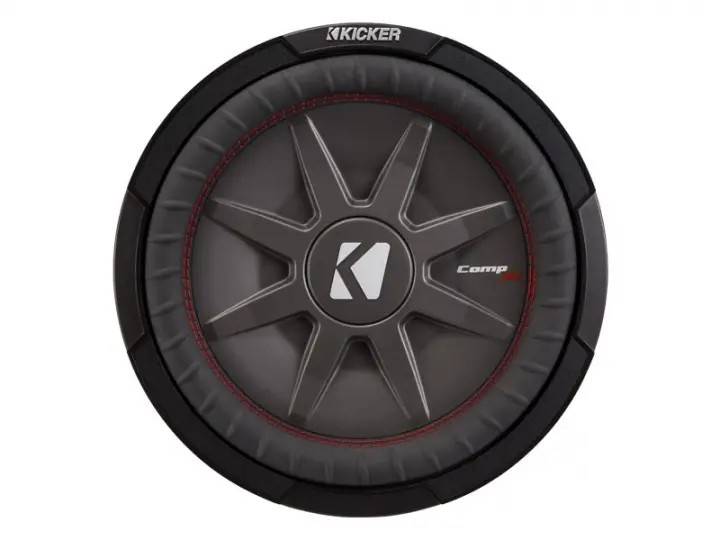

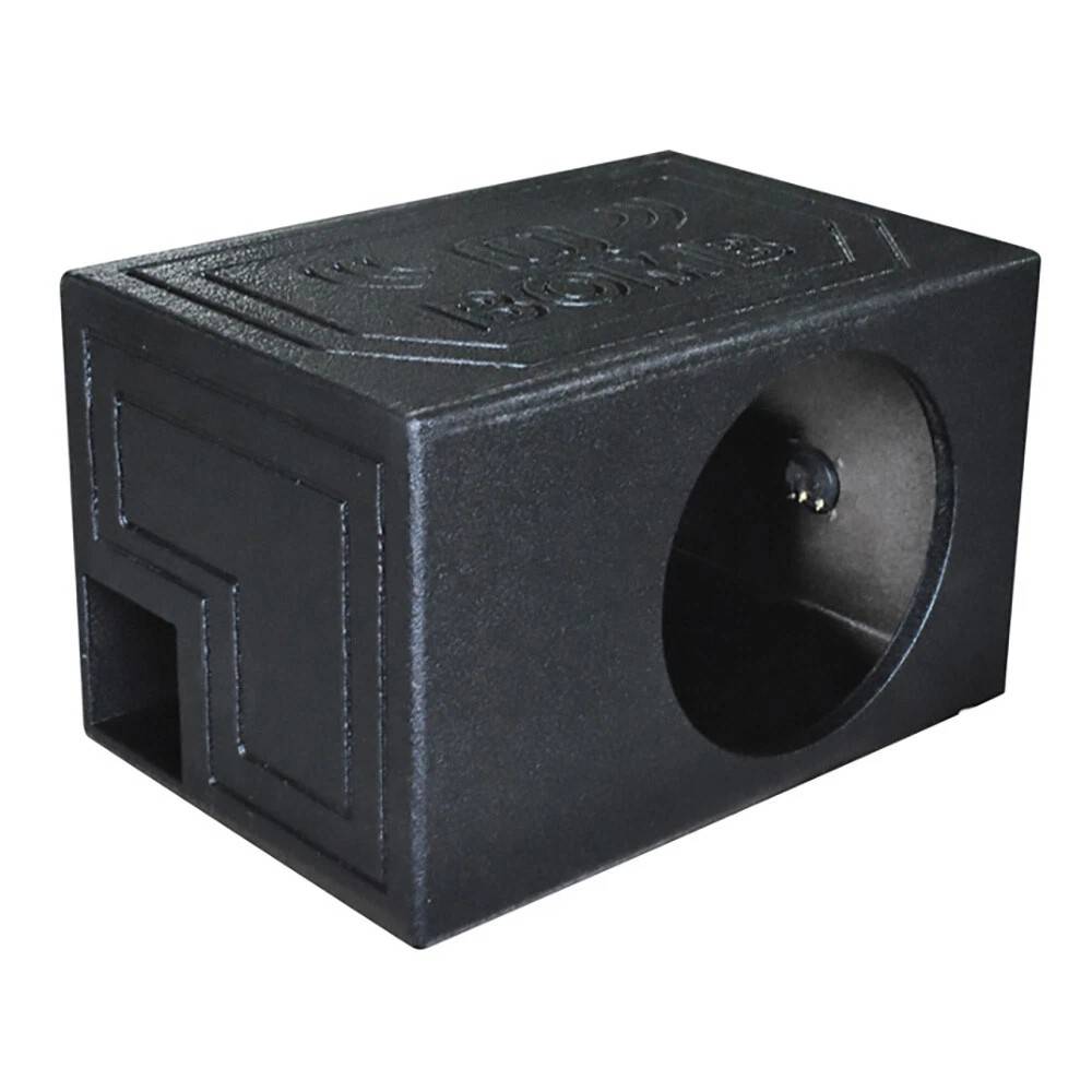

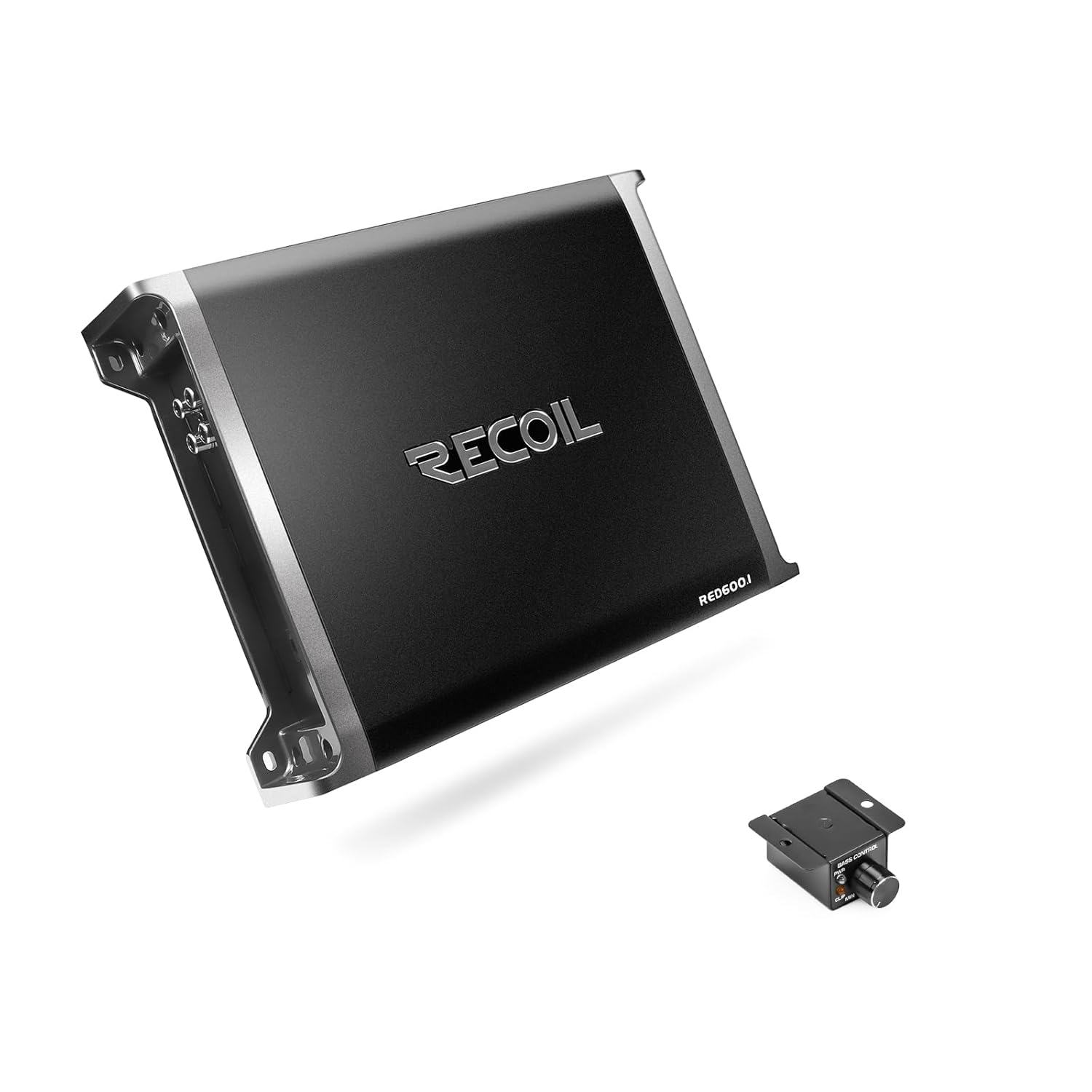

x1 Kicker Comp-R at 1ohm by a Recoil 1320 class D amp in a Q-Bomb single 12" enclosure

3. Tweeters: x2 Machete MT-15
4. Subwoofer: x1 Kicker Comp-R (1 ohm)
5. Amplifier: Recoil 1320 class D amp
6. Enclosure: Q-Bomb single 12” enclosure

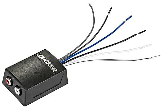

It's [possible, not really desirable.
If you think in terms of channels, it will help. 4+1 is 5, regardless if you use two 2-channel amps, and a monoblock or 1 4-channel and a momnoblock or 5 monoblocks, 5 channels any way you slice it.
I know that seems obvious, but I make this distinction for a reason,
If you split the initial signal to all 5 channels, all your volume control is based firstly on the single speaker leads providing the signal.
This means that you have to tune all the gains, every channel, to set the front/Rear, Right/Left as you like it, ahead of time, because you will not be able to adjust anything but R/L, no front-to-back fader at all.
Ideally, you want a 6-8 channel source you can adjust at your fingertips.
Now there are some multi-channel LOC's that have Bluetooth you can control from an app, or some that have a wired remote.
The best case scenario when you are using the factory head unit is to utilize front and rear sets of speaker leads so you have front to rear and side to side balance controls.
This would require two LOCs or one multi-channel LOC.
No need to get a 5-channel if you have the monoblock already; adding a 4-channel would be the same as having a 5-channel.
As for the Recoil 4-channel amp, consider spending $10 more and get the DI800-4. Set the gains conservatively; it will give you lots more power without breaking a sweat.
My rule of thumb is RMS plus 50%, and in your situation, the 800-4 is a no-brainer.
Here's a good buy for a LOC.
Another excellent option:
At the end of the day, you can split the signal off the 2-ch LOC 5-6 ways; you just have to tune everything for balance ahead of time.

I appreciate all the solid info in helping me choose all the right equipment because my OCD overwhelms my thought process sometimes...The multi-channel LOC is definitely the way to go along with the D1800-4.

The biggest problem I'm having now is finding speaker adapters that fit my ride because based on what Crutchfield and every other search that came up recommends a 6.5 in all doors. Well there all wrong!
#1 The speaker size is 5.25" not 6.5"
#2 The basket width of the MBR-61LE and MLH-60 is 146mm (oversized I guess)
#3 The Speaker Adapters basket width is a max of 135mm
#4 I went ahead and ordered a set of rings that should fit and just do some DYI drilling and modding.
Hopefully the rings thickness will keep it far enough away from the window

As for using the 6.5's or the 5.25's of the same model speaker, just set the HP filter for the smaller ones at 10-15hz higher, around 85-90 Hz.
