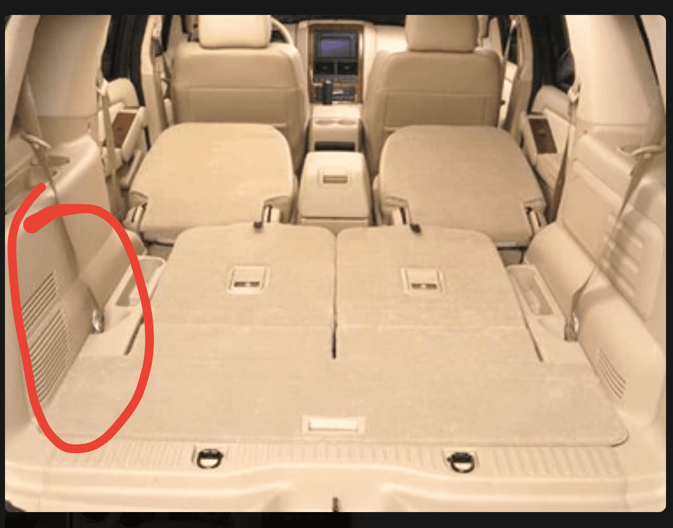

Does your Explorer have this?
If yes, then maybe you can McGuyver some enclosure inside there.
