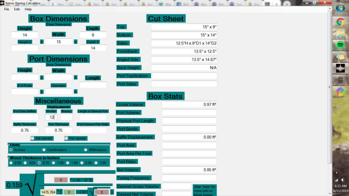

if you can do that much space then yes a 12 is fine use all that space though dont go any smaller.  Just because the 12 says you can go as low as .49 doesnt mean its the optimal for the sub, you can get deeper bass response the bigger you go. From my graphs it actually shows .833 cubes to be the most accurate response with a QTC of .707 the numbers you posted is .97 cubes subtract the space the sub takes up will be right around .85 net cubes which is close to perfect.

I measured again and am going with the 10" Dayton HO DVC and found this smaller ported box.  Would it sound good?

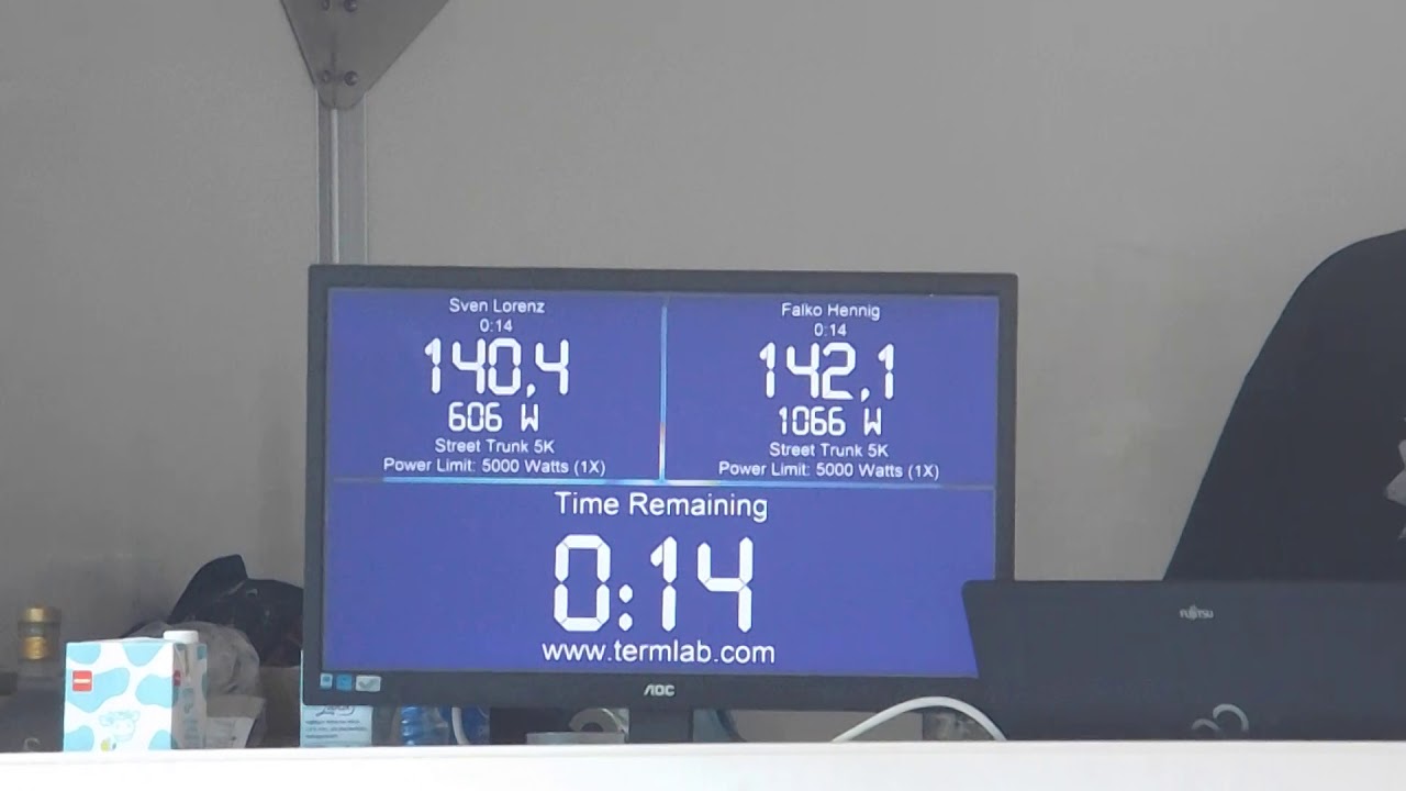

The taramps is definitely an option if size is a factor. Not sure why you are so hesitant about that amp. You can do the md 1800.1 instead if the 3000.1 number scares you that much.. This is the md.1800.1 on an amplifier dyno testing for true RMS wattage at different levels of THD.
Again this is full tilt testing, you dont need full tilt power, you literally can just set it for 600-800 rms from adjusting it with the gain knob on the amp. It wont affect your vehicle electrical system at all you ARE NOT going to draw whatever current you think the amp is going to draw, real power world numbers on music are WAAAAAAAAAAAAAAAAAAAAAAAAY less then you can ever dream of. Purely due to physics, there's a thing called impedance rise, even when wiring to 2 ohms, you wont be getting 2 ohm power out of the amp, your actual power numbers are around 4 ohms numbers because of how a coil of a subwoofer moving through the magnet works, your impedance is always way higher. This is why you need a lot of headroom power, you arent overpowering anything you are actually just getting proper RMS power for your subwoofer.  Most normal people like you cant grasp this concept because you guys have never clamp tested your amps for actual real world RMS wattage when you compete in audio competitions where you are in restricted power classes where you cant go over a certain amount of RMS wattage.
These guys were using 2000-2500 rms amps and their real world power is as you see here. Its not the amps are bad, its because of impedance rise, its actual physics limiting your power. This is why some people buy stout korean board amps and wire down to half ohm or 0.25 ohms to get more power out of the amp and the amp runs just fine and dandy while putting out huge power.
