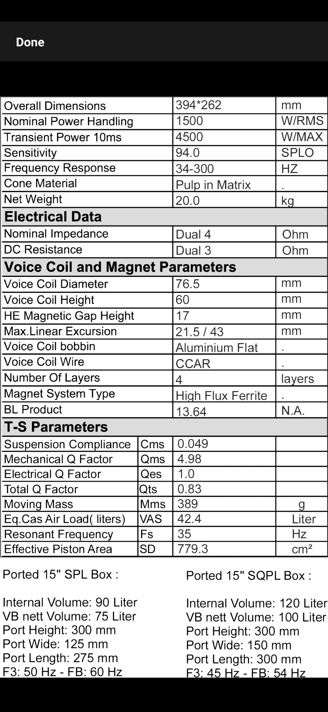

Do you know the specifications of the box. I found this spec sheet for your sub.

Do you know the specifications of the box. I found this spec sheet for your sub.View attachment 49706

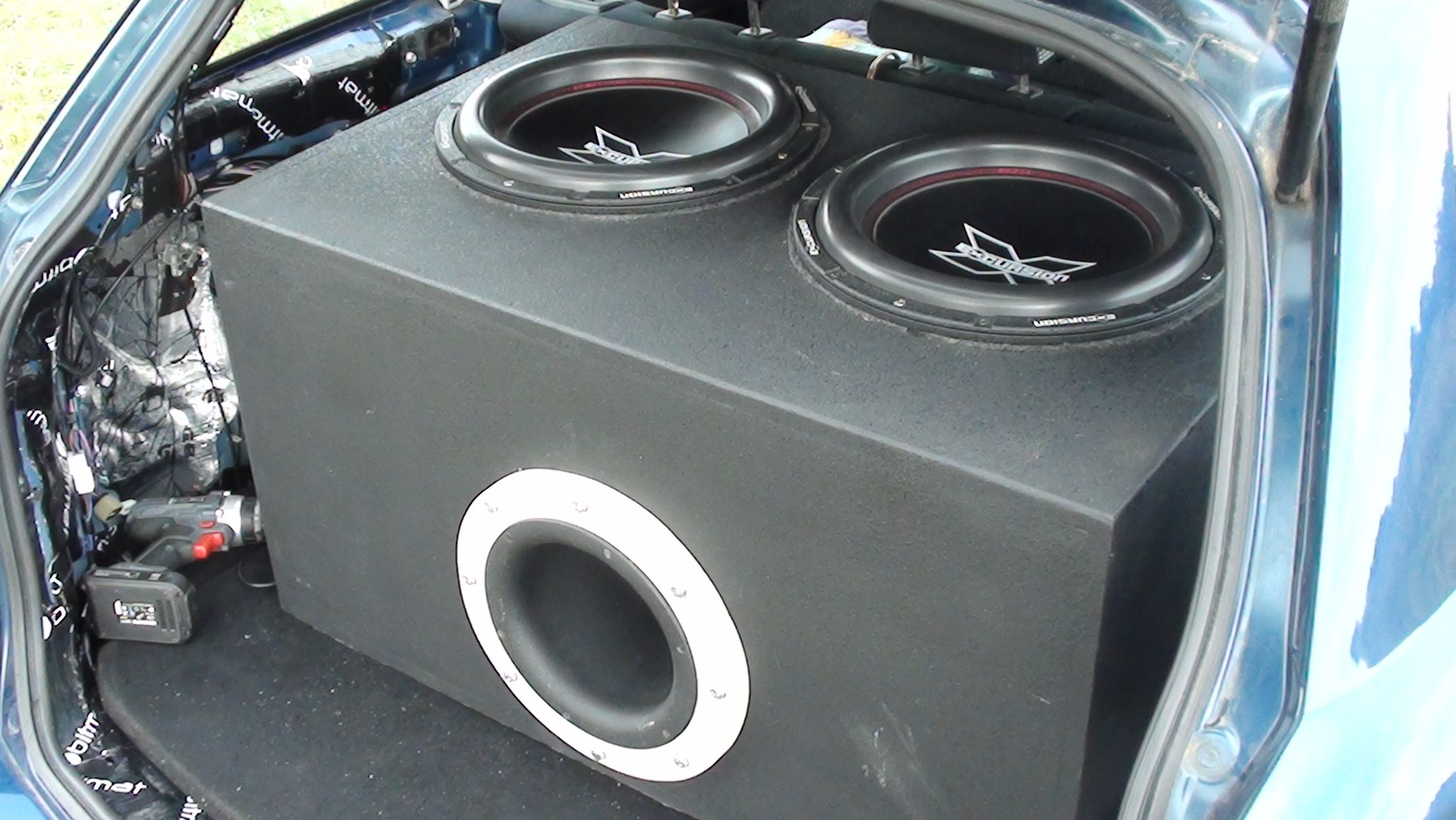

My box for xion 15 is about 110L netto and 35hz port tuning 8' aeroport
Excursions subs is about 200l netto and 33hz port tuning with 8' aeroport, (I can change ports to get 25hz tuning, and 40hz tuning)

Wait, the spec sheet I posted above is for these 15" SX X-Ion. Is the current box close to those specifications?
BTW, nice set-up, very clean. On another note, wagons are awesome for bass systems.
According to the manual, you need a 70 square inch port per sub. The 8 inch aero port has 50.24 square inches.
Port length should be 11.8 inches long.
To Audio system Xion 15, No manual on net, On sxx 15v2 box is made for subs, yes port too small :/ but I don't think that's the reason (my friend have **** low quality subwoofer, but its play better for sound quality). If in another car the same equipment will be able to sound better.
However, I will look for the cause of the car's electrics
One note wonder box??? Try plugging the port and see what happens.
