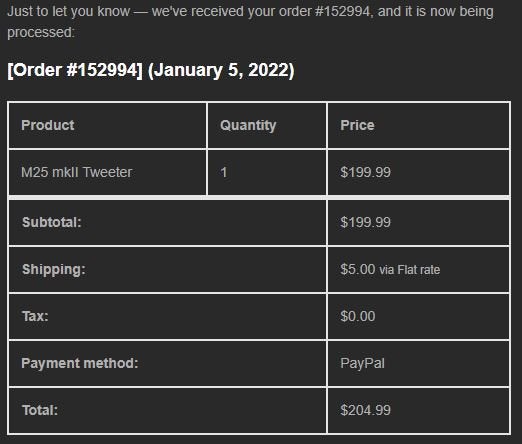

I started doing this because I mistakenly routed my midbass output to my tweeters during a tuning session. My mistake popped a pretty expensive tweeter. Now I have protection caps set for 1300hz where as my dsp is set to 2500hz
Replaced them with DD a series ceramic dome which I honestly like more.
