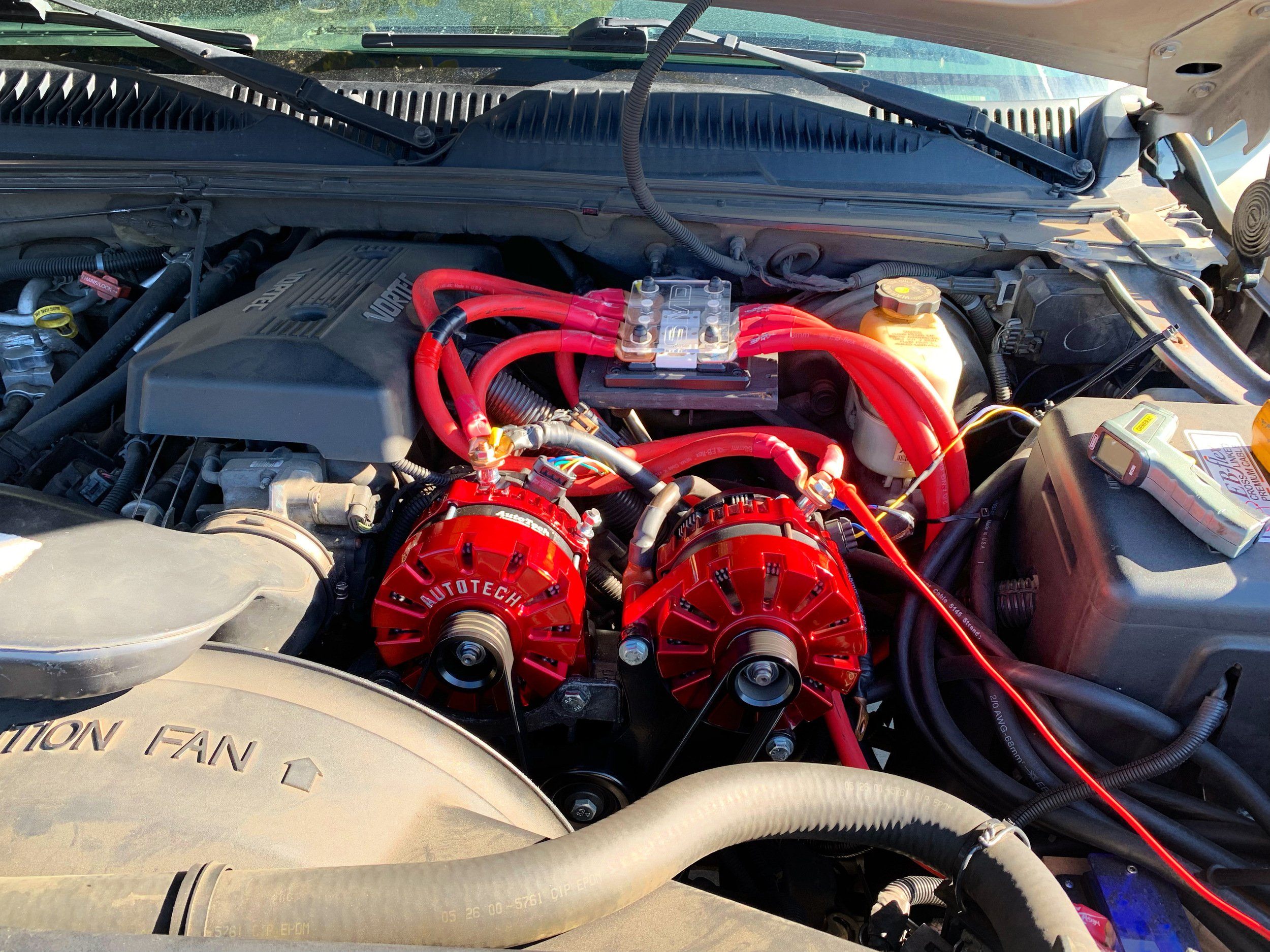

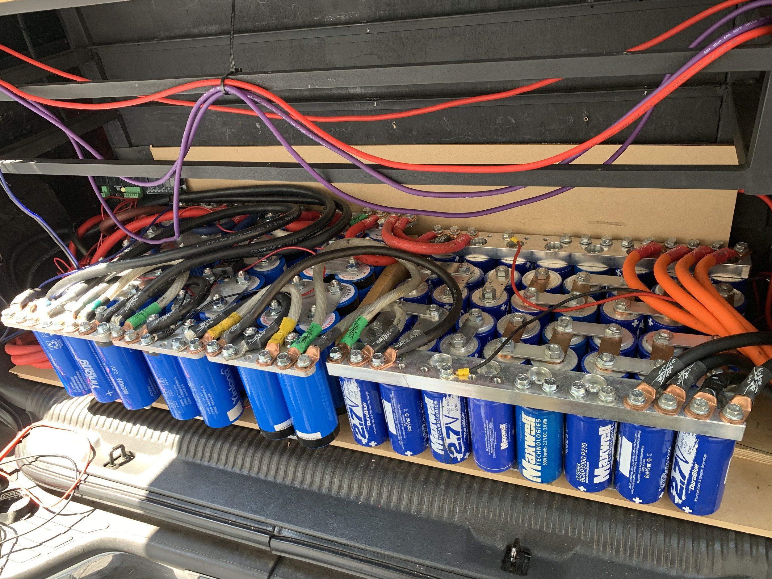

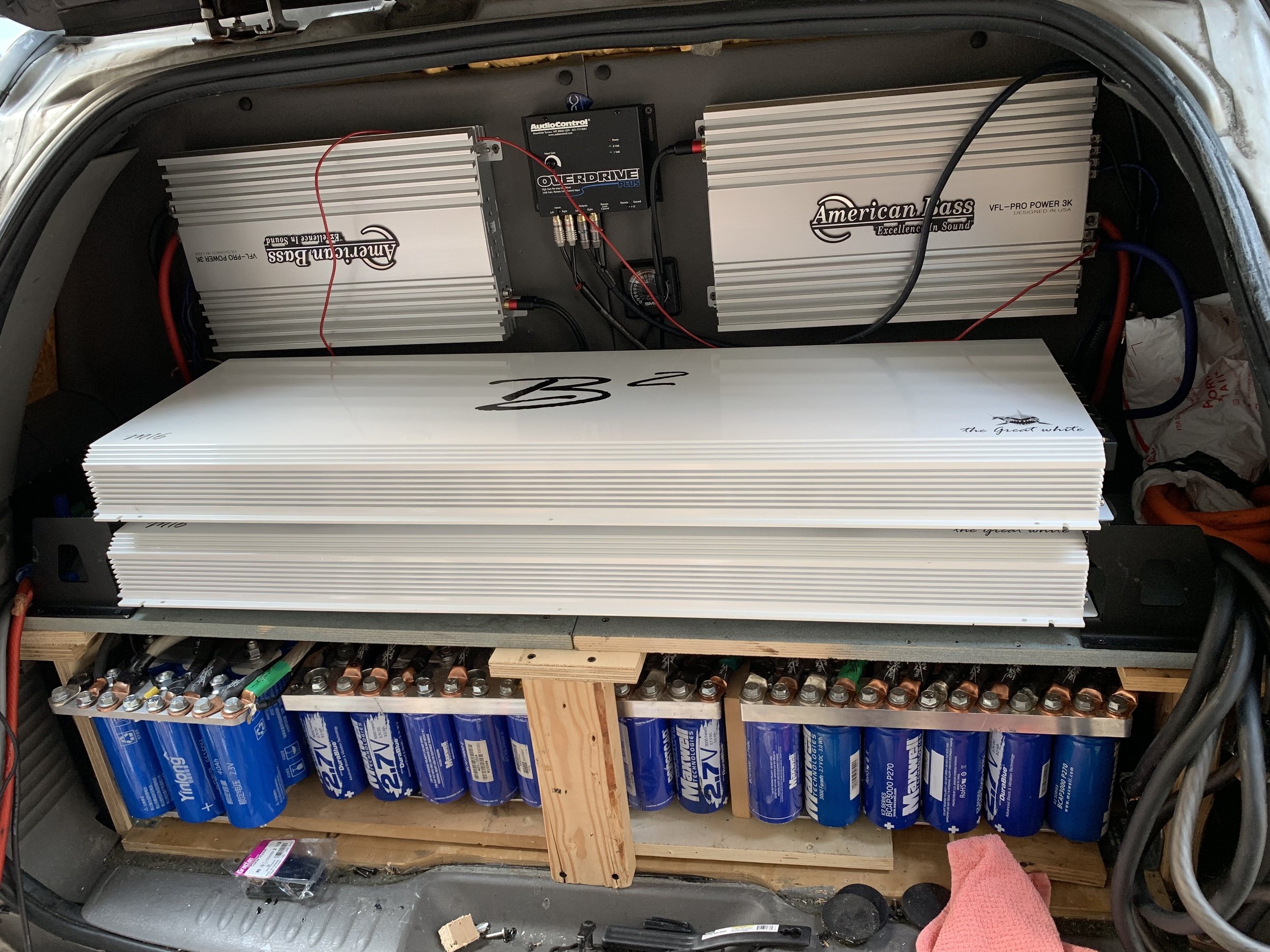

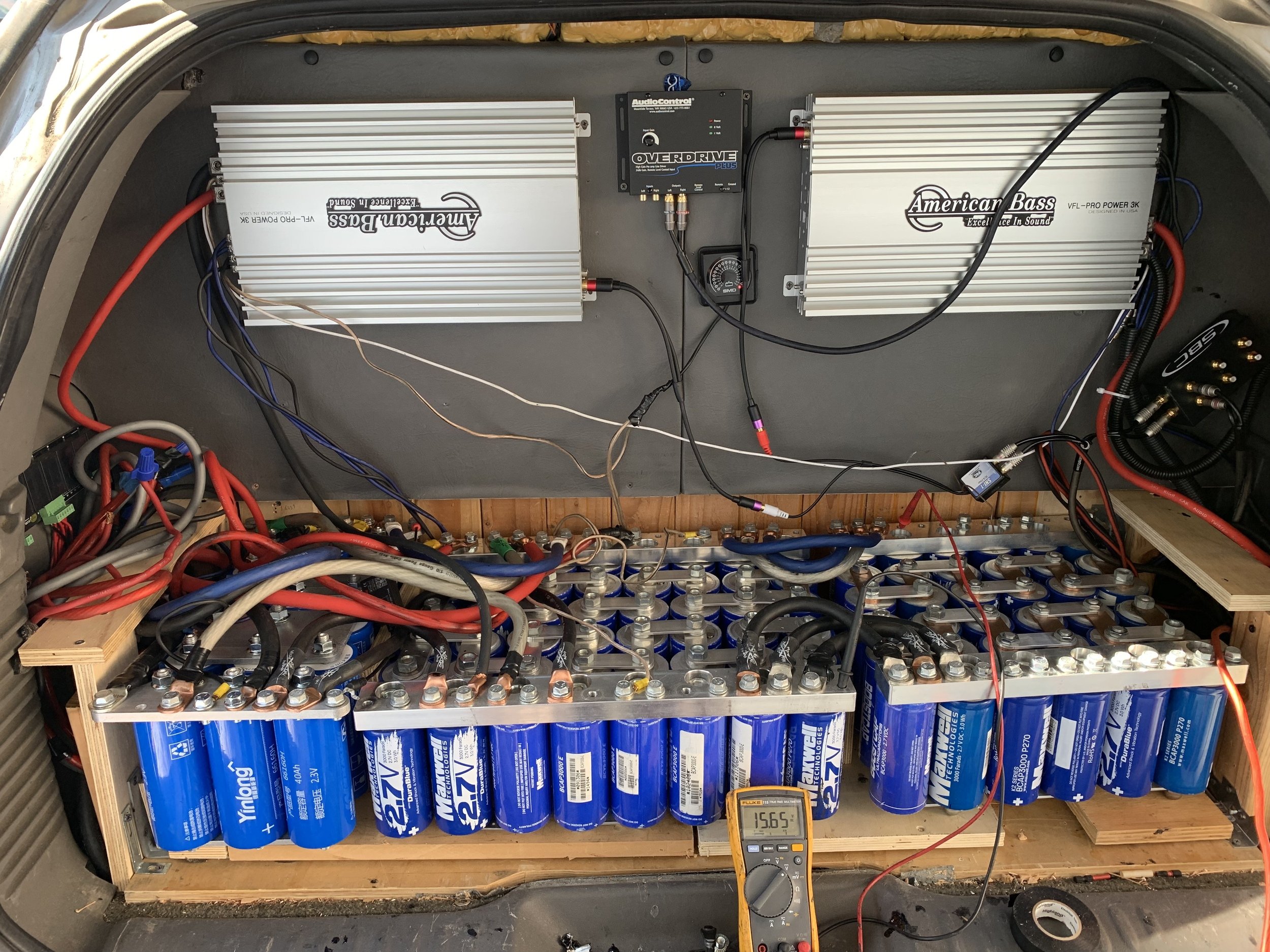

My current setup…2 370 amp alts ,260ah of LTO and 8banks of Maxwells

I’ve personally tested all scenarios….lithium and caps together works better then lithium alone…no battery has the discharge capabilities of caps…both together is magic
