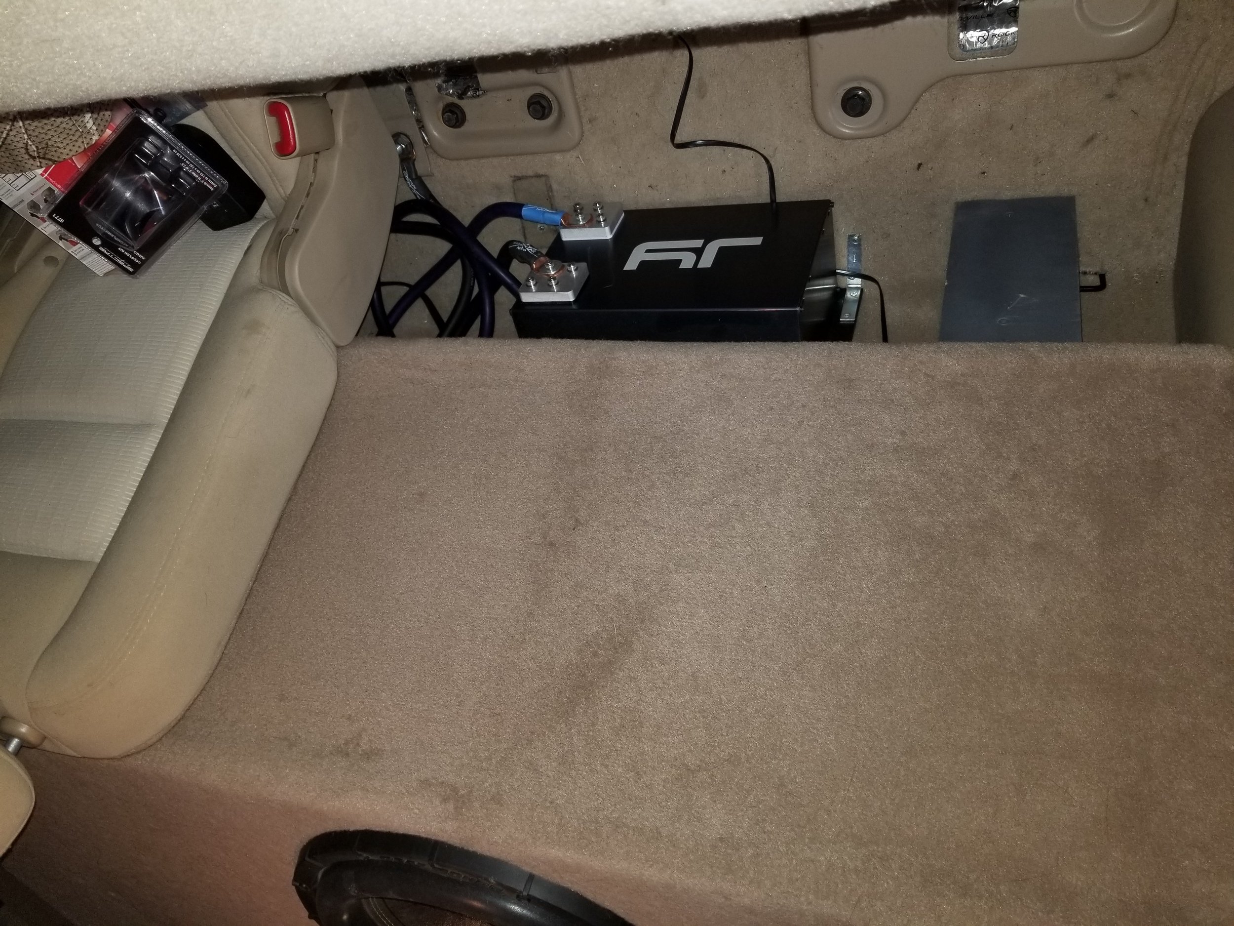

Here's my jy hp40 hiding under my rear seats.
The rest of my electrical is a 320a Iraggi and a Napa agm under the hood.
