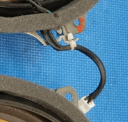

Your terminology continues to confuse me with "main leads" "termination points", etc. I'm trying to deal with this in simple terms, so let me restate simply:
These rear speakers are components and although they are physically attached via the bracket they each have 2 wires coming out from them which are all 4 going into a quick connect wiring harness. It is hard to see in the pics, but this should show:
You can see there are 2 bundles of 2 wires that are then wrapped, but you can see the 4 wires on the quick connect.
The other side of the quick connect that is coming from the amp also (obviously) has 4 wires going into it.

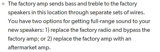

The blog post I have linked multiple times (and will link again):
I think he is pretty clear in stating what the exact issue is and showing that he has to clip the tweeter wires from the coaxial speaker so they can be run into the 2 wires on the pigtail above that carry the tweeter signal, while running the other 2 wires from the pigtail to the main connectors on the coaxial.
I don't mean to be obstinate here, and I'm not trying to pit my knowledge against yours, I'm trying to show what someone else (who at some point ran a blog about caraudio) is saying about my exact same scenario.
For what it is worth I went to like 4-5 audio places over the past week and some of them start out talking about how simple it will be, but when I show them the setup and press them to it, they all appear to concede that if you wire a coaxial up directly you will not get the full sound.
Finally, I'll note that your chat with Crutchfield you seemed to be focusing on the front door and dash speakers. This whole post has been about replacing my rear deck speakers.
EDIT: Just adding on another confirmation from this video:
same video jump ahead:
Really best if you watch about 3 minutes from the first link to get the whole explanation, but at the least click the second link and watch about 1 minute where he clearly explains the wiring he is doing is only because he is replacing the factory amp and if you are not replacing the JBL amp you have to wire them separately (i.e. use components, or do the trick with splicing the wiring off the coaxial tweeters like the blog post).
So again, there is just too much other information contradicting what Crutchfield states by people directly working on these cars.

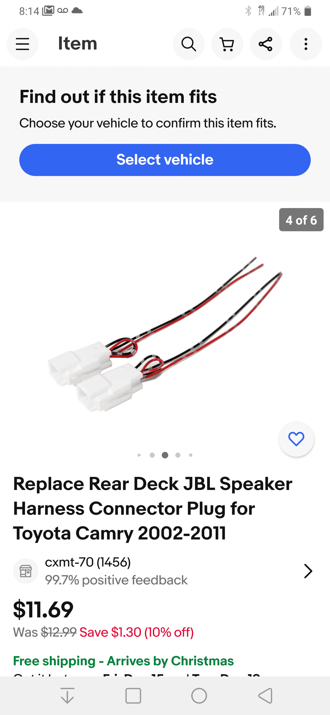

If you do
If you do not want to clip your original harnesses, you can use these. Or they at least show the speaker polarity.
Sadly I can't go with those. If you look at them they have looped the wires so they are only 2 wires coming out. These would only be used with the standard OEM system which has only a mid in the rear. They won't work with the premium JBL system which needs the 4 wires.
I've looked high and low for a 4 wire version and can't find it. I suppose I could try to rewire these to fix them, but I don't know the type of connectors and how to recrimp them solidly inside. I suppose I could just snip them and solder another wire onto them as well. This might be an option and would allow me to try and re-sell my current speakers for someone else that might need a working one.
