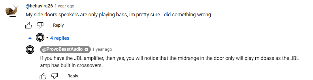

How does he contradict himself? He installs coaxial 2-way in the sides, but in the prior video he explained that he was doing coaxial because he was replacing the JBL amp. Additionally, in the JBL system the front door speakers are only midrange speakers to start with, so it doesn't matter if he uses coaxial and only wires the 2 wires because that is all the door had to start. This is, I think, even confirmed in the comments:
Well, he says that you have to use the separate leads indicating the amp is used as the electronic crossover. Then he uses the inline crossover in the door installs, that's contradictory. One suggest electronic dividing networks (crossovers) in play, the other passive dividing (crossovers) in play. You don't use both for dividing frequencies between mid woofers and tweeters. Please, nobody bring up active/passive hybrid applications, they are not applicable here. ;)
it's starting to sound like Greek to me again - but I'll just stress that what is is doing is:
a) because he already replaced the JBL amp with a different one as he discussed in the first video. You can't view that video on its own, it is meant to part of a series on replacing the speakers.
b) he doesn't care if he only gets the one signal to the 2-way door speakers, because it was only a single speaker before so he will either get the same signal he did before (if he kept the amp and original setup), or if he replaced the amp then he would get the full signal it seems. I would take his clarification in the comment I linked above what he might have said in the video, since it was an answer to a very specific question.
