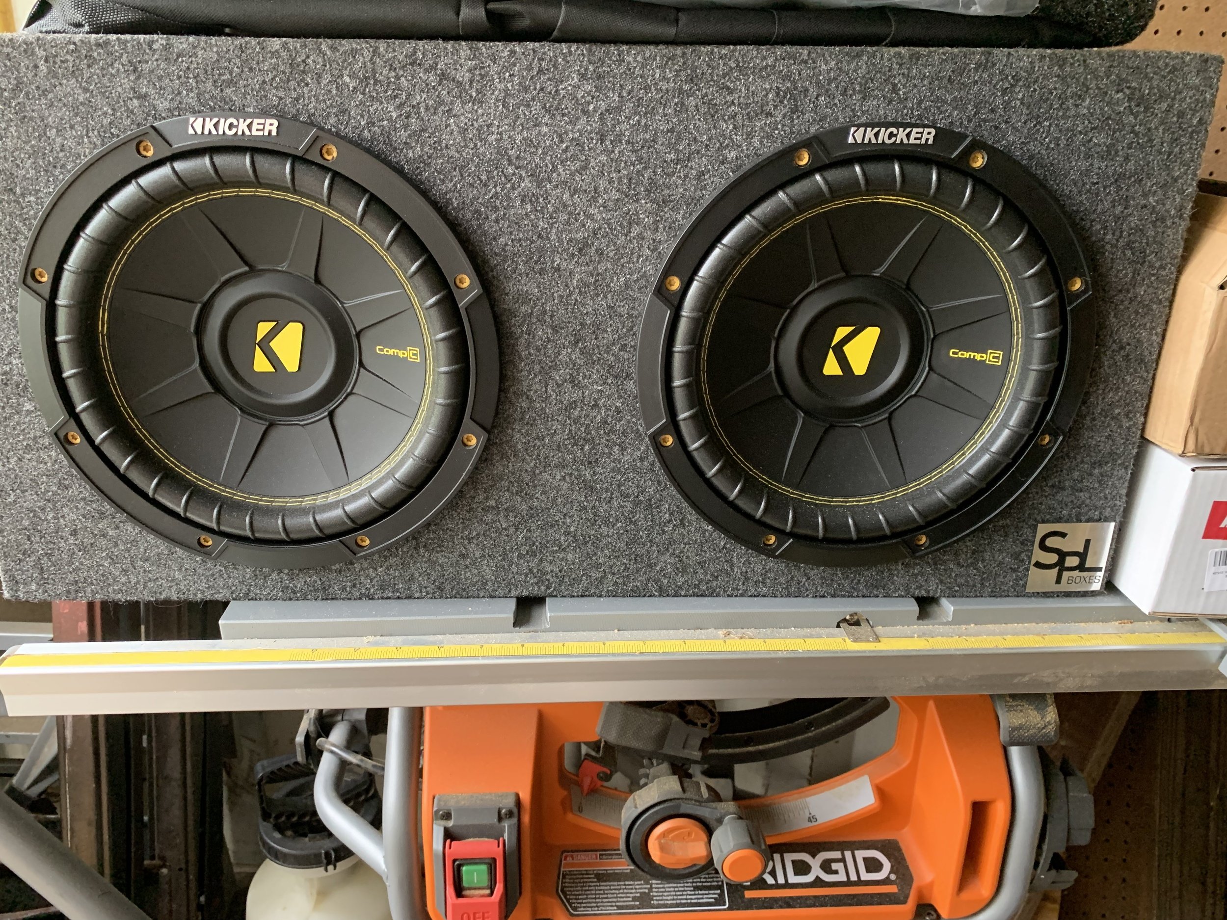

Is your sub box sealed or ported? Pics would help.You have just 4ga supply wiring? That amp already has a 100watt onboard fuse. Id run the amp you have, Remove the rear deck speakers and wiring from those. Spend the money on this sub and put it in a 2.0cu ft enclosure tuned to 32 htz sub rear port rear. Leave everything else alone for now,Sounds like you want more bass.This sub in the enclosure will Tank all over those two subs combined,Your car will flex pretty good and will fill the cabin space pretty nicely with those rear deck speakers out. Other than that.. Be time to do some electrical upgrades to keep up with adding another amp/amps and more cost.

will the amp i have now, do any good on this sub or cause it to overheat?

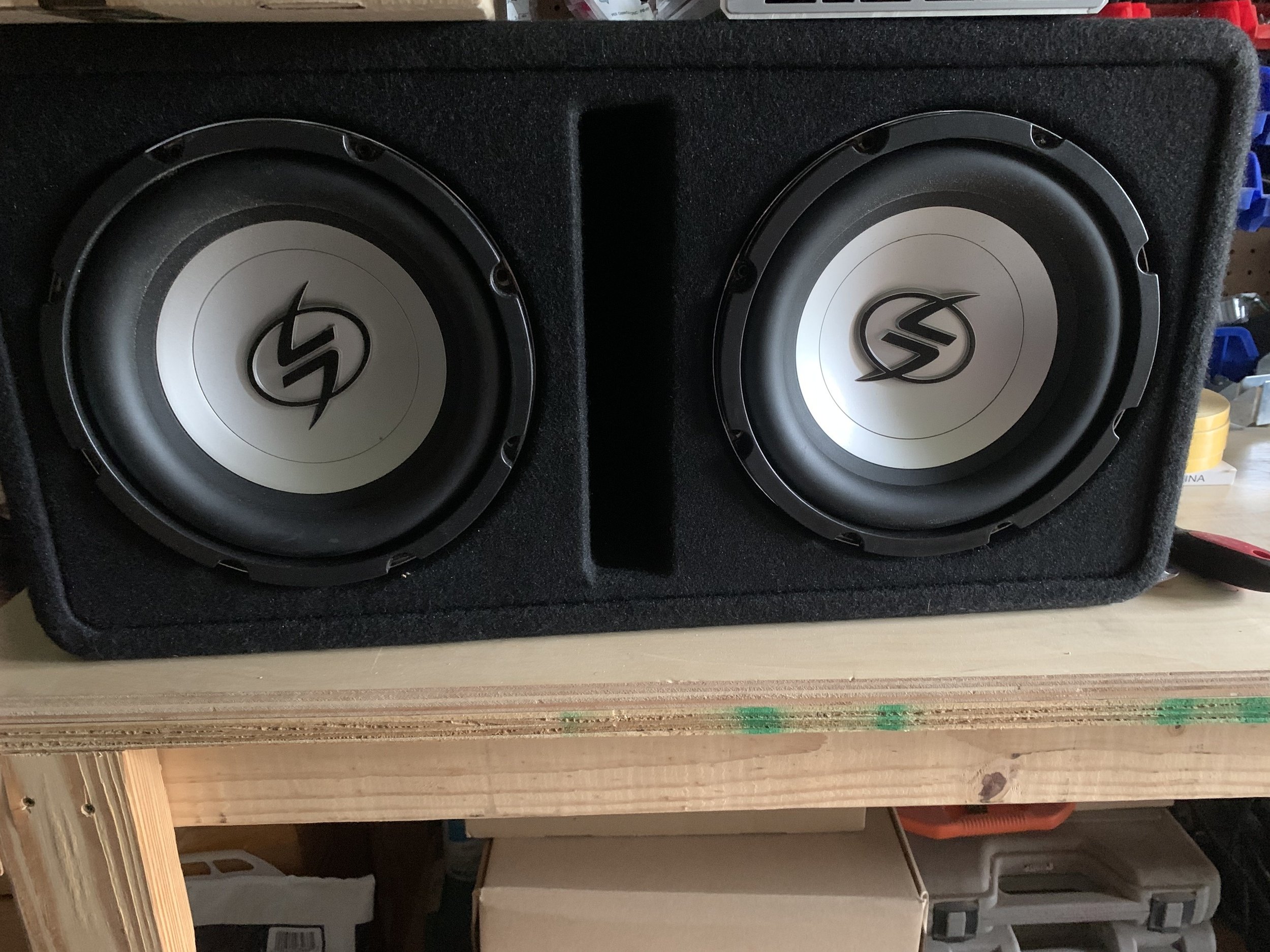

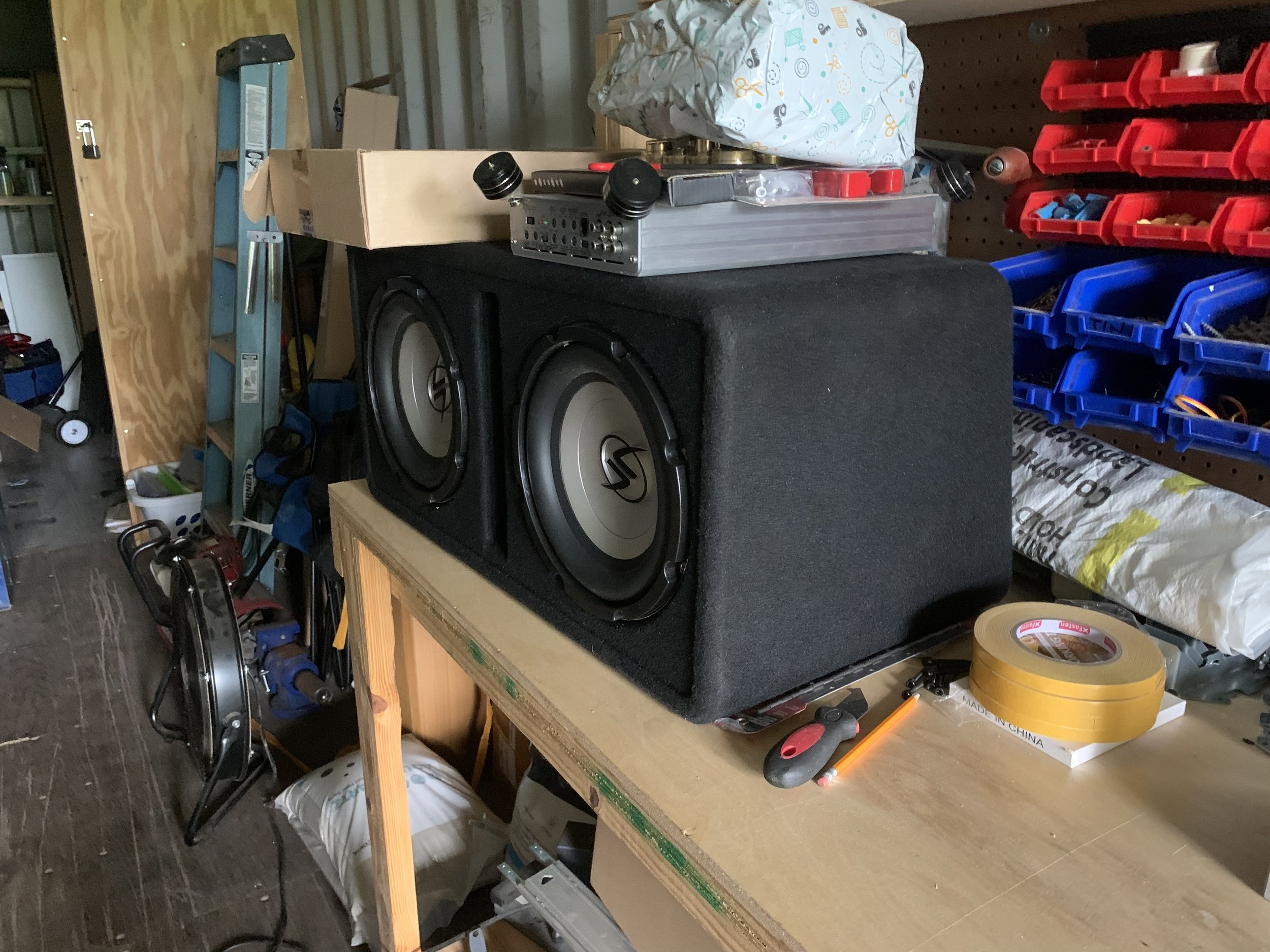

i think i still have another wiring kit(0 gauge) somewhere in my shop. will have to get some more to redo my big 3 from 4 gauge to 0 gauge. if i have to i could go to a dual 12 sealed enclosure to make it fit. i did like the dual 12's they had, but will have to make sure they will fit. i was going to see if i could hide all of it behind a beauty panel, so that its all clean though.

i swapped the speakers from the ported kicker box to the sealed box in order to save on some trunk space, but we're in the middle of a crap load of rain and i cant get out to work on the car. i found the 0 gauge wiring kit but went ahead and ordered another so i have enough wire to re-do the big 3 again. i looked for some performance batteries but the only one i could find that would fit in the sentra is an optima.. i know someone somewhere has a performance battery for sentras, just havnt found em yet. i looked at the websites you suggested and found their alternators but they all seem to not make one for the sentra, atleast not my year(2015).
