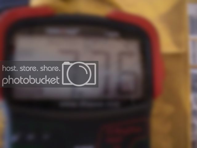

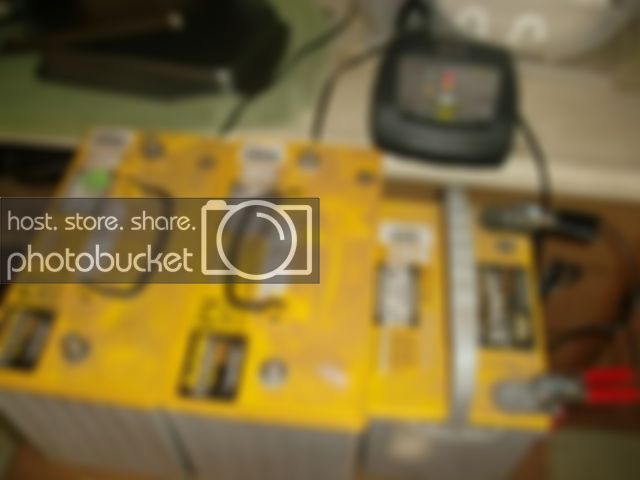

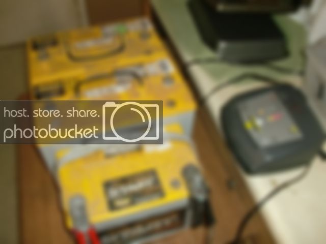

pulled all three batts and brought them in, charger is on the starter batt, it kicks in for a few mins, then off for a few, I'll keep checking with the DMM...hope I'm getting somewhere!

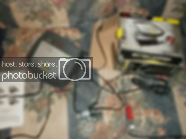

so theres a little trick to getting completyely discharged AGMs to start taking a charge. The charger has 2 ways of shutting off, sometimes as soon as it starts charging the cooling fan gets louder and louder till it clicks and stops charging for a bit..then it kicks back in for a while and shuts off again, other times it thinks/says the battery has a full charge then you have to disconnect then reconnect until it kicks off again, process repeat. Once the battery gets a small charge then the process stops or becomes much less frequent and then it takes over a day to get over a 12V charge. So far I brought 1 battery back to life, the 2nd large 100aH is now starting to take charge...hasn't kicked off for a while. Tomorrow I will try to get the little starter battery going again.
