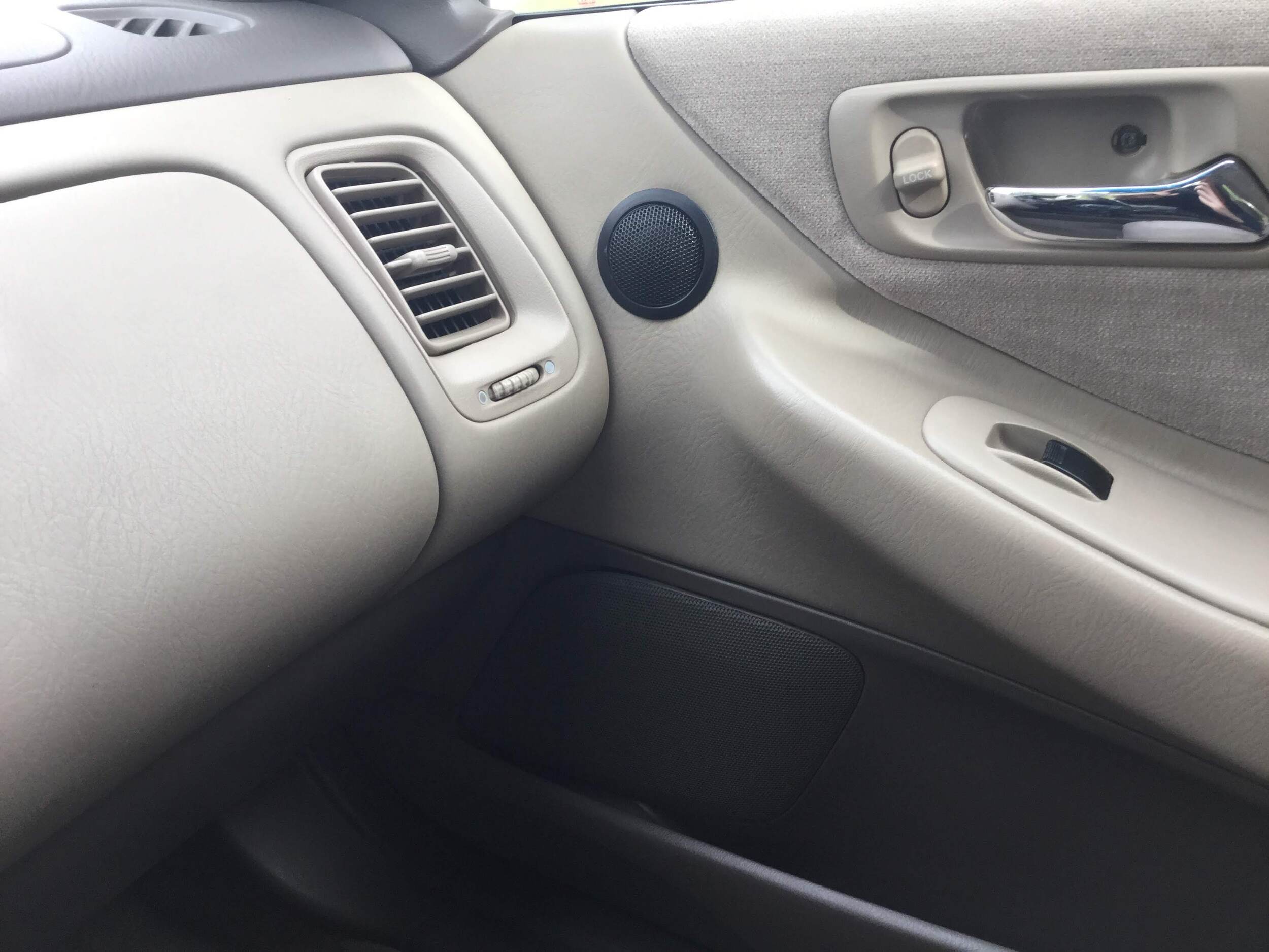

i have an Accord, put mine here, so my knees dont block them and theyre as close to the mid as i could get them. mids right below them in the stock location. sounds really good but my deck has time correction
