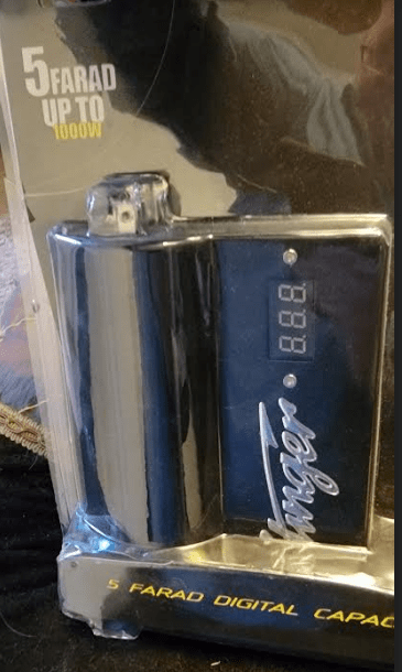

As for a capacitor, the rule use to be 1 farad for every 1000 watts. That was back when caps were high quality. I would recommend a 5 farad Stinger cap. Also, if you plan of bumping pretty hard, I recommend upping your alternator by 150 amps.

I've got a 5 Farad stinger cap, $100 shipped! Was going to list it this week sometime.

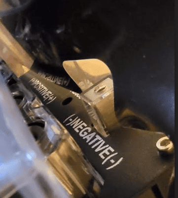

Yeah, it shows a picture of the 4 way remote but is is actually a single, larger remote out, same location, just a single versus 4 port connector on the remote only. Just ran out of room under my grandsons car seat, amplifier 2was only 800 watts, not like it was needed anyway. More for grandpa the grandson... ;)
