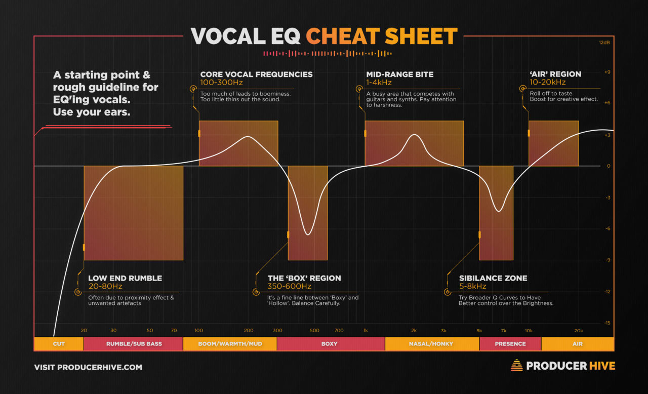

That's bad azz bro, thanks for the starting curve, I will try it out. And that was a very good read, i was in depth in some Damore stuff when I saw this lol.

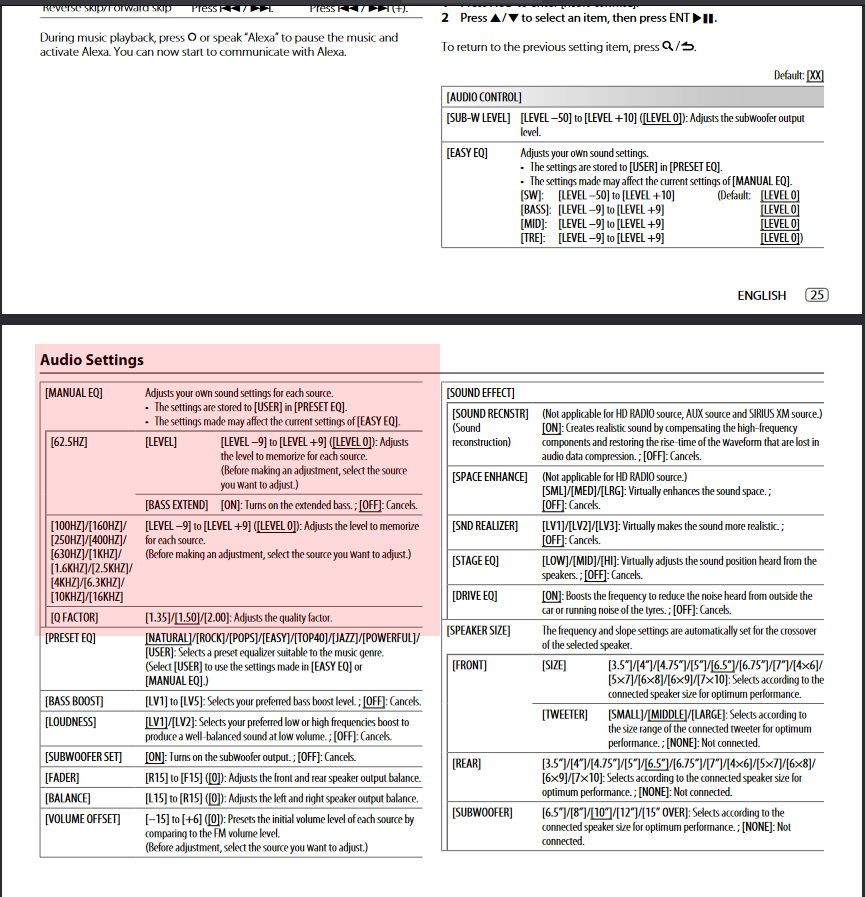

The information I gave is because I am familiar with Kenwoods Eq's in their head units. I use them myself. Adjusting the EQ as I suggested will make it obvious what frequency range he is in when adjustments begin. I didn't post any pictures or beginning settings purposely as mimicking someone else's curve is not a good idea. I don't know what power he has, speakers he has, car...
Here, this is from the X705's manual.
